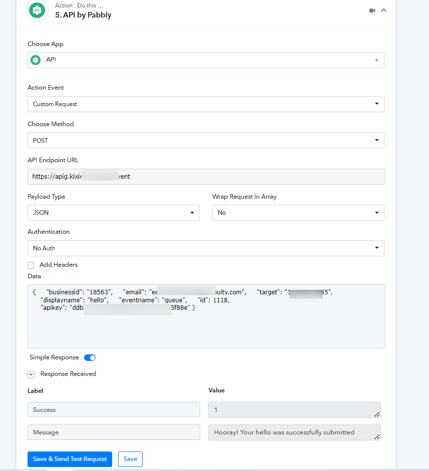

Here is what I got from the vendor and they are very little help with trying to troubleshoot anything outside of zapier. How do I format this within the pabbly API module to get this to work?
Make a call to queue (use JSON):
POST - URL: https://apig.kixie.com/app/event
"businessid": "18563",
"email": "[email hidden]",
"target": "14245012025",
"displayname": "hello",
"eventname": "queue",
"id":1118,
"apikey": "ddb37ea768d9d8dca66491178685f88"
Hey @mschellinger
We have made some changes in the API by Pabbly action step where we have changed the request to "Custom Request" and it is working fine.
Please pass the values correctly and try at your end. I hope this might help you out.

Hey @mschellinger
Thanks for this, we connected the initial trigger to be a change from pipedrive and for some reason it is posting the same request about every minute instead of just once. Any insight as to why or more importantly how to fix?
