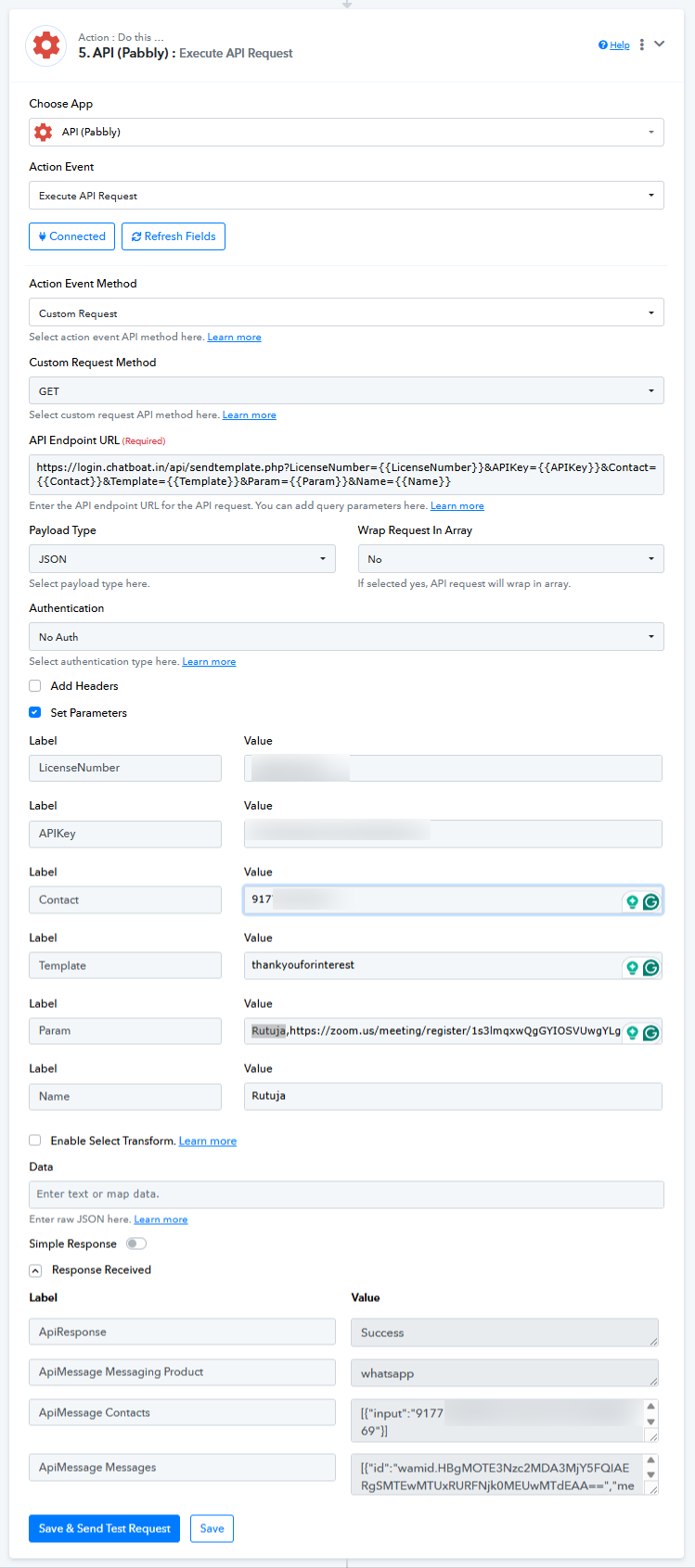

Hey @rushabhshah and @Bolstart,
As discussed over the call, we’ve set up the API (Pabbly) action in your workflow to execute the chatbot API until the native integration goes live. It is working fine as tested during the call.
We recommend mapping the required fields in this action and using it to send WhatsApp messages for now. Let us know if you face any issues.
rushabhshah — Reply ·
Thanks this works.
