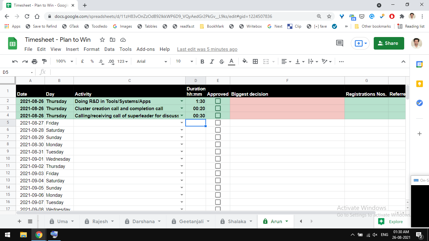

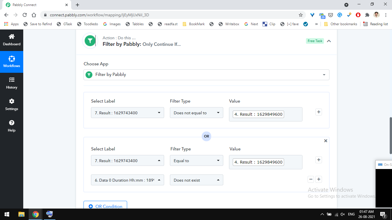

I am developing timesheet for my team, here is it's screenshot. My team are supposed to fill up the time they have worked daily in it.
Through Pabbly connect I want to send a reminder mail at 11:30pm IST to those who have not filled their timesheet.
i.e.
  1. If today's date is not listed in the spreadsheet date (column A) send a reminder mail or
  2. If today's date is equal to spreadsheet date (column A) but duration (column D) is empty send a reminder mail
I am stuck here.
I don't know if I am doing things right? Please help me, I understand that for loop is not required when iterator is used.
But I don't want to send email against every record matching in the sheet, I want to send one email per day.
How to I do it? Please help ?
- Arun

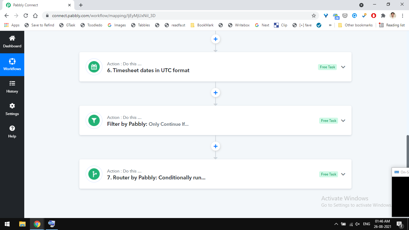

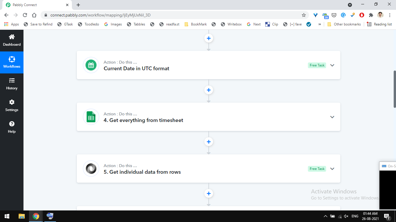

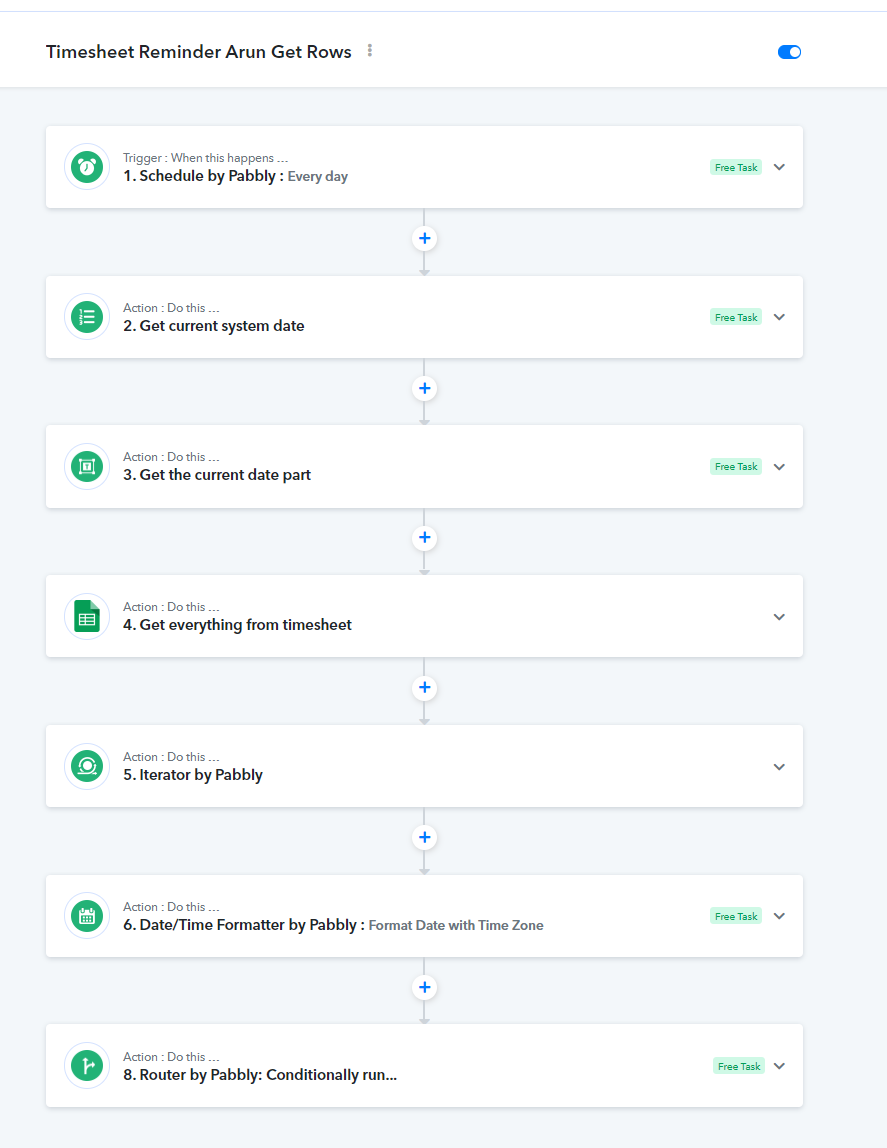

Hey @arunkw
We have made some changes in your workflow and in the filter condition according to your use case. Please check your workflow - (Timesheet Reminder Arun Get Rows ) and give it a try and let us know if that works for you.
Thanks!!
arunkw — Reply ·

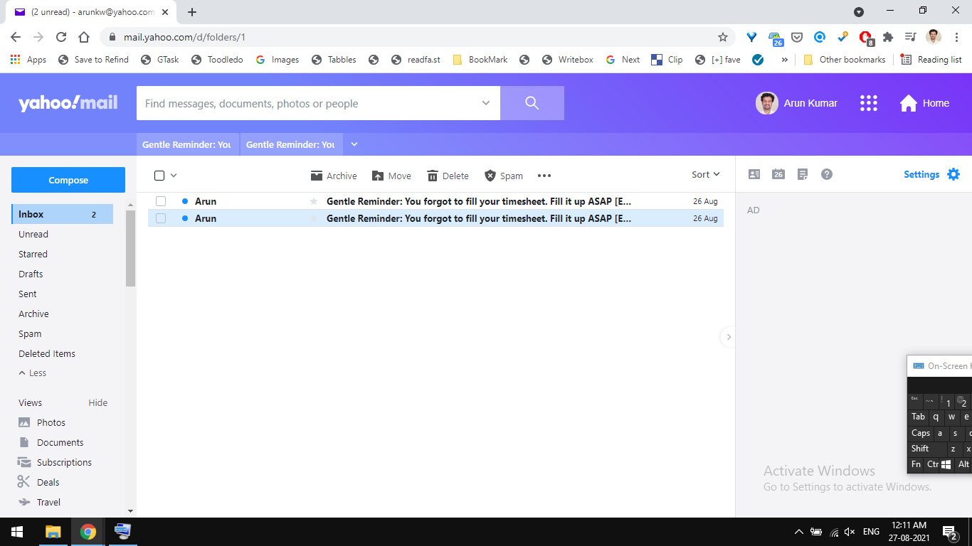

I got two email, I was expecting just one

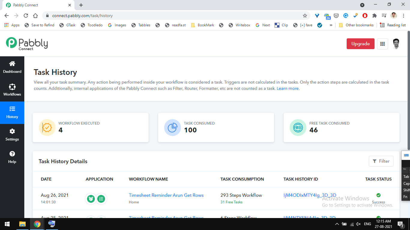

Consumption of 31 Free tasks it too high, how can it be reduced.
Hey @arunkw
We cross-checked your respective workflow and it is working according to your use case. Although you need to map the email id in the Gmail action step inside the router condition accordingly.
Further, the task consumption is according to the steps which are used and only Google's Get Row and Gmail action step is counted for each entry present in your workflow. Though we have reset all your tasks for your further trials and to test your conditions.
arunkw — Reply ·
Hey bro @Supreme Verma - Thank you for resetting the tasks for me.
I got two emails again, you did not get my use case, to give clarity here is what I am looking for
sendmail = true
For loop i=1 to last rows
If current.date = date.in.cell then
sendmail = false
Exit for loop
else
endif
End for loop
If sendmail = true then
shoot email once
else
endif
If this provision is not yet in pabbly connect, kindly ask your dev team to take this on priority.
I would love to see it incorporated asap.
if you need help and support from me say for testing, improvement suggestions etc. you can reach out to me.
We have made some changes based on your requirement and created another workflow name as "CLONE - [Timesheet Reminder Arun Get Rows]".
Please check this workflow and test it. You will receive the email notification once.
