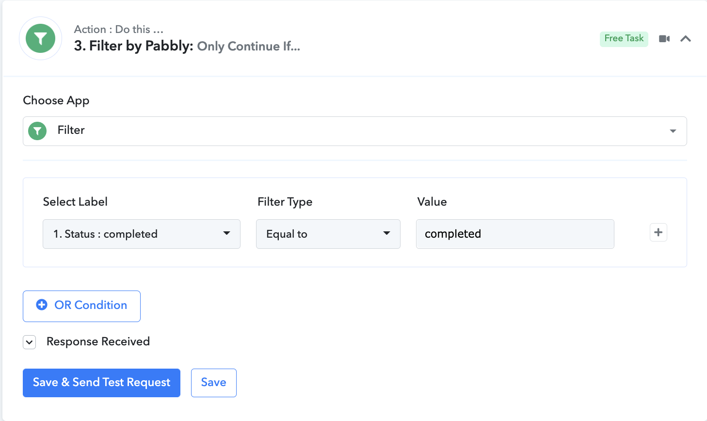

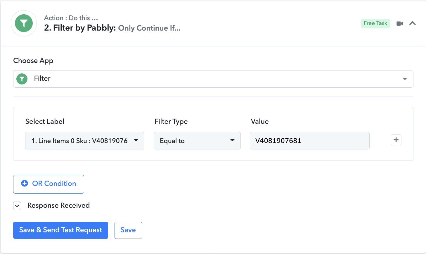

I created a workflow that is supposed to trigger upon a WooCommerce order update.
I have 2 filters on the flow:
1. only choose orders with a certain SKU number
2. only choose orders whose status changes to "completed"

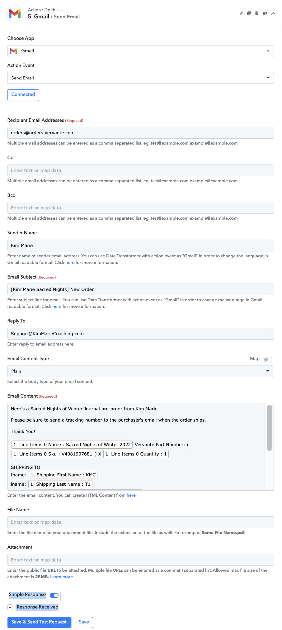

The final task is to send an email with order data to a printer who prints my item and ships it.
I tested the order emailing to my own email, and got it. I just tried to test with emailing the printer and am waiting to hear back. However, I also have the flow turned on, and tested changing an order from processing status to completed status, and nothing is showing as having been activated. i.e. no email has been sent.

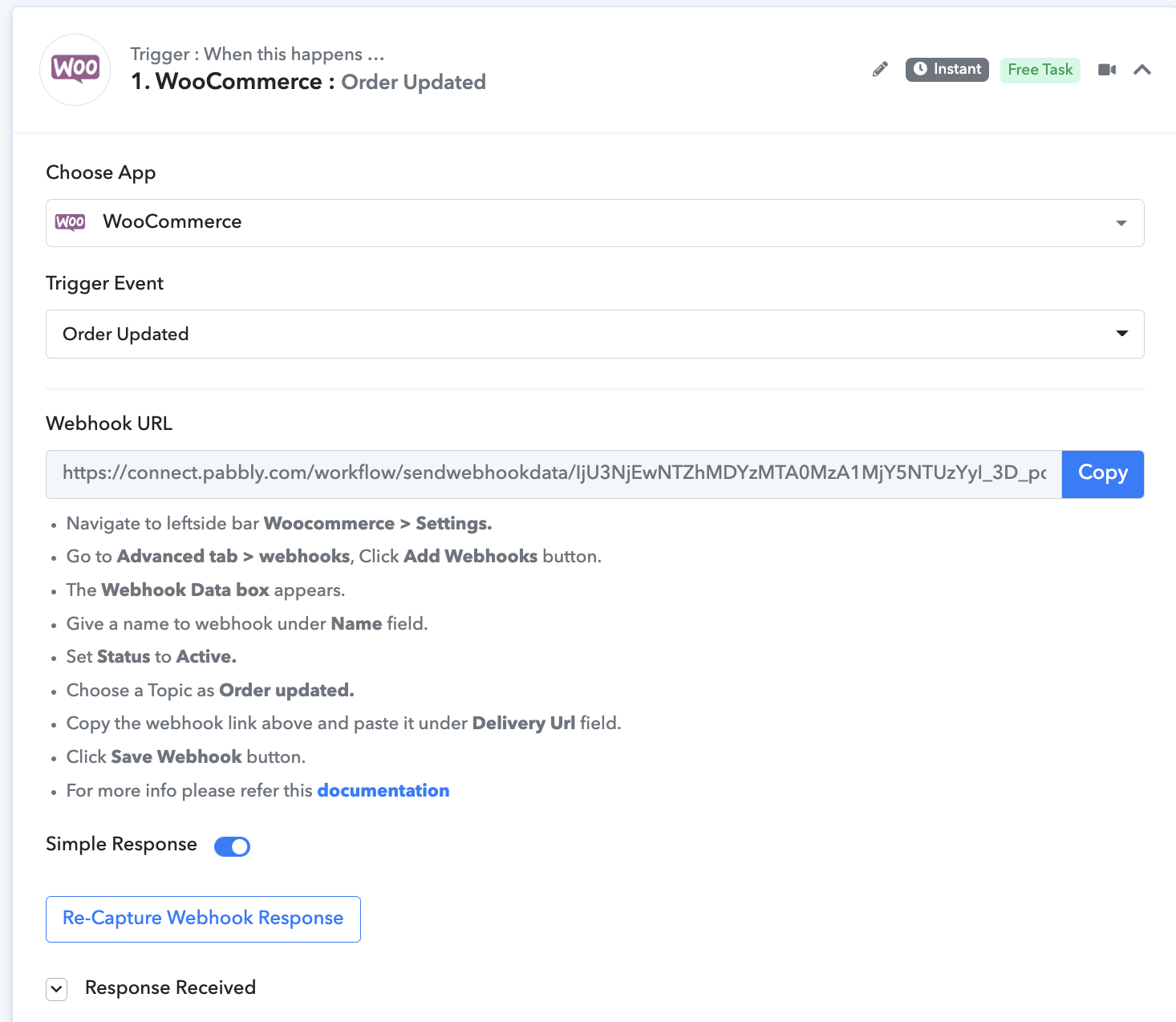

The web hook is setup properly as far as I can see as well, which is why the testing a month ago worked fine.

Above are screen shots of my workflow. I got confirmation that the email went through to the other party when I clicked the "Save and Send Test Request" button.

Hey @KimM
As we can see from your account your workflow seems fine, so could you please try recapturing the webhook response again?
Perhaps your Webhook URL for the WooCommerce trigger event is not intacted correctly. So, kindly try once and let us know.

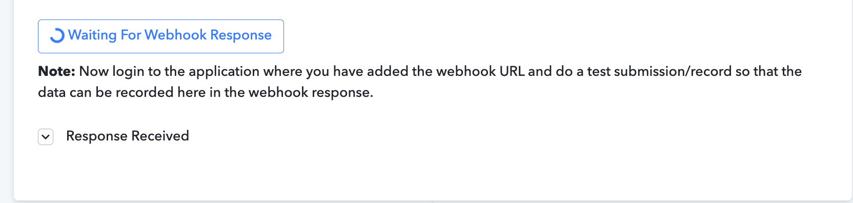

I tried to recapture the webhook, but the wheel just keeps spinning. The fact that it was captured before when I set this up, but isn't working now is clearly the issue.

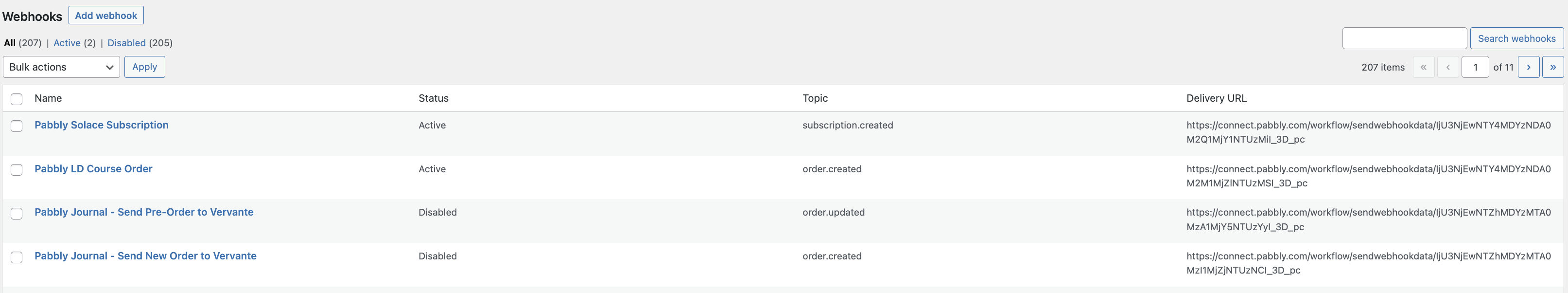

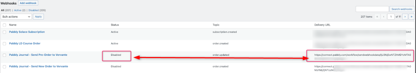

I'm attaching a screen shot of where I've set it up in WooCommerce. I don't get why it worked when I first set this up and tested it, and isn't working now with the new test. I went into an existing WooCommerce order that was marked with the Processing status, and changed the status to Completed after clicking the option to recapture the webhook response, but nothing happened. I'm attaching the image of the spinning wheel on the recapture button also.

Hey @KimM
If you can see your screenshot of WooCommerce, you can clearly see that you have disabled the webhook URL which is associated with your Update Order workflow.
So, kindly make it active and try accordingly.
KimM
Thank you so much. I didn't realize it had been deactivated, and wasn't even looking for something like that. All seems to be working now. Thanks!
