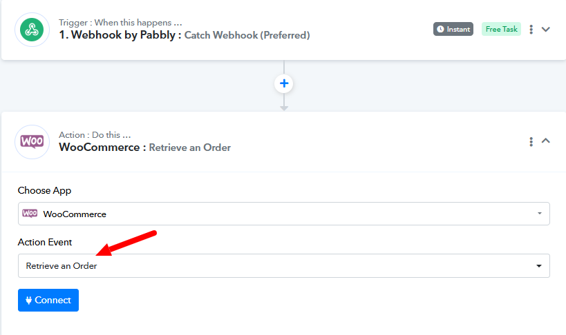

Can you try Retrieve Order action as 2nd step of workflow to see if that fetches the UTM data or not

@Fagun Shah Could you explain more in depth? How can I do that? What do I put 1st step of workflow?
Hello @Pedro Vieira
You can leave the trigger step as it is and add the "WooCommerce: Retrieve an Order" action to check if it contains the required UTM fields in its response.
