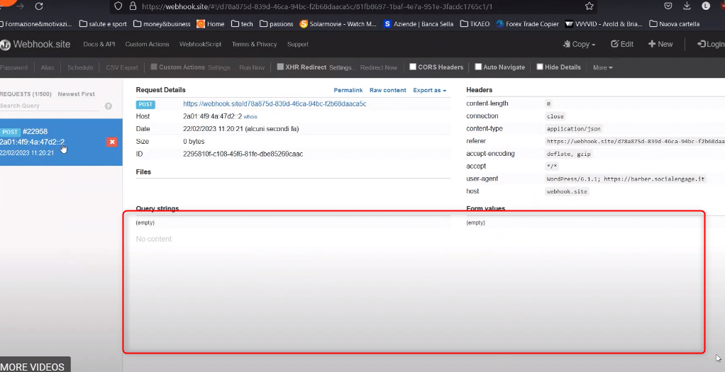

Can you please try the same scenario using webhook.site and let me know if you are able to receive the notifications?
https://webhook.site/#!/8612840f-0b38-4ff6-b604-a3bd63d2acd2
thanks you for your reply.
Yes it works with Webhook.site, Please find here the video of how I did setup the action fire to call pally connect webhook in my B site.
youtube.com/watch?v=v19hrBoEg6I
Thank you so much for any hint

Indeed we have checked and the same in Webhook.site but in your video, there is no data that came from the application from where you are trying to fetch.
So, please check from there triggering the application once and then try again.
