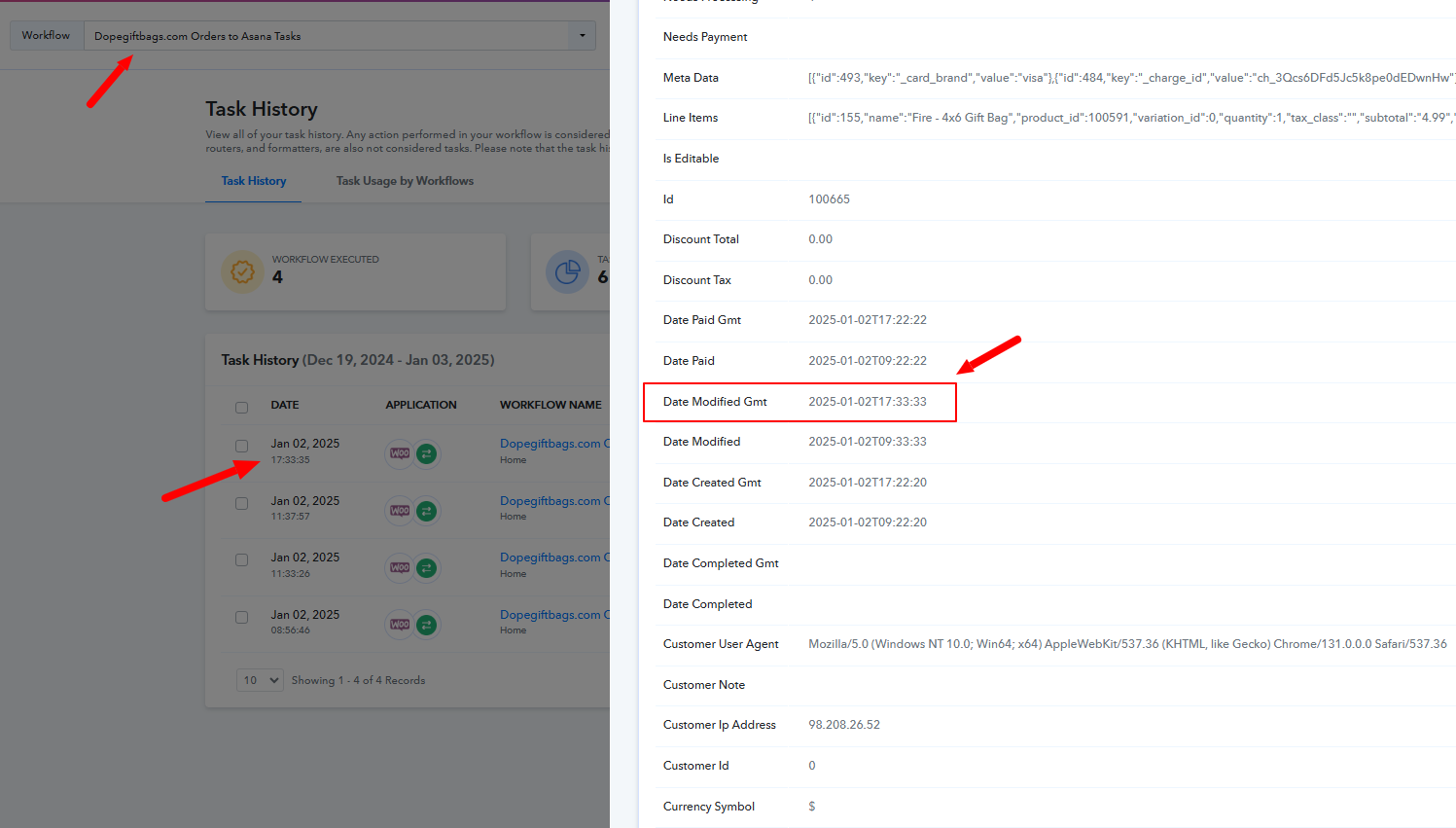

Hello @petepell,
Please note that the trigger you are using is a descriptive webhook-based trigger. The responses sent by the application (WooCommerce) are captured under the webhook response as soon as they are sent. This process typically takes only a few seconds.
However, upon reviewing the task history, it appears that the responses are being sent based on the modified date and time by WooCommerce. Kindly refer to the attached image for more details.

Hello @petepell,
It seems there may be some confusion regarding my last response. I just want to let you know that the trigger you are using is a description-based webhook. Our webhook is simply installed in the trigger application (WooCommerce), and the responses are sent directly by WooCommerce. We do not have control over how or when the responses are sent.
Upon investigation, we found that WooCommerce sends responses based on the modified time of the order, not the created time.
I hope this clears up any confusion. Please let us know if you have further questions!
petepell — Reply ·
Ok that makes sense, I've set the timezones for both Wordpress and Pabbly to my correct timzone. Let's see if that helps. I'm not sure where you got the image on the right from or how I access that so this is all I can think of to fix the issue.

Thanks ArshilAhmad, after setting both time zones in WordPress and Pabbly correctly, the trigger seems to be firing correctly now.
