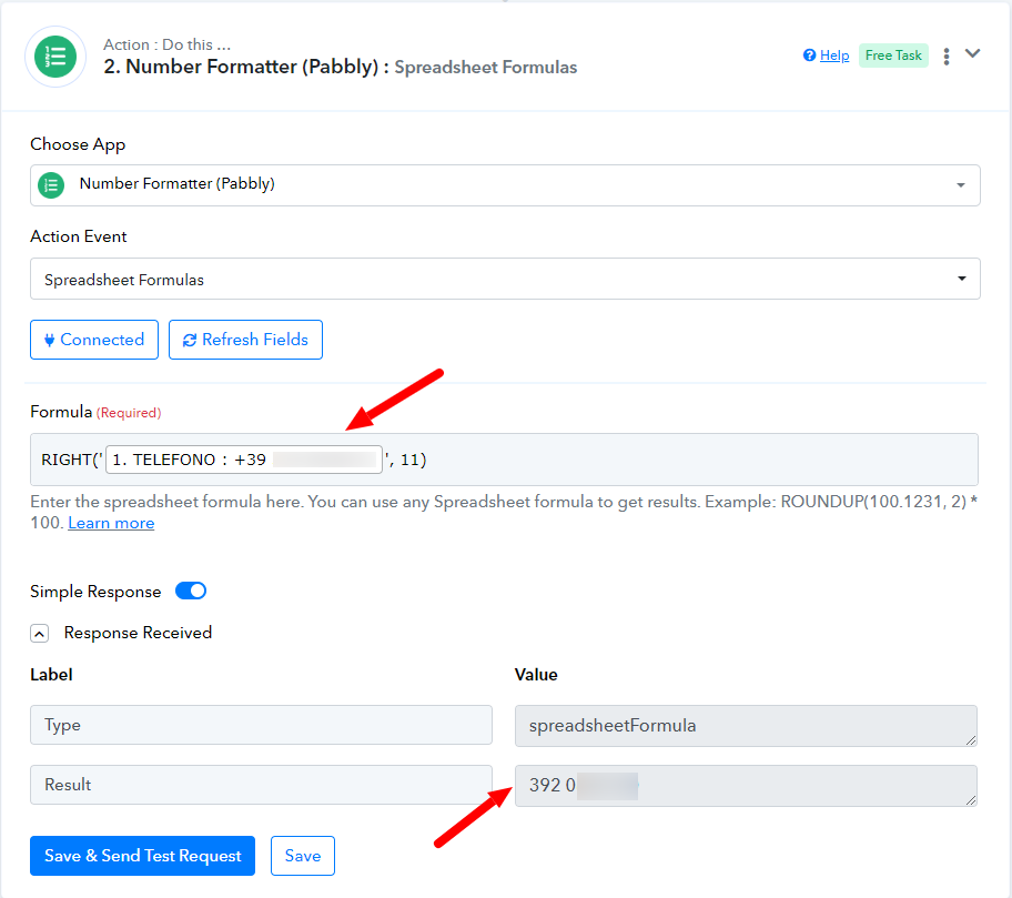

Hello @saroosh7,
You can add a Number Formatter action step to your workflow and use the Spreadsheet Formula called RIGHT to extract the last nine digits of the number, removing the country code.
Refer to the attached image for more details. While adding this step, replace 11 with 9 to ensure you get the correct number format.
Let us know if you need any further assistance!

Hello @saroosh7,
The formula will work for numbers that do not contain a country code, as it extracts the last nine digits of the number. However, if your number contains spaces, you can use the Replace Text action to remove them first. Once the spaces are removed, you can map the response from that step to the previously suggested step.
Refer to the attached image for more details. Let us know if you need any further assistance!
