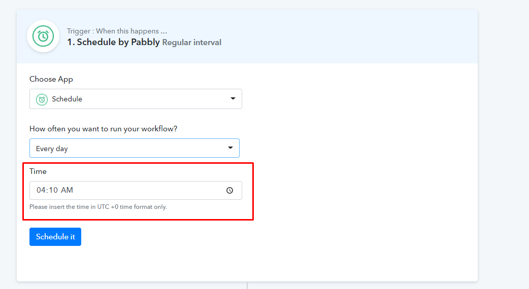

In some of my workflow I am using schedule to run the workflow at at specific time. Let's suppose I have scheduled the same for p.m. but this workflow is running in wrong time. I know there is some mistake at my end. I don't know what time setting should be because I am not able to see the AM and PM option while choosing the time. Can you please help me with this?
Example:
want to run the workflow everyday at pm.
what I should do?
My Time setting (I am in india)
Pabbly tkes time in UTC+0 format, use this link to convert Indian Time to UTC+0 - https://savvytime.com/converter/utc-to-ist
And here is how to add time to scheduler example,
