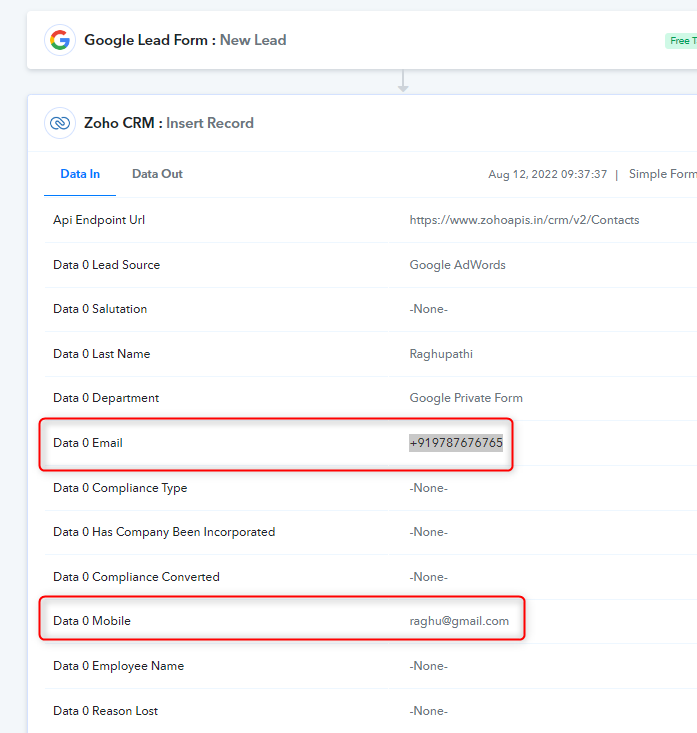

Hi @rajesh0612
We checked the latest task from your workflow and found that you might have interchanged the form's email and phone numbers fields. That's the reason you are getting Invalid_data as error message in the workflow.
Kindly update the datafields correctly in the Google form and then again pass the correct data from it.

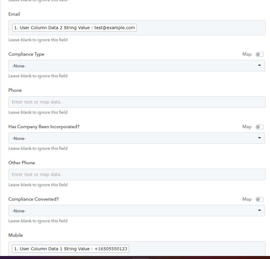

rajesh0612 — Reply ·
I have used correctly can check here
PabblyMember4 — Reply ·
Hi @rajesh0612
Please check the form again, this data is coming from the Google form to Zoho CRM. Wrong data is coming from the Google form. Kindly check and let us know.
