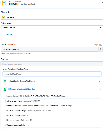

I then want to send some information worked out in the google sheet back to High Level Update Contact.
The problem is that all the detailed data is not showing up from the Goggle Sheet?
eg l cant put specific data into High Level from Updated Row in Google Sheet?

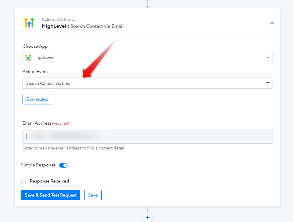

Could you please tell us whether you want to update the GHL contact from your Google Sheet action step or from the trigger response?
However, you can use the "Search Contact" action step if you want to retrieve additional data from your GHL.

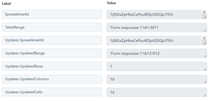

Thanks l want to update the GHL Contact from the previous data Google Sheet Information detail as it only shows summay info in the mapping as per below??
I would like to see detailed spreadsheet info eg; actual email, phone number, or the 16 columns, of the updateed row so l can add to GHL Contact
I would like to see the individual Values from Column A to T including 4 cells that are upated with values once the row is updated.

The Google Sheets: Add New Row action step will not show the same response that you are already updating from the trigger response.
If you want to update the same data you can directly map the data from the trigger response instead of the Google Sheets action step.
Moreover, if you want to retrieve the same row data, you can use the "Lookup Value" action step.
You can refer to the following video tutorial for the same.
