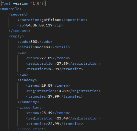

In an API step where I get prices for domains, I am expecting a result in the format:

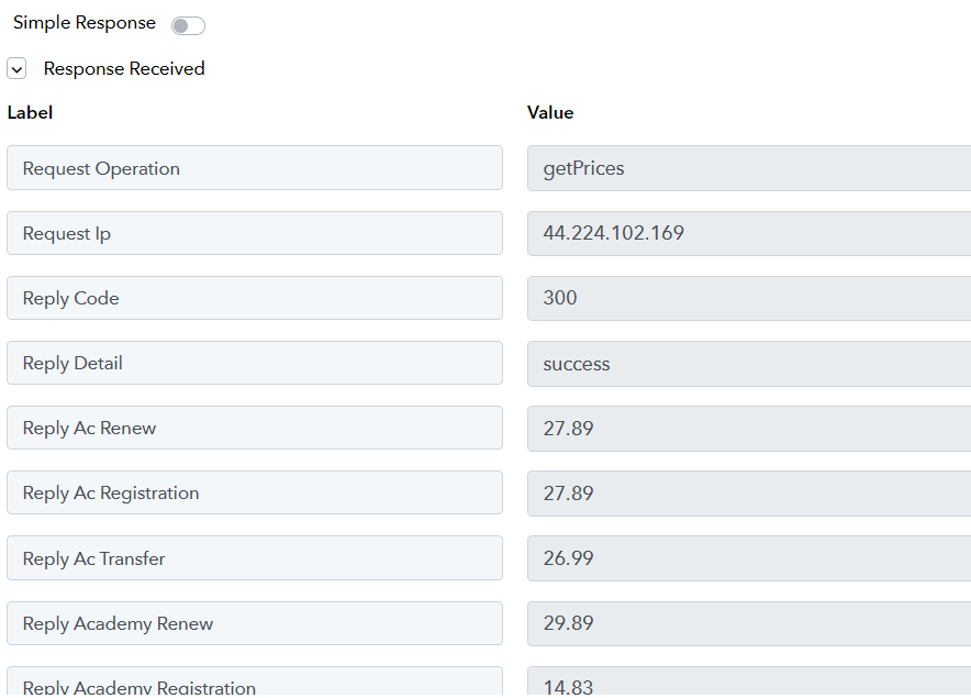

I have simple response DISABLED and I'm expecting a JSON result so that I can iterate through it and filter out just the TLD I want (let's say .net) in this case.
However, I'm getting a SIMPLE response back, formatted by Pabbly.
Any clues as to why?

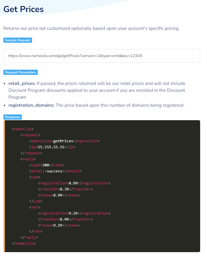

https://www.namesilo.com/api-reference#account/get-prices is the link in case you want to try.

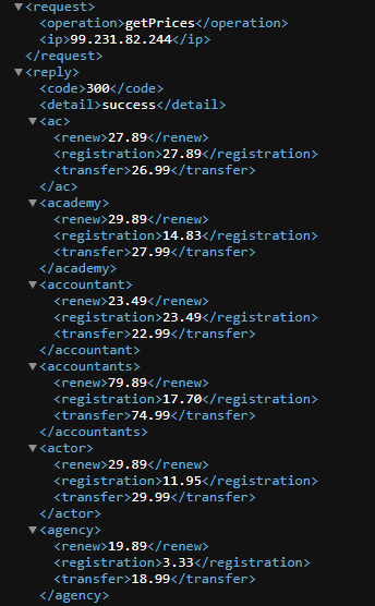

Could you please record and share a video with us showing how the responses appear in Postman?
Video available at https://tutorials.kitetech.ca/recordings/wexHPKZWYz2VGVXCmRCX
The results appear identical to screenshot above. See screenshot below for results from Postman

@thms, The XML response will always be in a key-value pair format as it is received that way from the API.
Thank you. Are there any suggestions you have to be able to run it through an iterator?
Without receiving the response in array format, the Iterator will not work. Unfortunately, I don't have any other solution.
