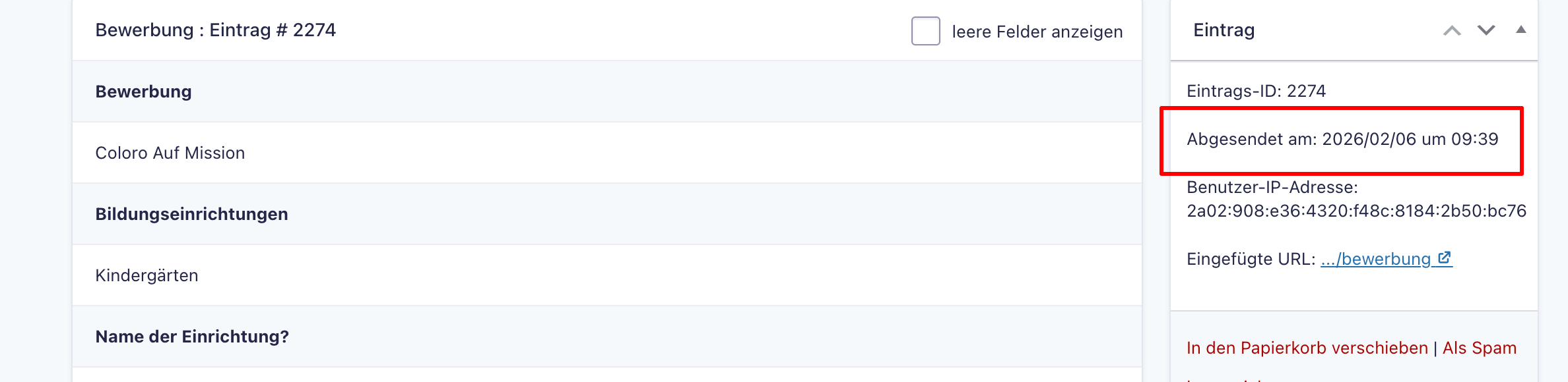

I’m having an issue where Gravity Forms should trigger a request to Pabbly after submission, but the request is not appearing in Pabbly. This has happened twice now (it happened previously as well). Can you help me understand why the request isn’t reaching Pabbly?
Bobby — Reply ·
see this date is in today not i did not showing any entry in pabbly in today why ?

Could you please share the screenshot again with the details in English, and also let us know if you are seeing any error message on the Gravity Forms side Additionally, please share the workflow URL where this webhook is connected so we can review it further.
Also, please note that we experienced a brief downtime today. If any webhook requests were sent during that period, they would have been queued in our system and should start executing automatically shortly.

Thank you for sharing the screenshot. Upon reviewing it, we can see that a timestamp is mentioned. Could you please confirm the time zone in which this time is recorded This will help us evaluate whether it falls within the downtime window we experienced.
We also recommend monitoring the workflow for some time to see if the execution gets captured, as webhook responses sent during the downtime may have been queued in our system and should execute shortly.

Thanks for your message. The timestamp shown in the screenshot is recorded in the Berlin, Germany time zone (Europe/Berlin) — i.e., CET (UTC+01:00) or CEST (UTC+02:00) depending on daylight saving time.
Pabbly Connect experienced downtime today between 12:38 PM IST and 03:17 PM IST. Since your webhook was supposed to trigger at 02:09 PM IST, you encountered this issue.

Please note that it can take some time for all the queued webhooks and poll-based data to get executed, depending on the volume in the queue. We request you to please wait for a while and continue monitoring the executions.
If you still notice that the queued executions are not triggering even after some time, kindly let us know, share the workflow URL, and we will be happy to look into it further.

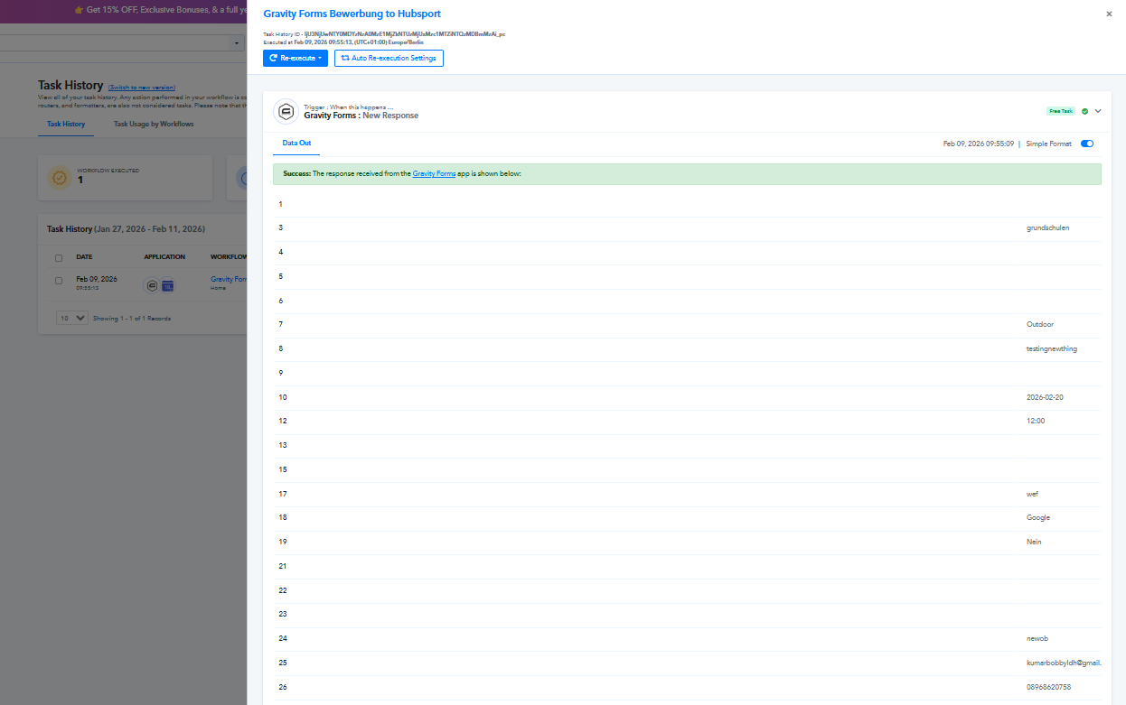

in pabbly Response its empty i did not received any data why this happen again and again

Hi @kumarbobbyldh,
Could you please confirm which specific step is returning an empty response
From our end, the trigger response appears to be captured correctly in the Task History. Kindly refer to the attached task screenshot for clarity.
Once you confirm the exact step, we’ll be able to assist you further.

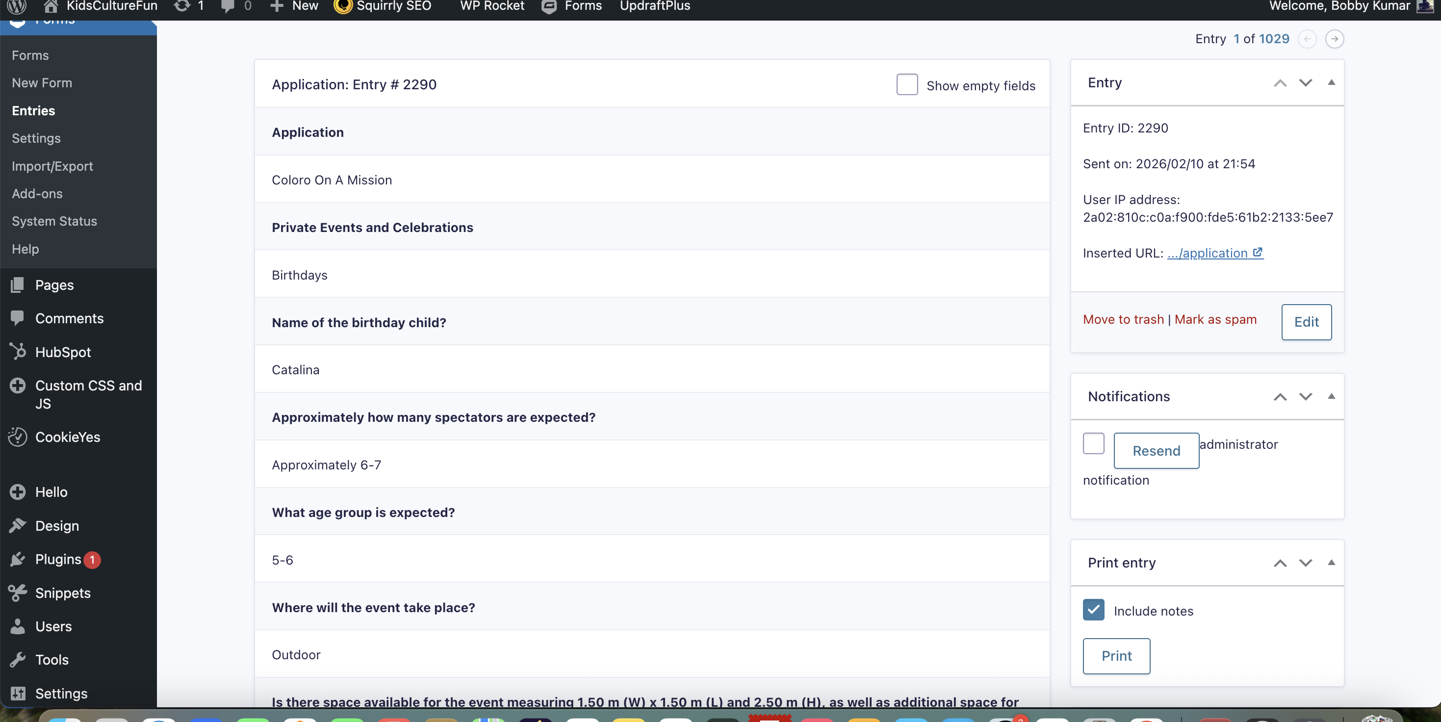

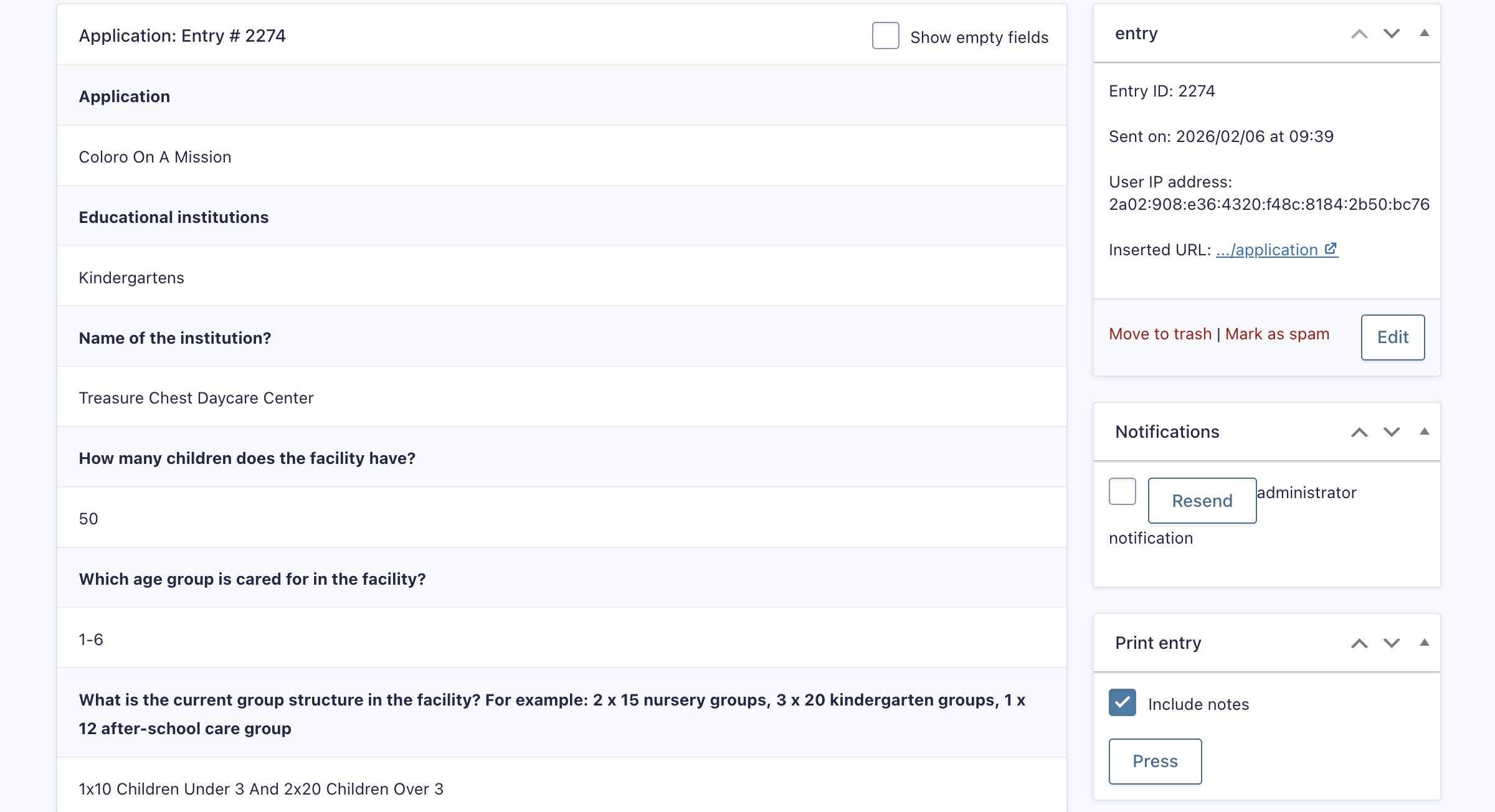

It doesn't always happen; it only happens sometimes here is a form entry its showing all data not in pabbly please see this issue i face to many time this problem

From our end, the Task History entries appear to be capturing the trigger data correctly. We are not able to see missing fields in the executions we checked.
Since you mentioned this happens only sometimes, could you please clarify:
  • What exact data is missing in Pabbly
  • Which specific field is empty
  • What difference are you noticing between the form entry and the captured trigger data
If possible, please share a short screen recording showing:
  1. The form submission
  2. The corresponding Task History entry
  3. The specific field that appears empty
This will help us compare both sides and identify what is causing the intermittent issue.
Looking forward to your details.

all from data is missing you can see on History entry. i show you 2 Task History entry
