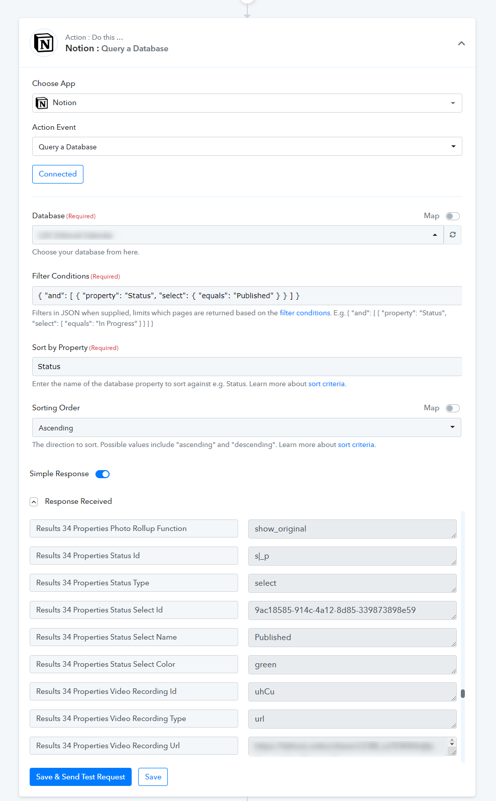

Please check now. It should be working now. Note that we simply wrote the filter condition again from our end and it worked out -
Good to know there is a workaround (what would the query be to match on a text field?), but I asked about the “search page” action which is still broken (not the “query database” action which you shared)

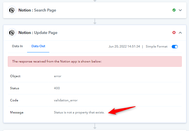

We checked your workflows and didn't find any issue related to the Notion: Search Page action in your Workflow LOC Rss >Social but, we got the issue in Notion: Update Page action.
We checked this action at our end it worked fine for us. Could you please try to re-execute it?
It should work.
I removed it because it wasn't working!
