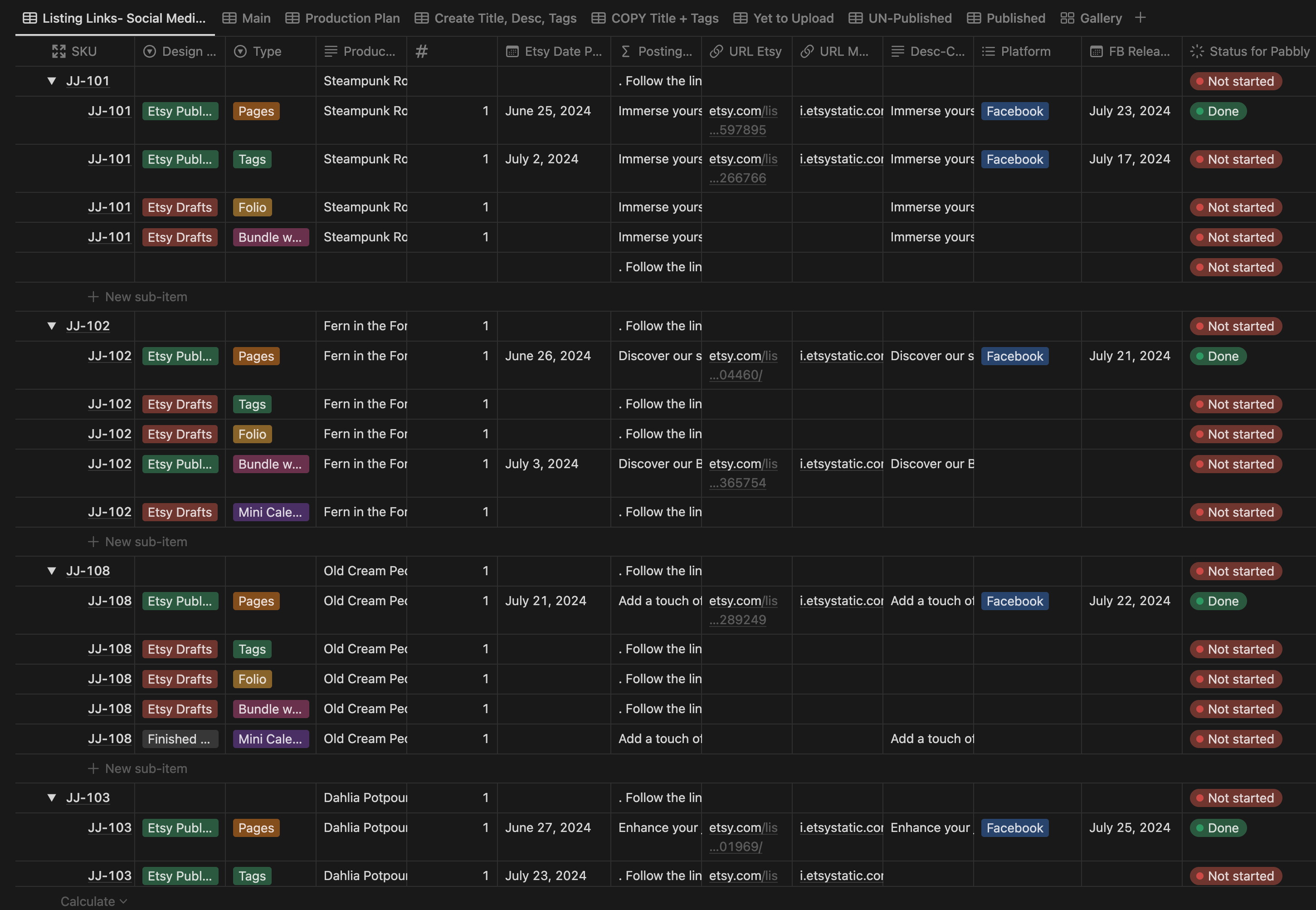

I have setup a Notion DB to FB according to the great Youtube. Finally I got it to work, but need to re-trigger some DB entries to so that they get posted to FB.
What I did:
I added a date and set the trigger to "done" as per video. As it did not work right away from the beginning, I have some past dates that were not considered and I want to re-trigger them. What is the correct way?
Do I simply set the trigger to something else than "done" and change the date and wait a bit (a day or so as I am on free plan right now) before I change to "done" again?
Am I correct that I can set several DB entries to done with a different date as one of the filters is set for a delay.
This is how the DB looks like and the important fields are the last 3 columns.
Thank you so much in advance.

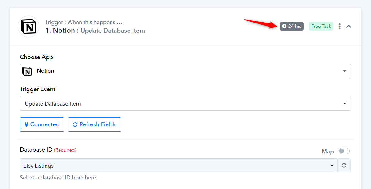

Notion has a trigger interval time of 24 hours. This means that any update made to an item in your Notion database may take up to 24 hours to trigger your workflow.
Yes, you can change it to something other than 'done' and then change it back to 'Done' to trigger your workflow.
