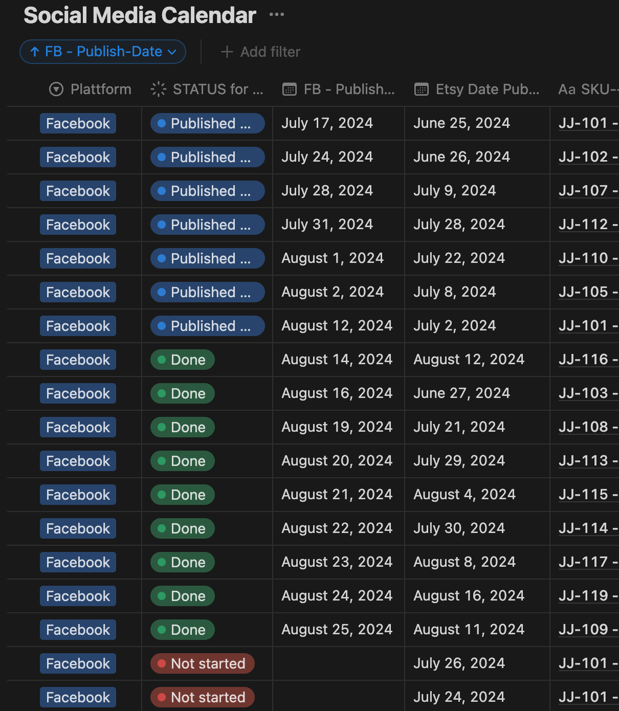

Now, I have re-written my database to make it easier for selecting the needed fields and formost easier to navigate for me.
Again, I followed all steps according the video, the final save-and-send-test-request worked fine.
This I did on August 16, I then added same dates to the database entries and set them to done. Now, even after 24hrs no new posting, BUT the workflow is consuming tasks.

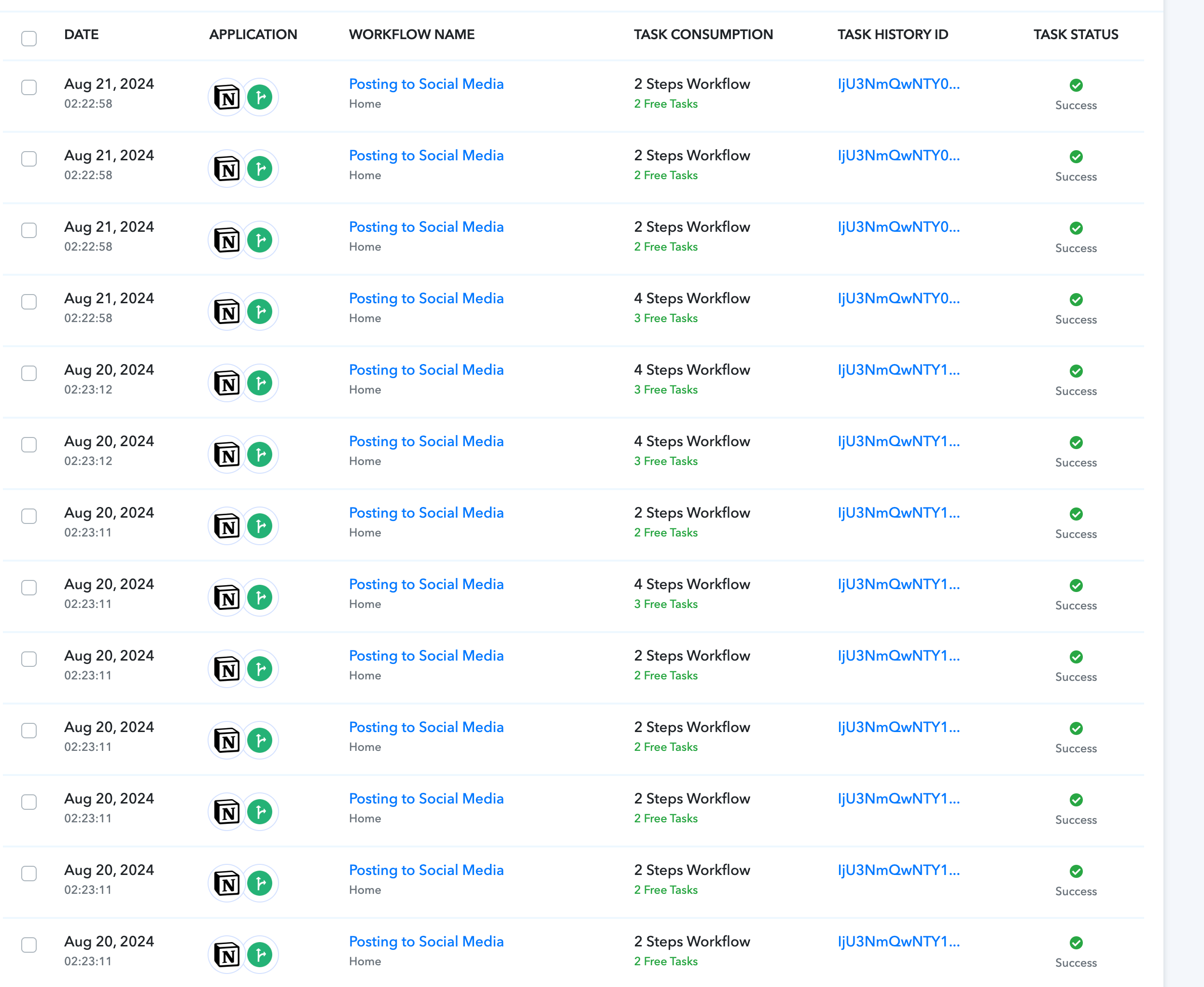

At least, something is happening since Aug 20. Please see screenshot. I do not know which task history you would need to check, but I'd be grateful for any help to get this running.

Hey @Supreme
This is the last one - the one on top of my screenshot in first posting.
This includes only 2 steps
IjU3NmQwNTY0MDYzNzA0Mzc1MjZhNTUzNTUxMzQ1MTYxNTQzMiI_3D_pc
(Executed at Aug 21, 2024 02:22:58, (UTC+02:00) Europe/Zurich)
and this is the forth down the list and includes 4 steps
IjU3NmQwNTY0MDYzNzA0Mzc1MjZhNTUzNTUxMzQ1MTYwNTQzOCI_3D_pc

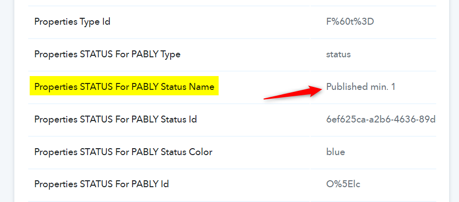

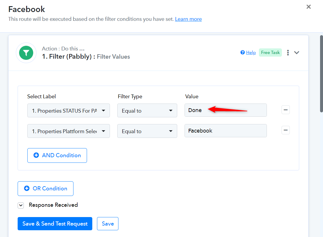

You have set up a filter condition in your router to execute the next steps only if the 'Properties STATUS for Pabbly Status Name' is equal to 'Done'.
Based on your task history, we can see that the response captured from Notion had a different status, which did not meet the filter conditions and therefore the next steps didn't get executed.

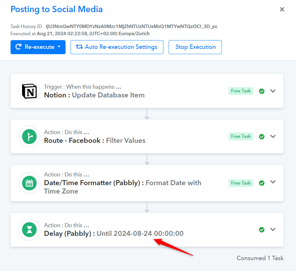

You have a Delay step in your workflow that will prevent this post from being made on Facebook until August 24th, 2024, at 12:00 AM UTC.

Thank you. The delay is not the problem. It is ok and is set according to the video.
Yes, the status captured from Notion is different than the set to done in the filter. BUT if the time moves forward it should have captured the ones marked with done. See for the dates of 19 and 20 August.

I am sorry for this bad wording. What I wanted to say is: When I change the status do done eg. on August 18 with publish date August 19 and then have August 22 ----> days after, that is what I meant with time moves forward.
