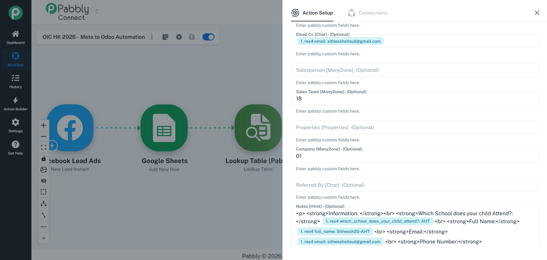

Issue 1: Odoo Sales Team and Company Fields
I am creating CRM records in Odoo and need to assign:
  • Sales Team
  • Company
During the Create Lead / Opportunity step, whenever I pass either:
  • The Odoo record ID (integer value)
  • The Sales Team name
  • The Company name
the action returns validation errors.

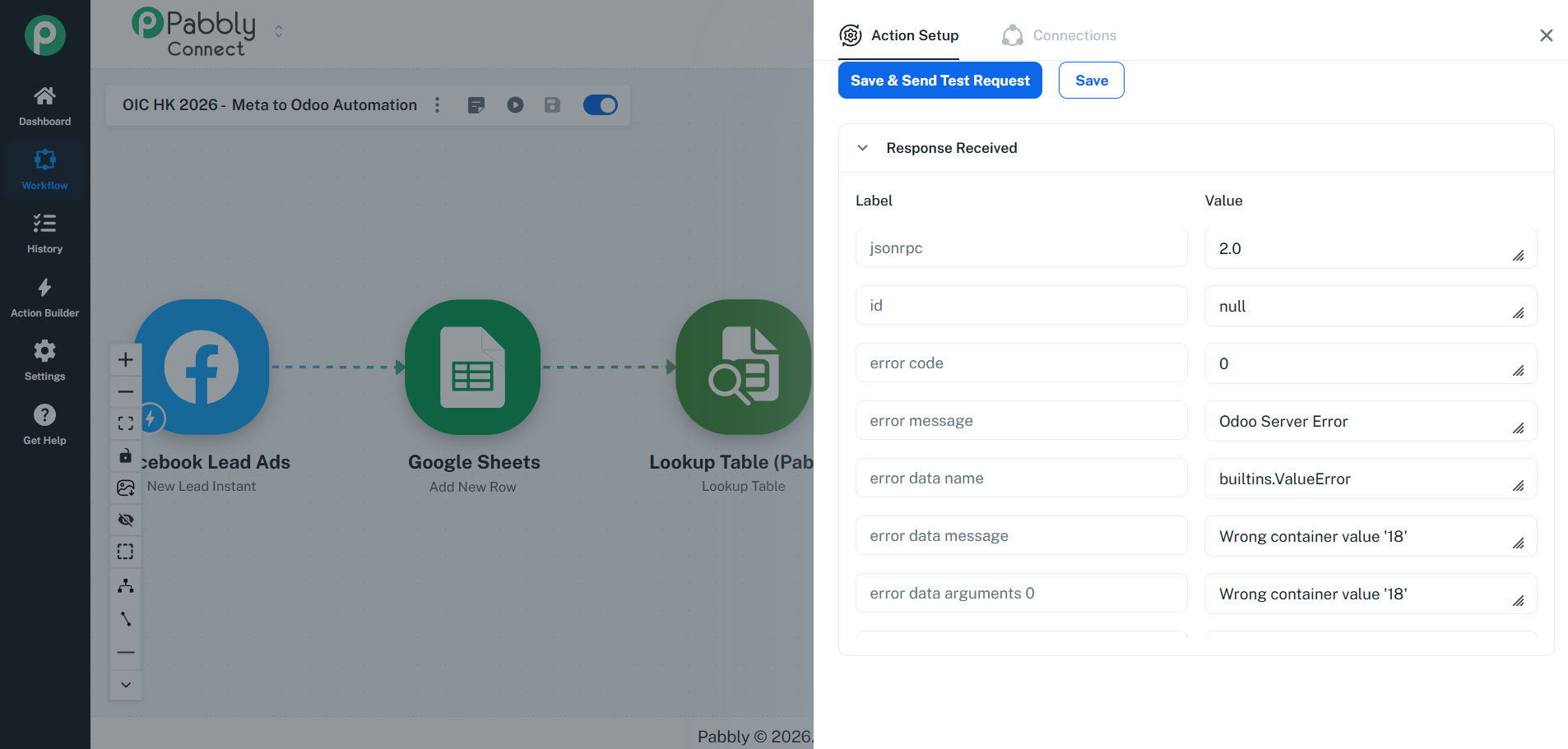

However, when I use the same values in an Update Record step:
  • Sometimes the step completes successfully.
  • Sometimes the field is not updated in Odoo.
  • Sometimes the step shows success, but when I open the detailed response, Odoo returns an internal error.

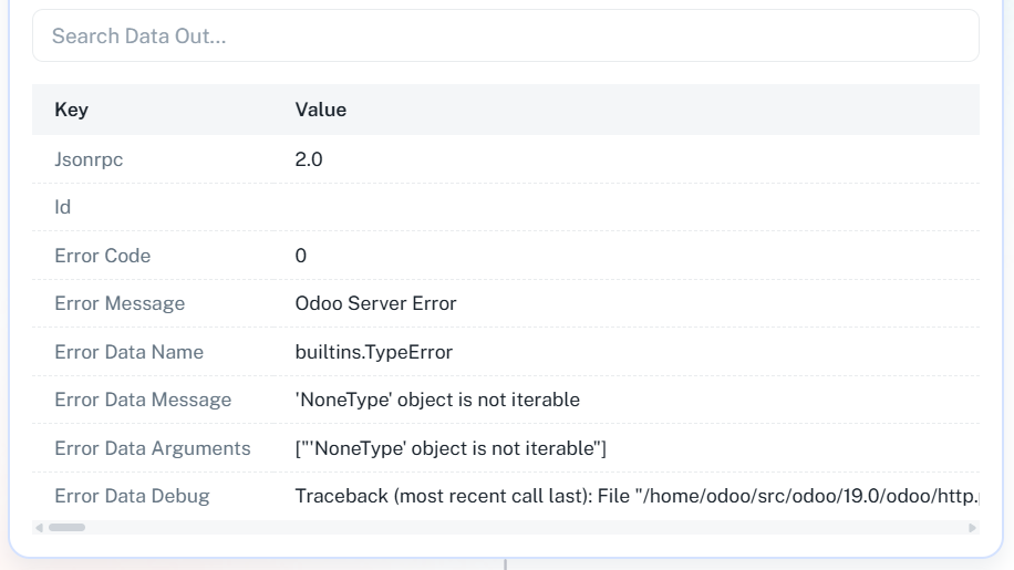

One of the errors returned by Odoo is:
Error Message:
Odoo Server Error
Error Data:
builtins.TypeError
'NoneType' object is not iterable
Screenshot attached below.

  1. What is the correct format expected by Odoo for:
    • Sales Team (team_id)
    • Company (company_id)
  2. Should these fields be sent as:
    • Integer ID
    • Record name
    • External ID
    • Another format
  3. Has anyone successfully assigned Sales Team and Company through the Odoo connector?
  4. Is there a known issue with Odoo Many2One fields in Pabbly Connect?

Regarding the error:
"Odoo Server Error - builtins.TypeError: 'NoneType' object is not iterable"
this appears to be an Odoo-side validation error. In most cases, such errors occur when the data passed to one of the mapped fields is not in the format expected by Odoo. Since the actions are working successfully at present, we are unable to identify the exact field that may have caused the issue earlier.
For the Sales Team (team_id) and Company (company_id) fields, you should pass the numeric Odoo record IDs. These IDs can be obtained directly from your Odoo account. Whether a field can be populated during record creation depends on the specific Odoo model and the fields supported by that record type.
At the moment, we are not aware of any known issues with Odoo Many2One fields in Pabbly Connect. If you encounter the error again, please share a task history where the error is visible so that we can investigate the exact cause.

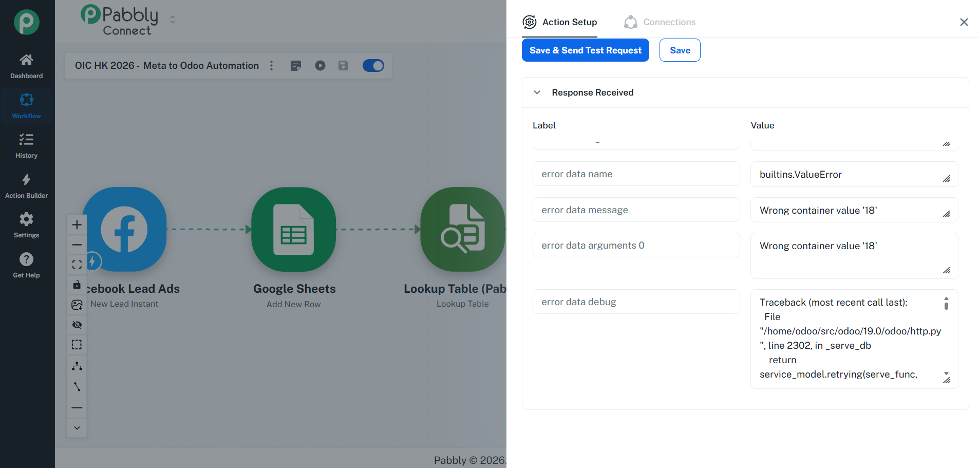

Regarding the Odoo issue, I understand that the recent tasks are executing successfully. However, the concern is that the same values being used in the Update Record action work correctly, while the Create Record action throws the error:
"builtins.TypeError: 'NoneType' object is not iterable"
Specifically, I tested both the numeric IDs and the field names for the Sales Team (team_id) and Company (company_id) fields, but the Create Record action continues to return the error. Since the values are valid and accepted during updates, could you please confirm whether there are any known limitations or formatting requirements for these fields specifically during record creation?

Hey @aniketnborhade,
Thank you for sharing the additional details.
Regarding the Odoo issue, we are not aware of any specific limitations with the Create Record action for these fields. Since the error originates from Odoo itself and the same values appear to work in the Update Record action, we will need a task history where the Create Record action is actively showing the error in order to investigate further.
