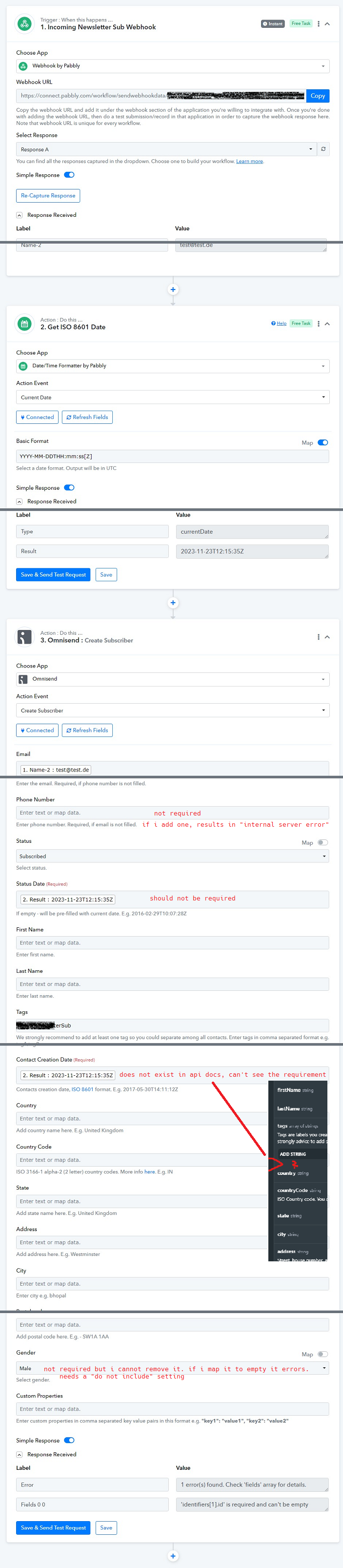

i have checked the forum and find a good amount of 500 errors but not mine. Also the integration seems to have changed in the past year, looking at the other screenshots here.
I am trying to create an omnisend contact, triggered by a persons subbing to our newsletter by providing the email address.
So i do have the email, which means i don't need a phone number. despite that i get "'identifiers[1].id' is required and can't be empty"
Looking at their api docs, that id should have been the email and type=email
which i provide
but since it asks for identifier[1] and not [0] i assume there is some issue with not providing phone?

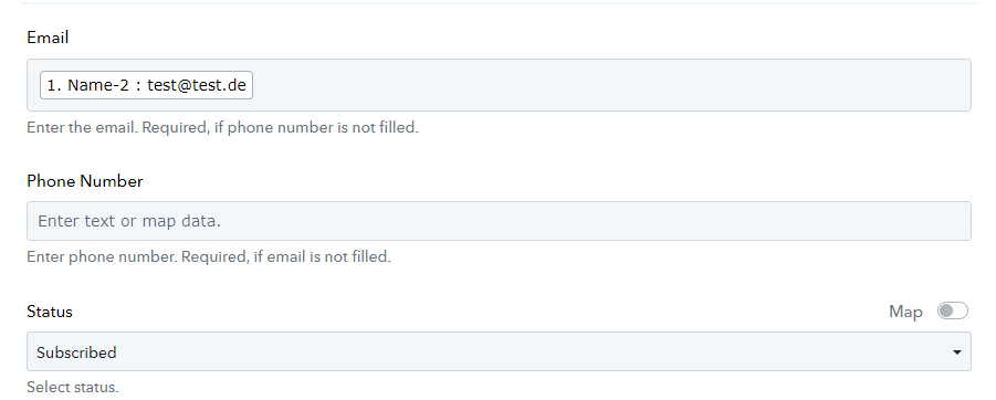

if i add a phone number i get
also missing the option to sub/unsub/nonsub individually for phone and email
also you have a Status Date and a Contact Creation Date, but only the first pre-fills if not provided.
So i added an extra step to get current iso 8601 date, would be nice to make this extra step obsolete.
Some help would be much appreciated.
cheers,
Vince

I don't have a phone number for this case. all i get is an email address from the web-form. as mentioned, if i add a phone number i get internal server error. and the integration should not need a phone number to begin with if email is provided.

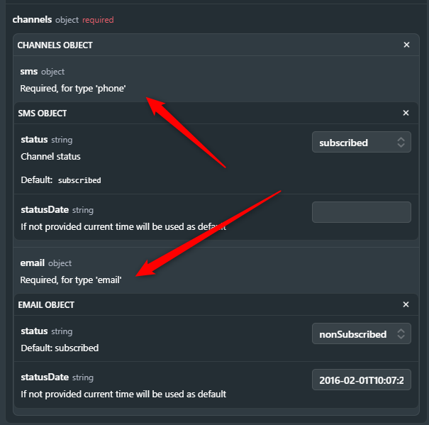

nope that is the channel subscription. you do need one set of instructions for each type (phone / email) you set up.
but you only need either phone or email for the contact, you _can_ have both. so if i omit phone, i don't need a phone channel setup.
i have omnisend contacts from the previous setup that only have email but they are still subscribed to phone and email channel.

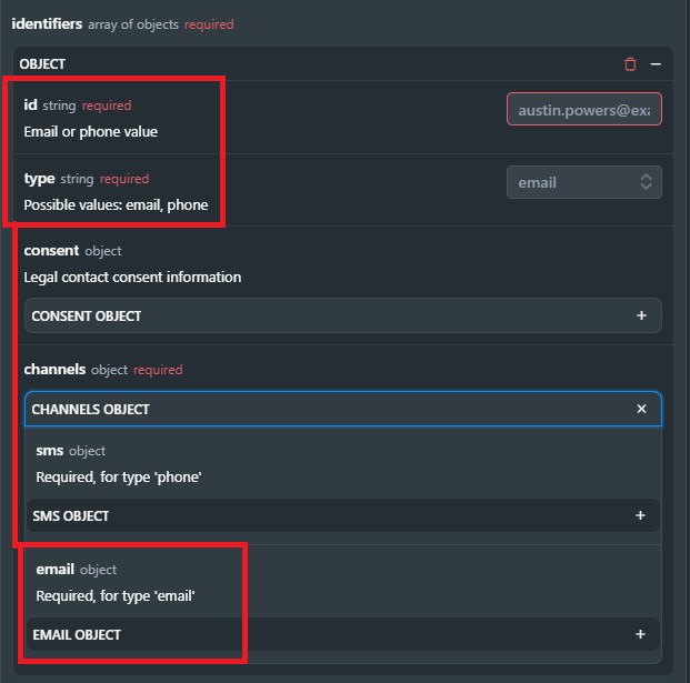

the error is identifiers[1]. i only have identifiers[0] unless that integration creates one for phone even if i don't need one.

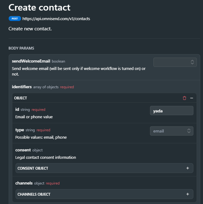

https://support.omnisend.com/en/articles/4237790-updating-your-contacts-profiles
Every contact added to Omnisend can have two types of identifiers - Email address and the Phone number. It will be sufficient to have an Email address or the Phone number to add a contact to Omnisend.
as you can see here, channels are part of the identifier. this example only needs _this one_ identifier set to email and then just the email channel.

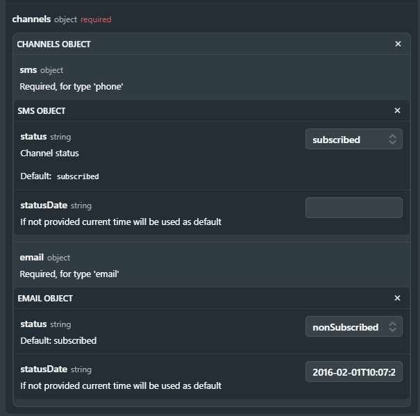

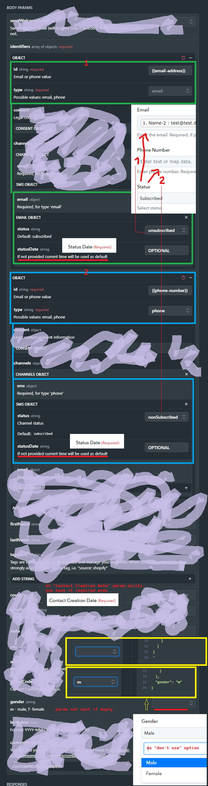

also the statusDate says required in pabbly connect, but api doc says "not really":
now i could just directly embed omnisend's subscribe form, but then i can't add any other magic later (such as triggering slack notifications etc).

- if i enter NO number, same error as before. a contact requires either phone or email, not both. so this is still a bug.
- subscription dropdown should be per id type (email and/or phone). i guess that this is causing invalid data when i don't provide a phone number.
- Contact Creation Date still says required, even though it is nowhere in the api documentation, not even as optional.
- Status Date is still required, even though api docs say "empty" is fine and will default to now().
- Gender is still set to default male and cannot be completely removed. this is optional and should not behave this way.
This is what the json needs to look like for the "identifiers" part to work (copied from api page, see below); the [1] block (here phone) should be completely removable:
"identifiers": [
"type": "email",
"id": "{{email-address}}",
"channels": {
"email": {
"status": "{{email-status}}",
"statusDate": "OPTIONAL"
"type": "phone",
"id": "{{phone-number}}",
"channels": {
"sms": {
"status": "{{phone-status}}",
This is the setup (removed surplus stuff):
as said above, the integration probably fills the phone sub status field from the one dropdown (that should have been two). thus it's bugging out with id ('id' => '{{phone}}') missing and works if you supply one. but i cannot just supply a random number. i need phone to not exist as api docs say it can.

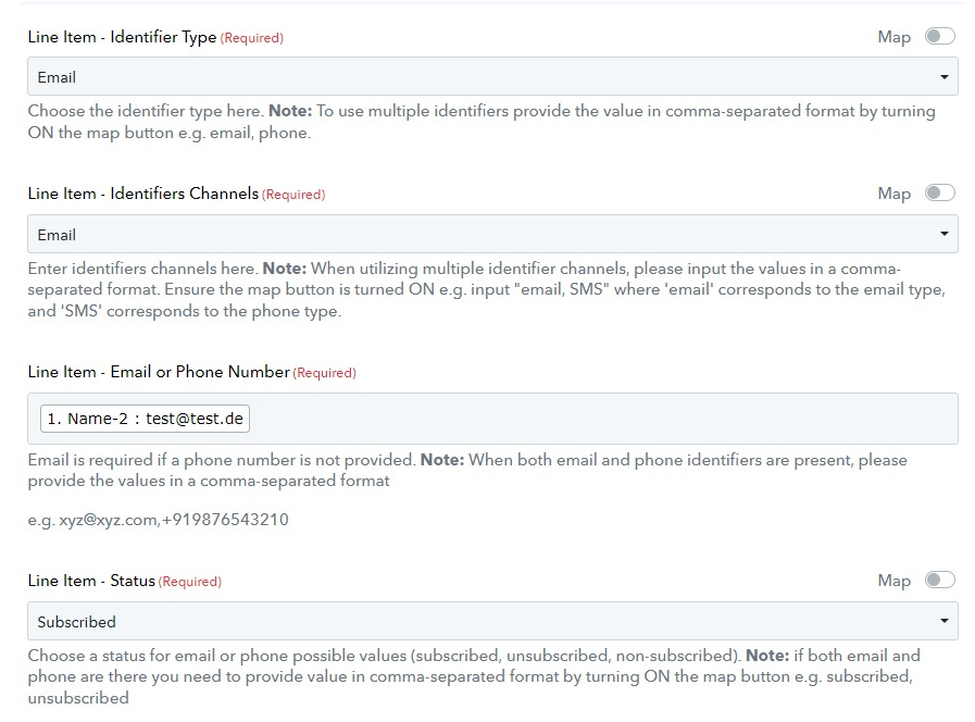

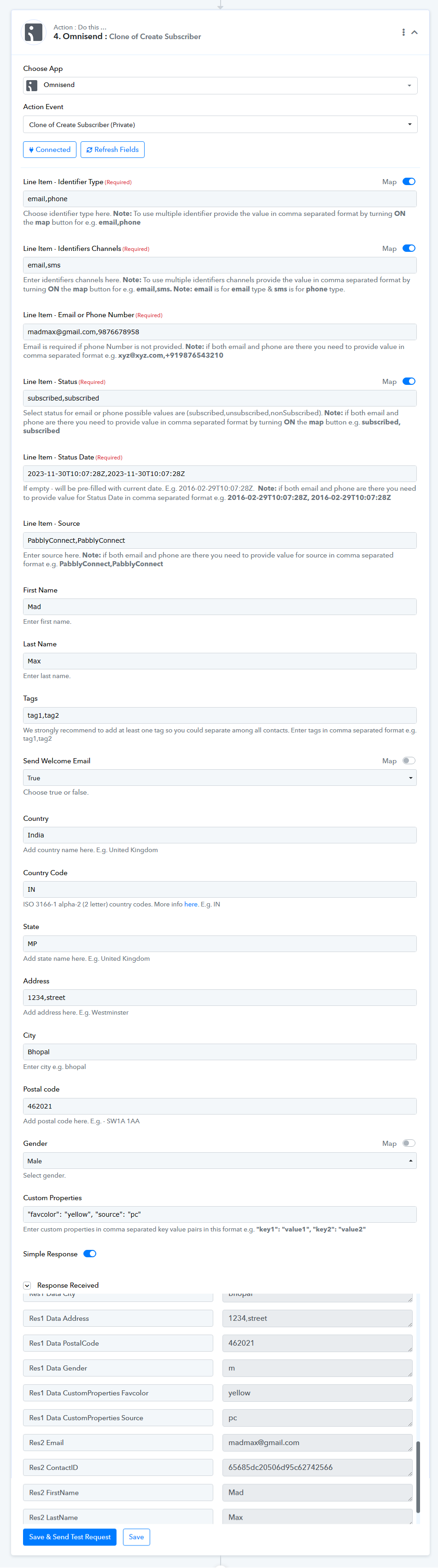

I tried my use-case with minimal data:

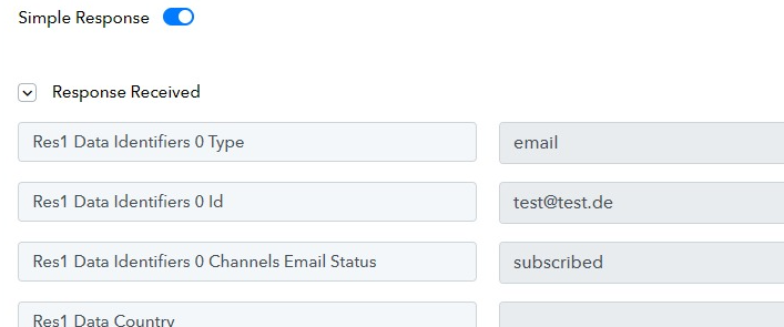

and it worked like a charm:
It is a pretty weird way omnisend is doing things, but you got it working. Great stuff!
