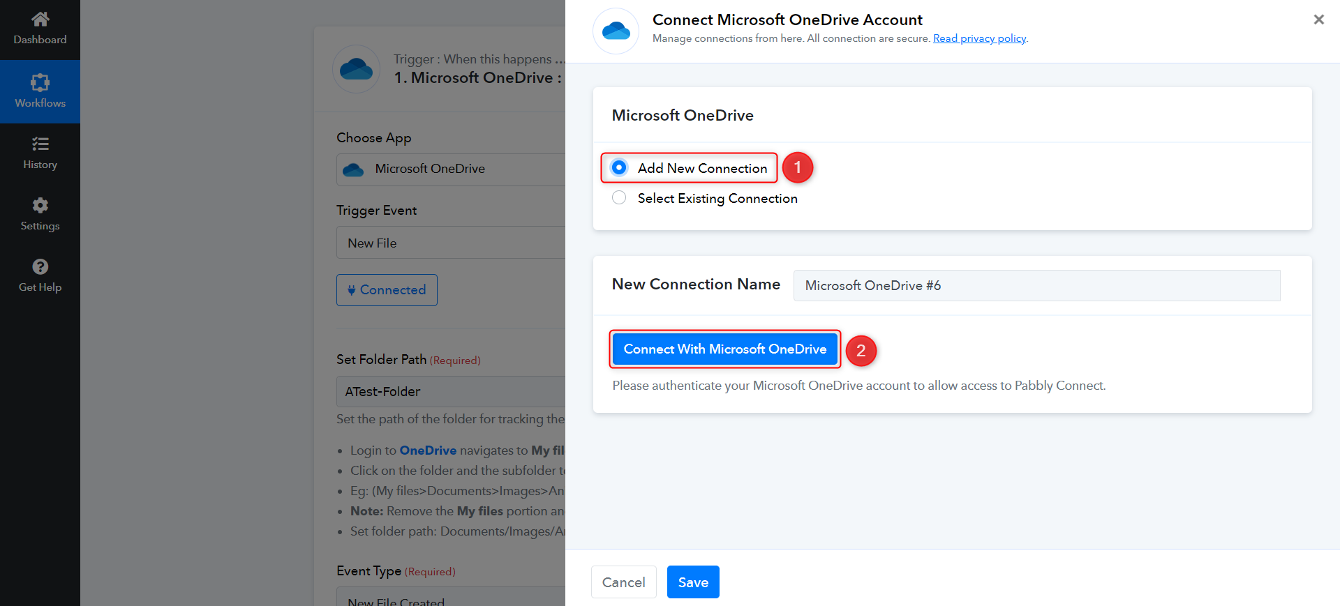

  1. The main problem is that the workflow only functions properly during the Test Run". When I authenticate my OneDrive with Pabbly and test the data, everything seems to be working perfectly as it fetches information from new files. However, automation is NOT working after 10 minutes or so, the system fails to perform correctly even after multiple attempts. Only one test is successful and if a file is added within 2-3 minutes, After that the workflow does not pick it up.
    Furthermore, when I attempt to re-run the test, it returns zero responses as per in the attached screenshot. Upon making several attempts, I've discovered that to successfully perform a "Test run", I must re-add my OneDrive account as a New connection (refer to the screenshot, where I've had to add the same account five times to complete the test run).
    I suspect the issue lies within the interaction between the OneDrive account and Pabbly's authentication session. It is working till the authentication session is True and works If a new file is added within a 2-3 minute window, everything works seamlessly, but beyond that, no success is achieved regardless of my efforts. I need to re-authenticate my same OneDrive account as New Connection to make Test Run successfully.
Could you please establish a new connection with your OneDrive account and set up your workflow by mapping the details again? We just need to check something. Once all the details are captured and mapped in the next steps of your workflow, and the setup is complete, do let me know.

Not only this workflow - OneDrive connections are not working with any of the workflows. I need to add my OneDrive account As a new connection to run the text run.
Please allow us some time to look into this. We will get back to you shortly.
