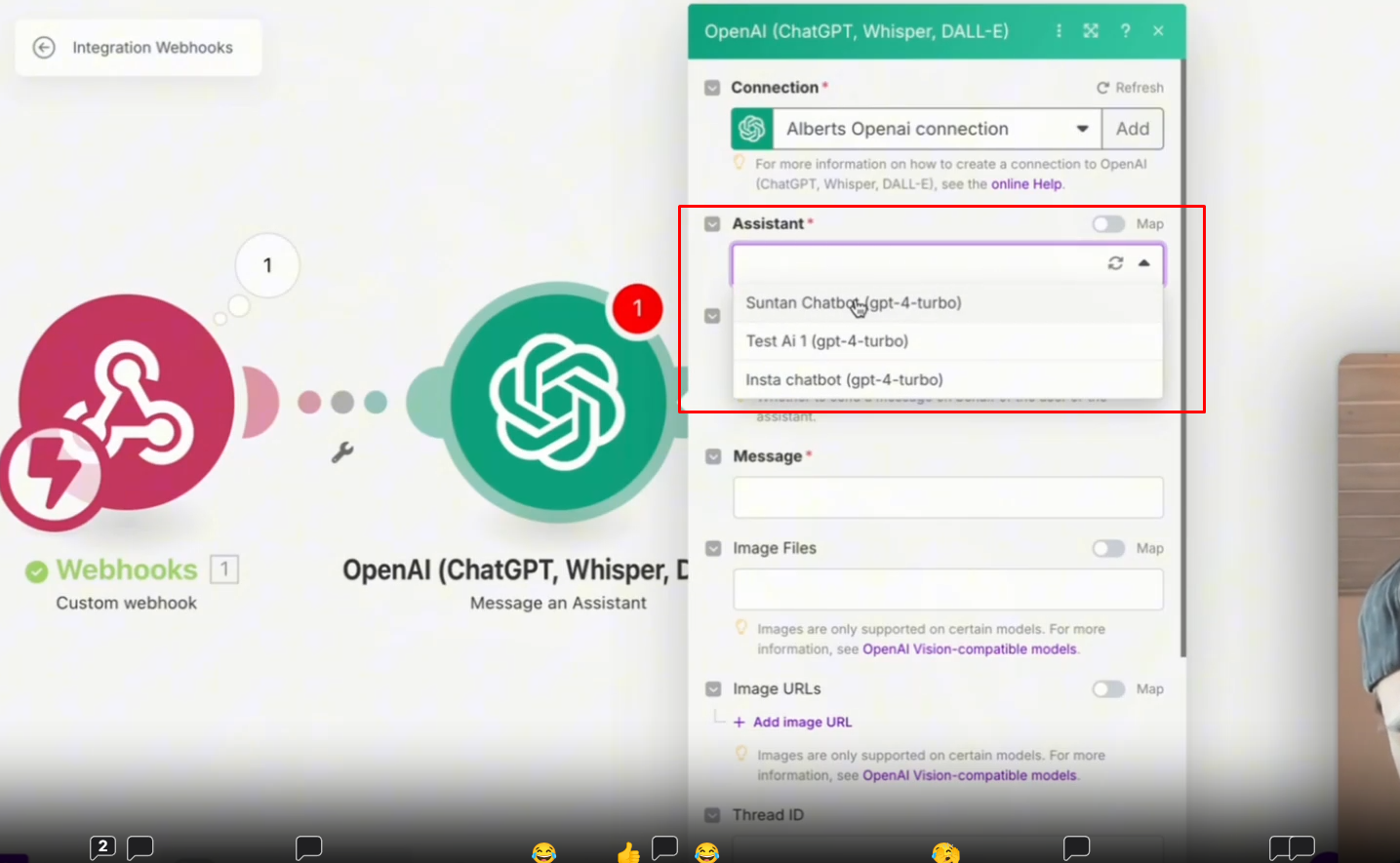

Hi i have a guy who send data from
webhook to go high level and then creates a open ai chat under a specific assistant and then send it back to go high level
below is a example of his workflow from make.com i am so dissapointed with pably that inspite having a lifetime plan i am forced to use make.com for this integration
Please tell me how to set it up properly since i cant find below setup on open ai connection
This should be possible using AI Assistant app actions or via OpenAI app's Custom API call action(harder way if you don't know APIs). But overall it should work.
