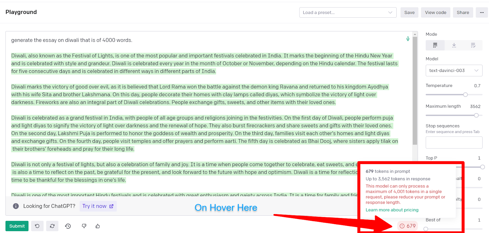

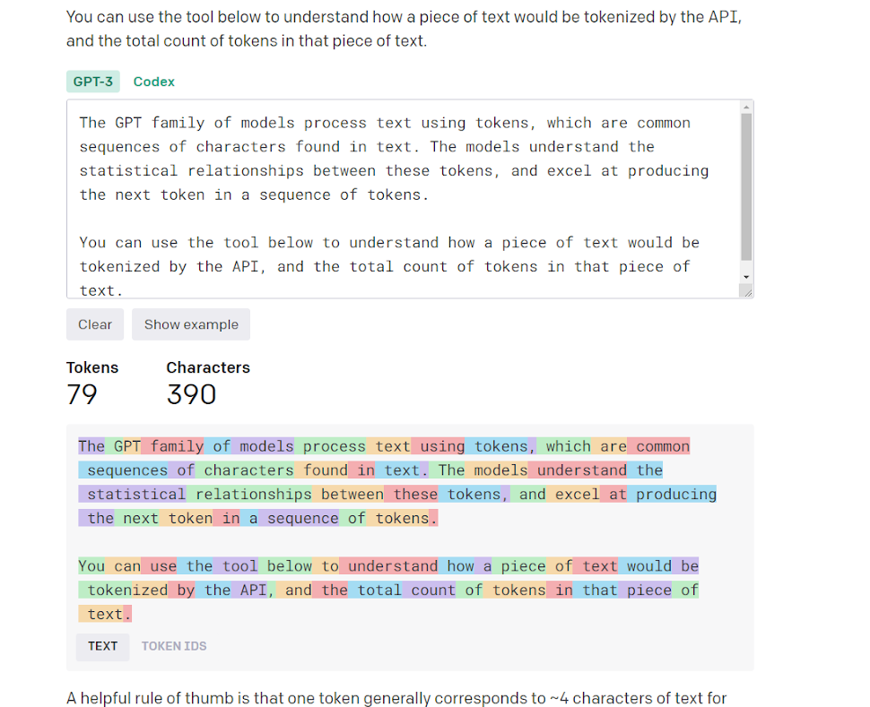

Please check the limit of tokens from the Open AI end and if that amount of tokens were executable from their end then it will also be processed accordingly.
Since the counting of tokens was different from their end, kindly check that once and then try again.

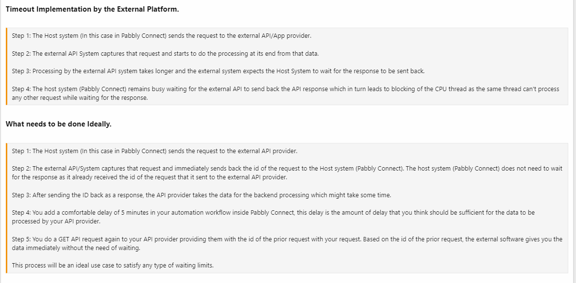

For a limited time, we have increased the Timeout window for OpenAI Generate Content to 40 seconds. Although this is not an ideal thing to do.
Please note Zapier has the timeout limit of 30 seconds for OpenAI and similar issues are been faced by the users across different platforms.
The ideal way to handle this use-case is something that we have informed to the OpenAI team. We have sent the email but haven't received any reply back from them.
The message sent to the OpenAI team is below. I would recommend users to also send the message below from their end.

Temporarily, the Timeout window for OpenAI Generate Content has been increased to 40 seconds, although this is not the preferred solution. It is important to note that Zapier has a timeout limit of 30 seconds for OpenAI and other platforms are encountering similar issues.
We have informed the OpenAI team about the ideal solution for this, but have not received a response.

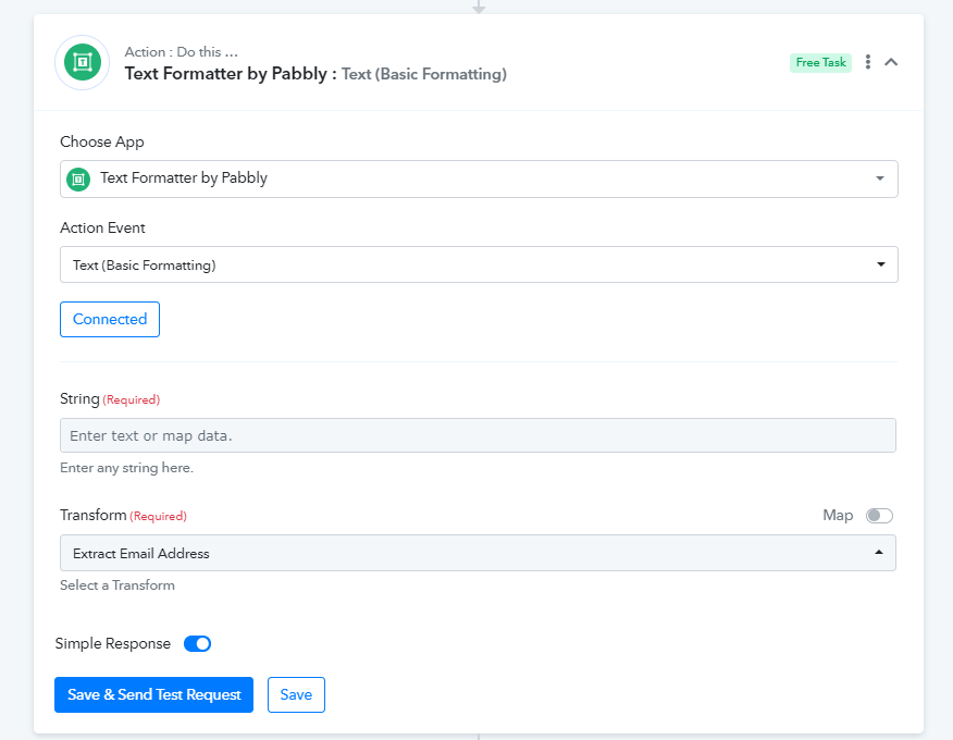

hey everyone, I started having the same issue for a very simple query: "extract the email", so I am not sure if this is an issue on OpenAI's side or Pabbly's.
Hey @Oleksandr
Have you tried the "Text Formatter by Pabbly: Text (Basic Formatting)" action step to extract the email address?
