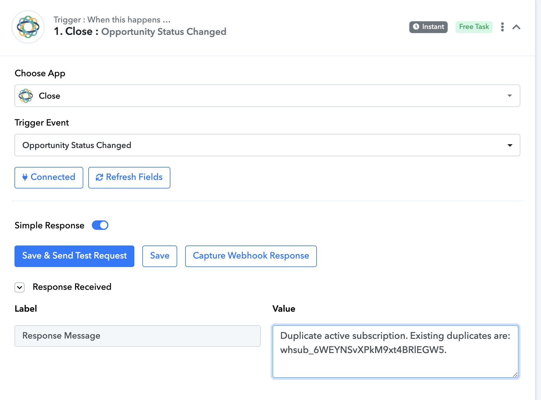

hello,
i have two connections to close.io and when i try to test the oppotunity change, nothing happens and i get the error that is attached.
Hey @raulmorenob

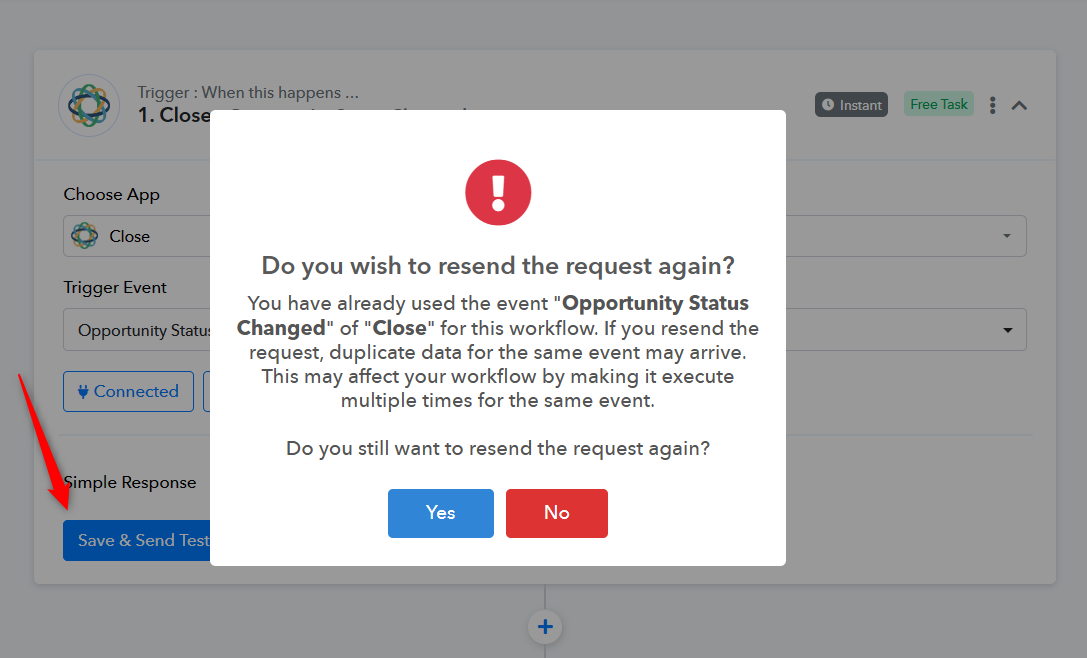

It appears that you might have pressed the "Save & Send Test Request" button multiple times and because of that Close application has created multiple webhooks configurations in your account which is why the application is not allowing you to use the trigger event.
So. kindly create a new workflow and then try again.
anybody who has this problem, you have to create a new connection with close strictly for this. It's the only way it worked
