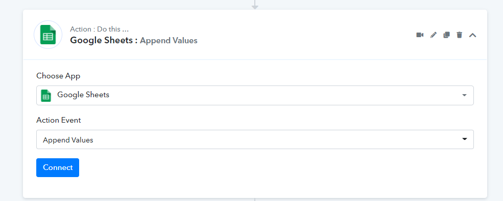

My mistake, it is called "Append Values",
Your suggestion does exactly what I thought it would do and it appends a NEW ROW with the data in this new row instead of in the row the 52 fields were just put in. This won't work since now the data is split between 2 rows.
Fagun Shah
You do not need to use "Add New Row" action anymore.
Did yu mapped all the 61 cells value in "Append Values" action and it created 2 rows? Or you just mapped extra cells after 52 cells in "Append Values" action?
