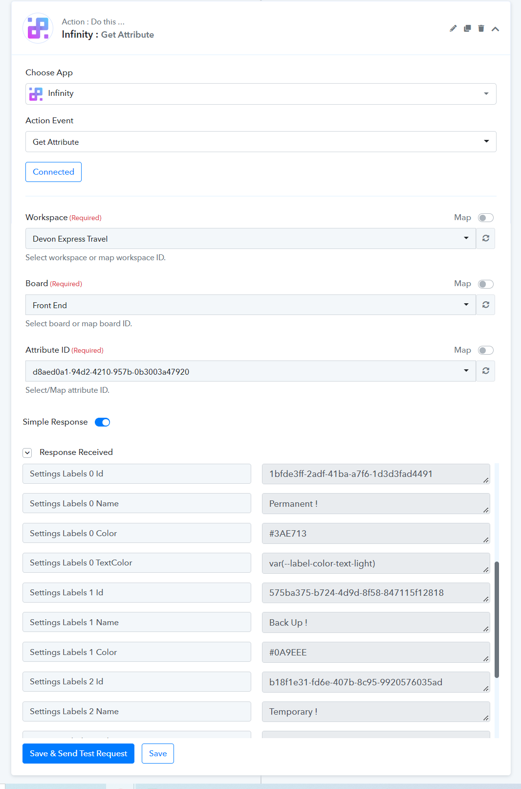

Hey @souldsad
We have recorded a short video for your basic understanding of the label fields in whcih you are trying to pass the label accordingly.
https://www.screenpresso.com/=g6VGf

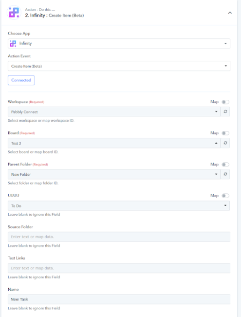

Hey @souldsad !
We have added a new event as mentioned below-
Kindly try with this event, as this supports dropdown and let us know if this can work for you.

Hey @souldsad
Thank you
I find the ID and I pass this Id, but I am still getting error
Invalid data "0568fec3-2915-46bd-a5ca-39587f88d4b7" supplied to "label" attribute: Data "'0568fec3-2915-46bd-a5ca-39587f88d4b7'" is not an array supplied to App\Item\Types\Label class.

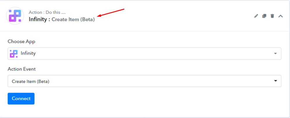

Hey @souldsad !
As we have mentioned earlier to use the Beta step, which when checking upon your workflow, we didn't see it.
Kindly use the below step once -
This step has all the dropdown which you require to work on it.
Kindly check on this and let us know if this works for you now.
