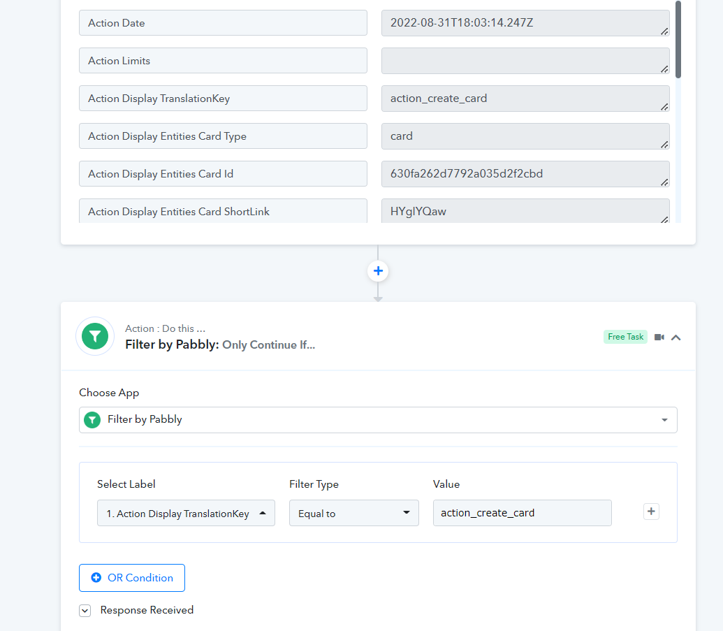

Anything I do with Pabbly and Trello, the Pabbly triggers go off, want to know if there is a work around for this.
You can use the filter action step after the trigger event where you have to pass the trigger event "Action Display TranslationKey" as the "action_create_card" type.
So the workflow will only process the cards whcih were newly created. Since the Trello API triggers the webhook whenever you make such changes in the board.
So, kindly give it a try and let us know if that works for you.
