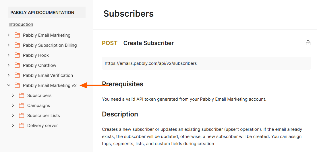

Hello @cynopha,
Currently, there is no separate standalone public documentation page for Pabbly Email Marketing V2.
The V2 API endpoints are available within the same API documentation itself under the “Pabbly Email Marketing v2” section.
Please refer to:
https://apidocs.pabbly.com/#bc2f0fbb-9f66-4c45-a43f-95001d57eed1
For better understanding, kindly refer to the attached image where the “Pabbly Email Marketing v2” section is highlighted, and you will find all the respective V2 endpoints there.
