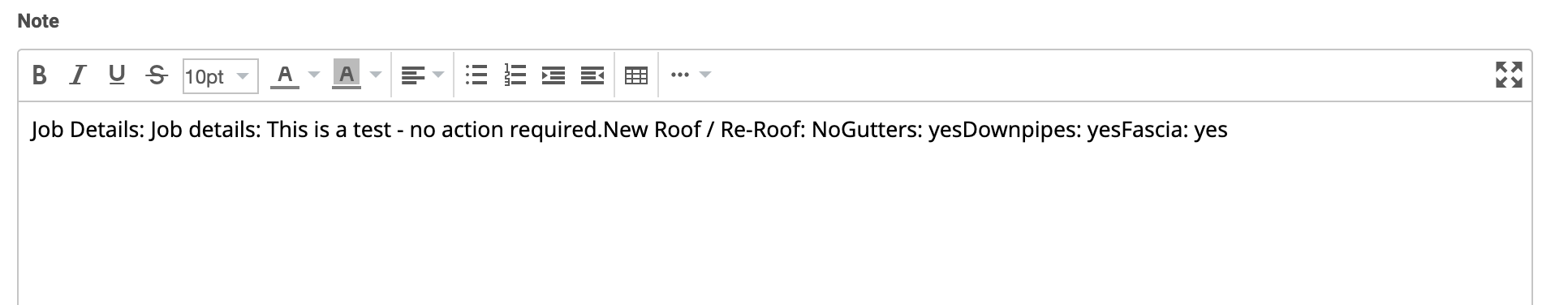

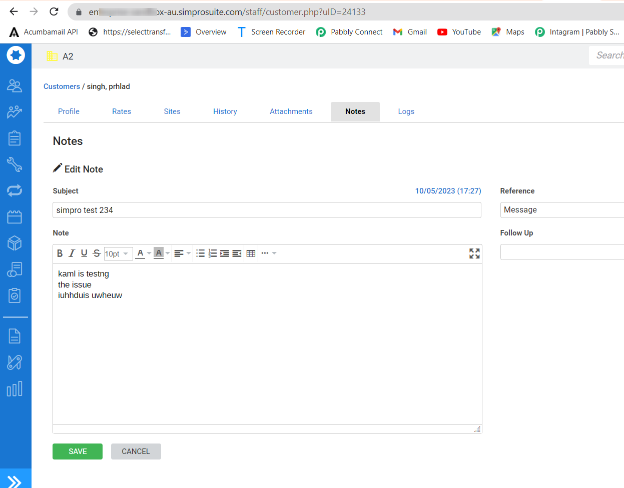

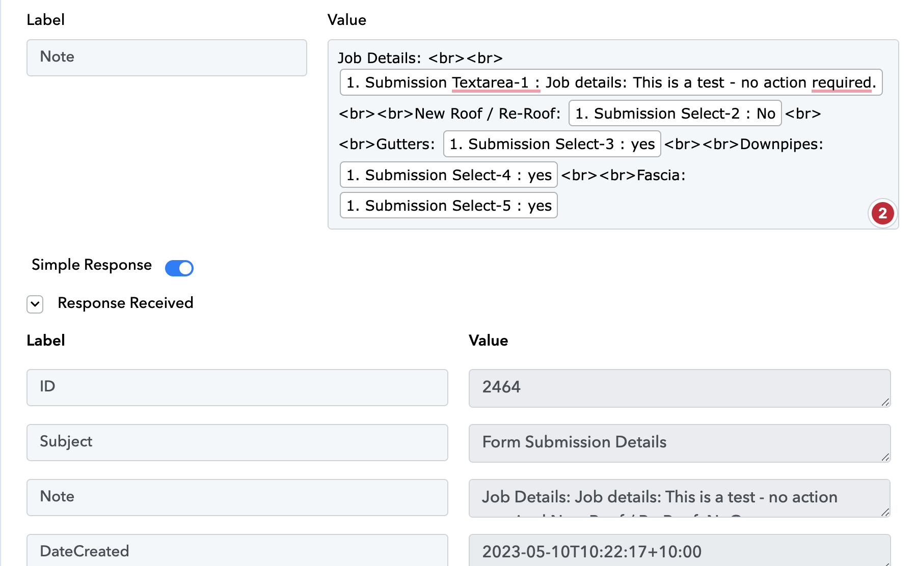

We've got a POST API request going out from Pabbly Connect. We've been advised by SimPro developers that this is an issue with Pabbly Connect and not their system.
Basically, Pabbly Connect is stripping out the
tags and other HTML data which is preventing proper function.
Screenshots of the API request inside Pabbly as well as what's received in SimPro attached below.
See attached

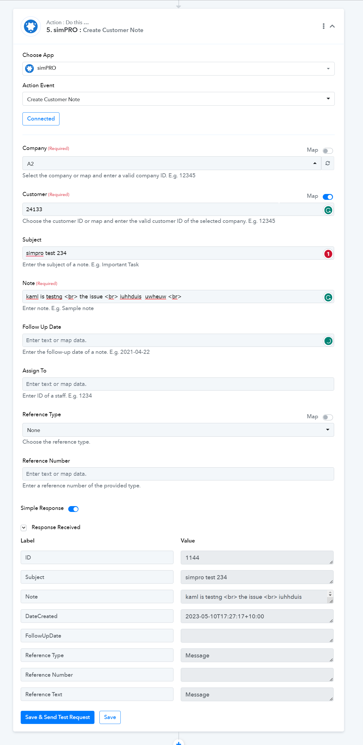

API by Pabbly doesn't support HTML rendering, so the note is being stripped of
tags. I suggest using the simPRO: Create Customer Note action event instead, which will give you the desired result.
