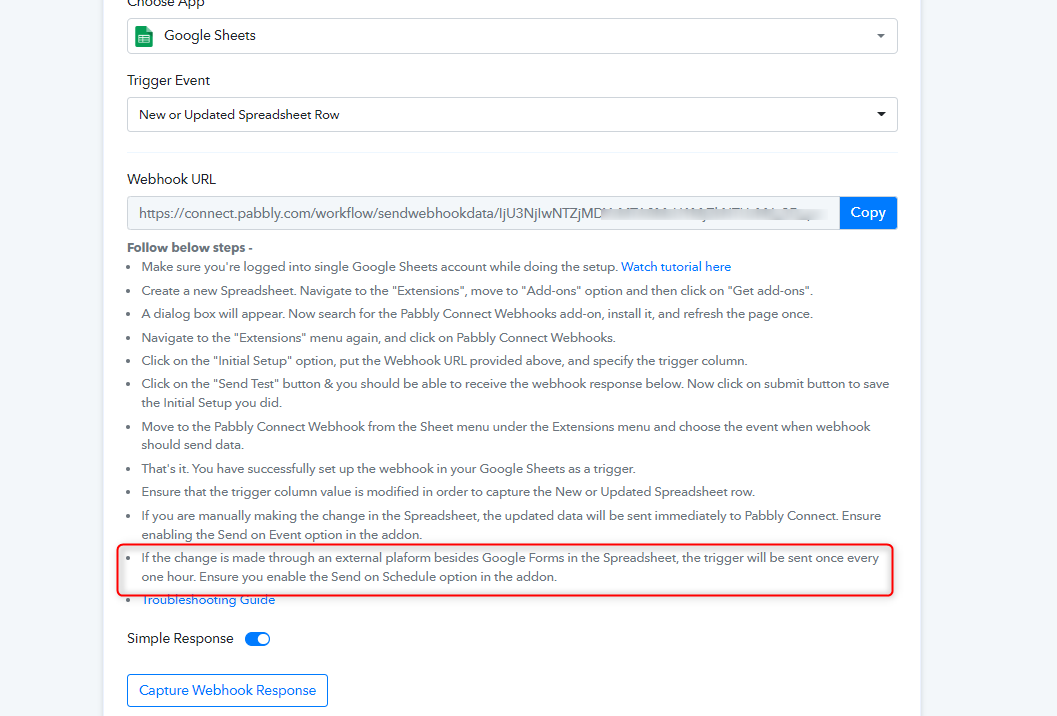

Hello. Was there any solution to this issue? I have the same problem.. All works fine when entering the data manually in Google Sheets, but as soon as the data comes trough Glide it does not work.
If the data is being added to the Google Sheet via any third party app, which is happening in your case, then the data will be send to your Pabbly Connect workflow after 1 hr.
