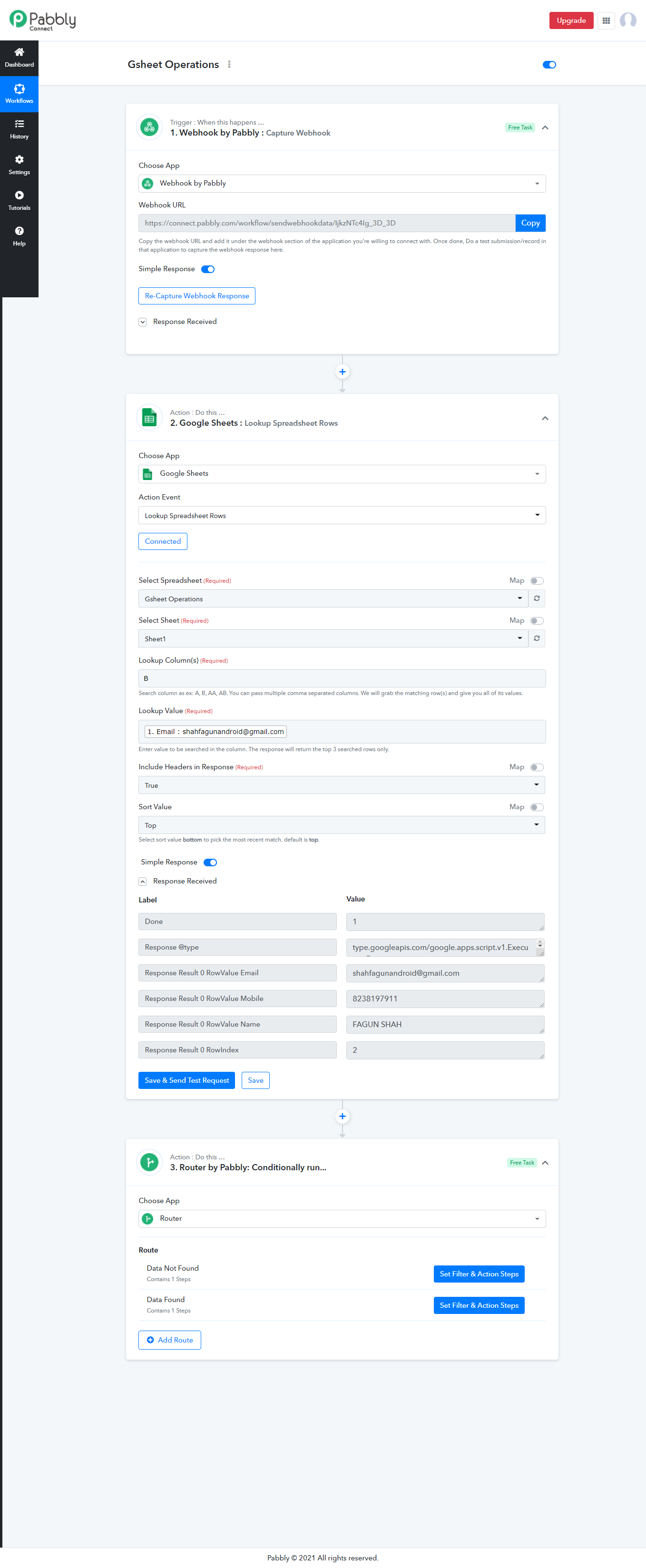

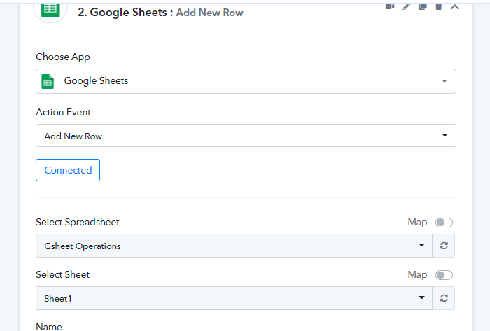

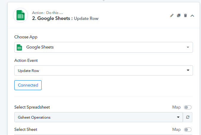

You need to Use Lookup Row action after Webhook Capture step.

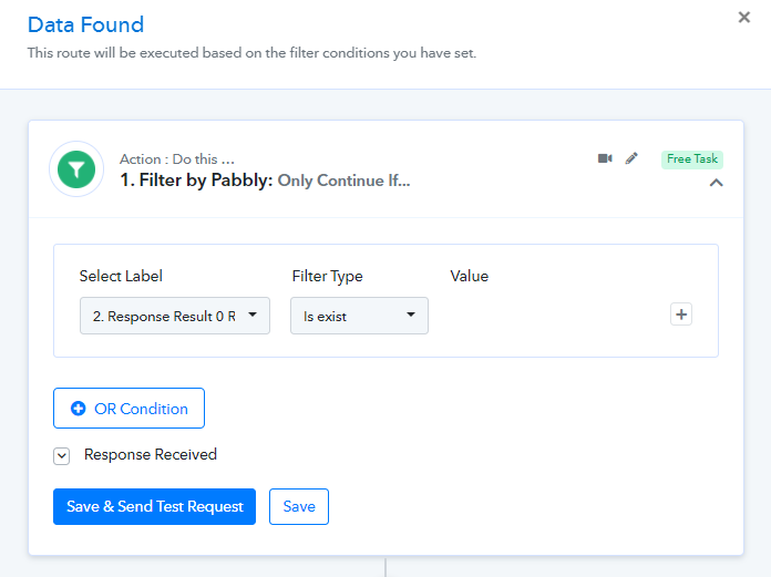

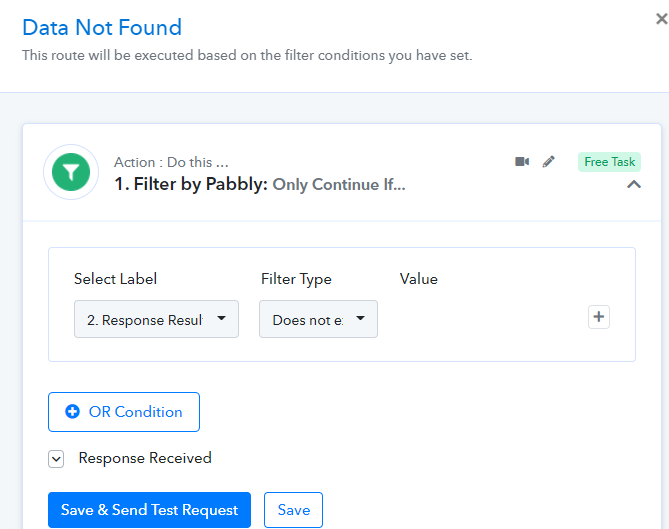

If that returns row index then it means that row already exists so you just need to update it. If it does not return row index it means you need to use Add New Row action.
Above thing can be achieved by use of router.

Router 1 - Data not Found -
Router 2- Data Found
