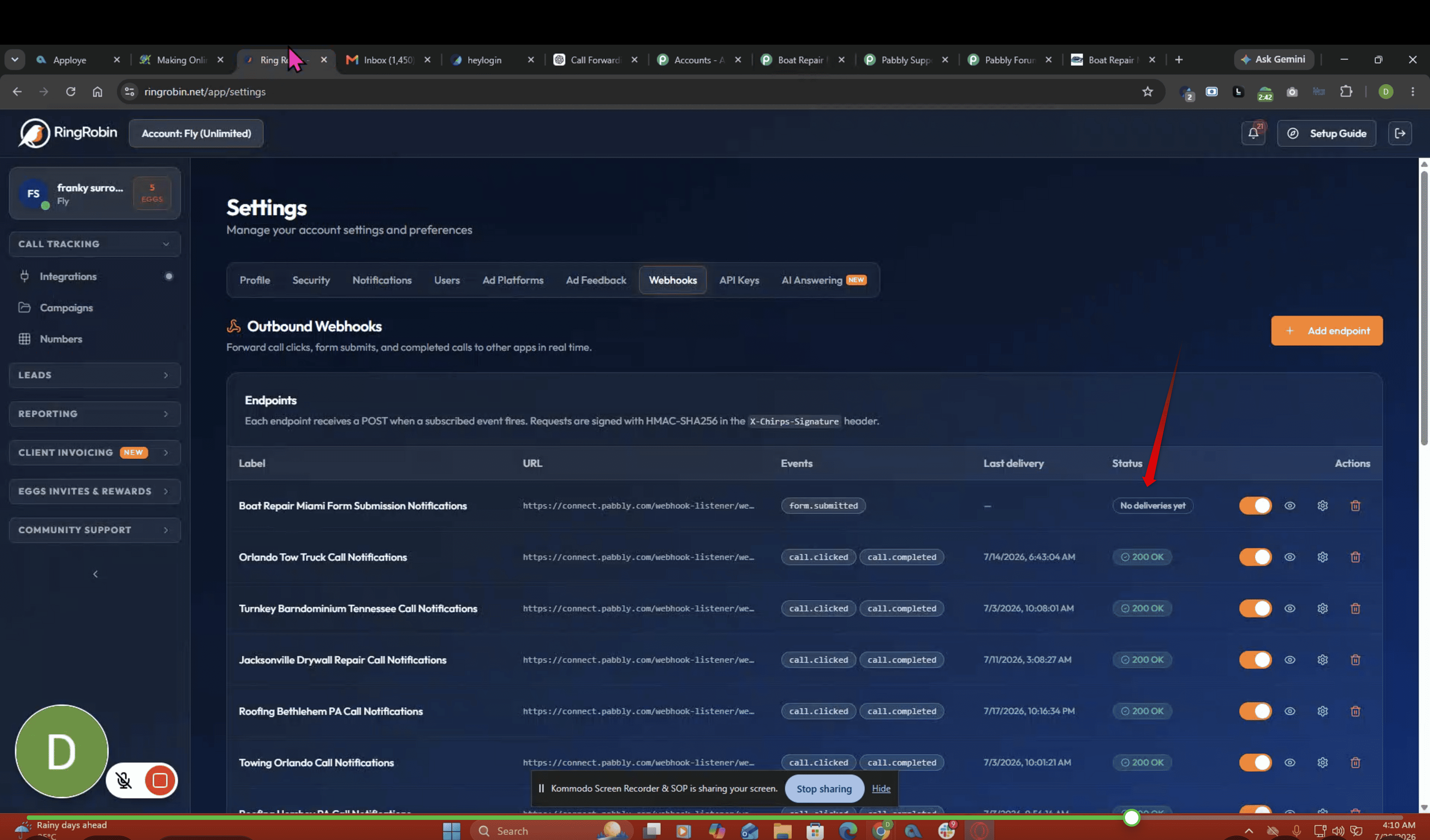

Hello Adeel, this is the link: https://ringrobin.net/app/
Call clicked and call completed are working but not form submitted.

As per the screenshot, you have added 4 Webhook URLs, which are subscribed to Events Call Clicked and Call Completed. Edit and check whether there is the Form Submitted event as well?

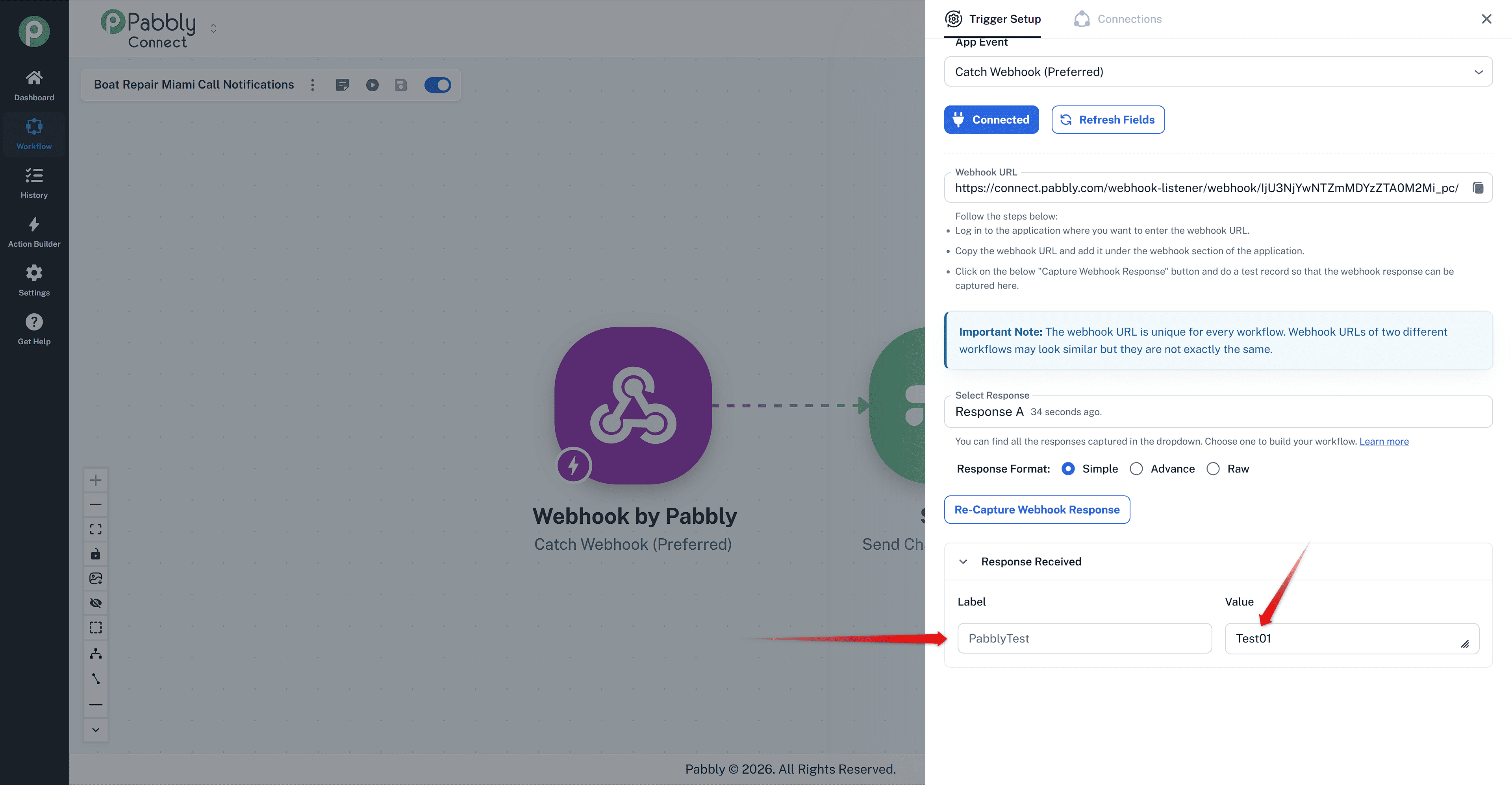

Can you share the particular workflow URL for which you have selected the Form submitted event? Also, can you uncheck the other events (Call clicked, and Call completed and then submit a form by hitting the Recapture response button before submission.

What I noticed is that the form created in RingRobin has a gray circle, while the other forms created in Meta and Gravity Forms have green and red circles in the green section. Pabbly Connect listens to form submissions from GHL forms, such as Gravity Forms and Meta Forms, but it does not listen to form submissions from RingRobin.

We just made a test submission to the webhook of the particular workflow, the webhook instantly received the data. In webhook integration, we do not have control over the source application; we only catch the data sent from the source application. We do not have control over fetching the data or rejecting the incoming data.
Here you can see the status is not 200ok like others. This confirms that the source application did not sent the data to the webhook.
I recommend that you contact RingRobin Support Team and ask them to deliver the Form submission data to the particular webhook URL. The issue is not from Pabbly's end.
