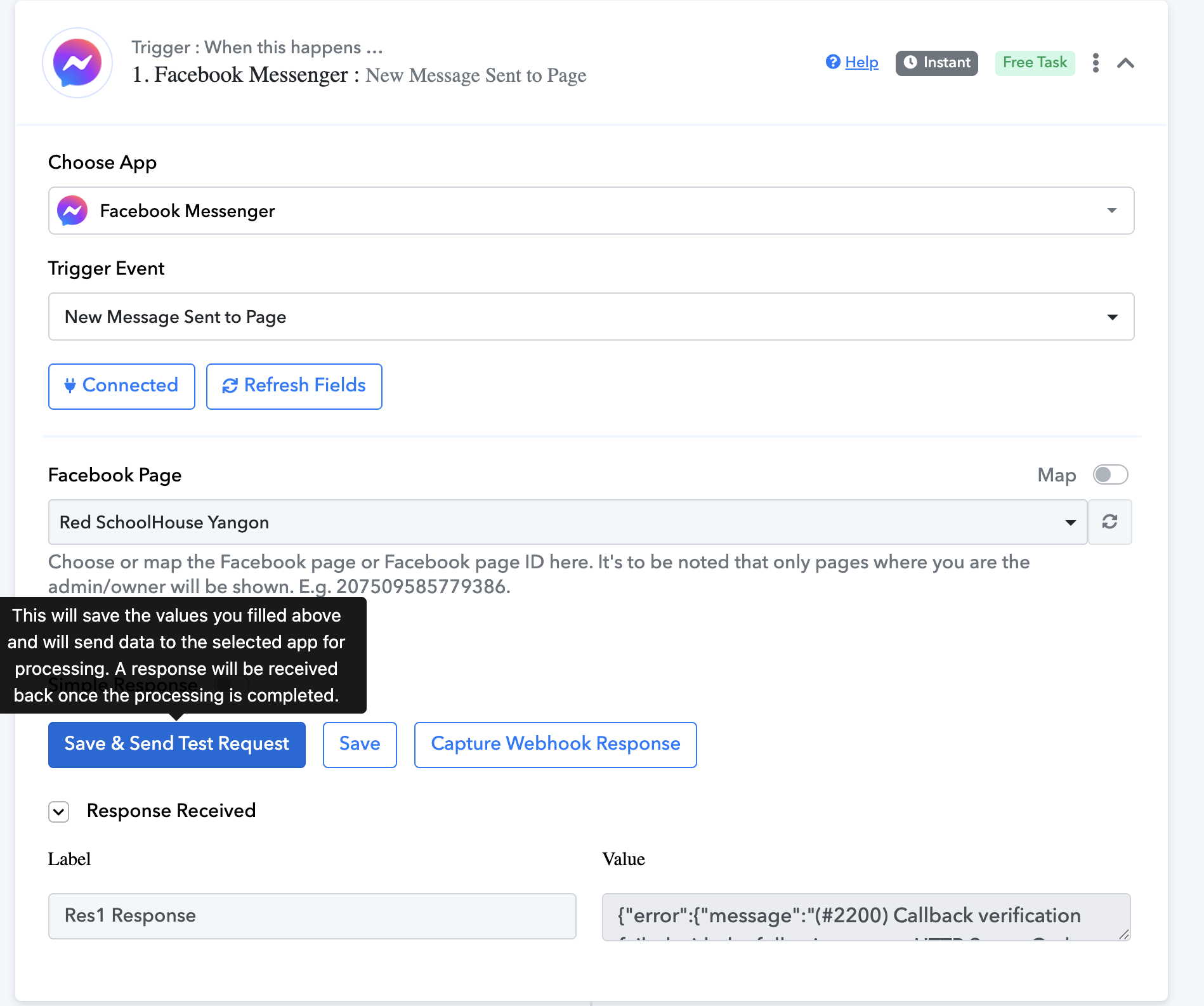

edpaing — Reply ·
Its showing me error messages and does not capture my message.
Hello @edpaing,
Please follow the attached tutorial below to set up the trigger, and share a screencast of the entire process if the issue persists.
youtube.com/watch v=5y7Br0Lc0mc

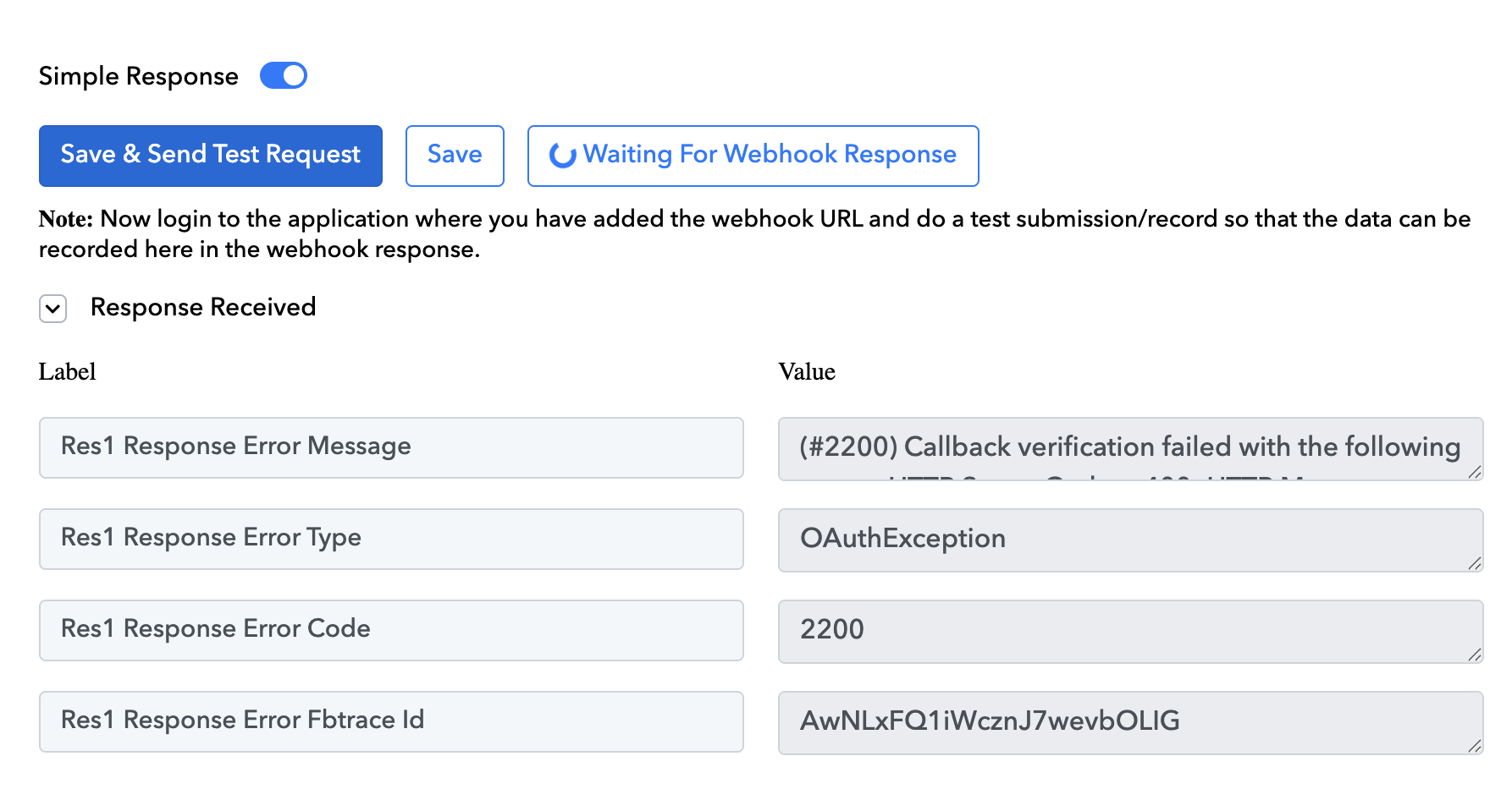

edpaing — Reply ·
I tried again watching the tutorial. It's showing me the same error message..I haven't even sent a message yet. I just pressed save & test and the error message pops up. Keep in mind i've checked all the permission boxes required too.
Hello @edpaing,
The error indicates that Facebook’s webhook verification failed. Please check the following points:
  1. Reconnect the Facebook Messenger trigger and ensure the correct page (where you are an admin) is selected.
  2. Confirm that your Facebook user has full admin access to the page.
  3. Remove and reconnect the Pabbly Connect app under Facebook → Settings → Business Integrations, granting all permissions.
  4. Ensure the page is subscribed to the webhook under your Facebook Developer App → Messenger → Settings.
Once verified, try saving and sending a test request again.
