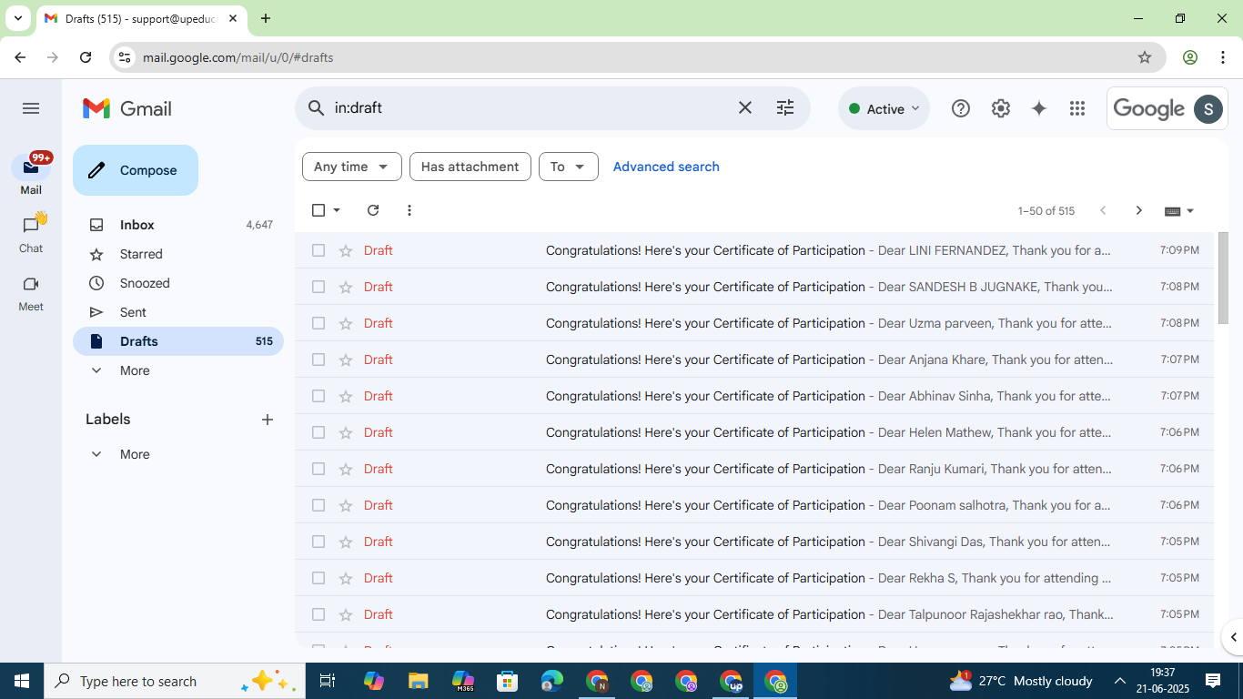

I created workflows to send Certificates to the users via Gmail who fill Zoho form. But it is showing 515 Drafts, out of that more than 200 are of today. If it can't send mail, then what is the use of Pabbly?
Even in Task history, it doesn't show Failed, we have to check inside history of each task and even that is not opening now a days.

Upon reviewing the task history for the workflow you shared, we noticed that the recent executions on 21st and 22nd June were processed successfully.
However, a few task entries from 21st June did encounter issues. Based on our analysis, these appear to be related to temporary problems with the Gmail API. Specifically, we observed two types of errors:
  1. HTTP 500 errors – These typically indicate a server-side issue with the Gmail API.
  2. "Response not received in 25 seconds" – This means the API did not respond within the 25-second window that we allow for API calls, resulting in a timeout.
We recommend monitoring the workflow for now, and if you encounter consistent failures, please feel free to reach out with the relevant Task History IDs for further investigation.

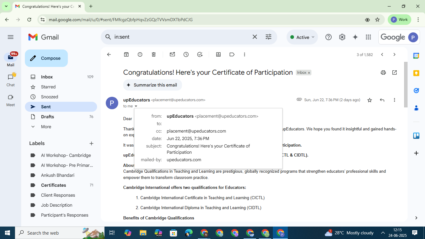

Hello @namanupeducators,
We sincerely apologize for the inconvenience you're facing—we understand how disruptive this can be to your workflow.
This issue may be related to some recent updates made on our end, although we cannot confirm that just yet. To help us investigate further, could you please share the Task History ID(s) where you observed the email being sent with blank name fields and missing email addresses
Once we have those details, we’ll be able to take a closer look and assist you more effectively.
We appreciate your patience and look forward to resolving this for you as soon as possible.

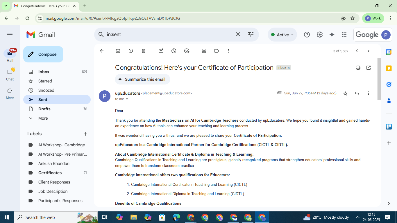

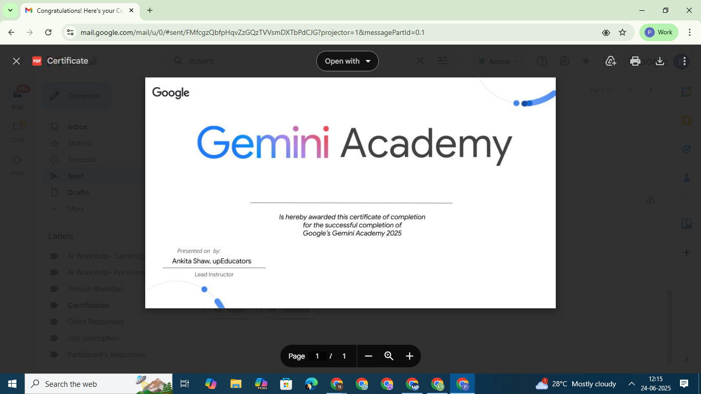

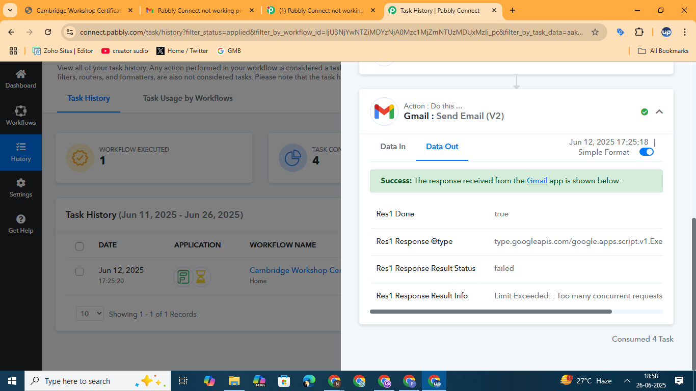

Recently I noticed that some of participants again did not receive certificate.
Sharing one information here

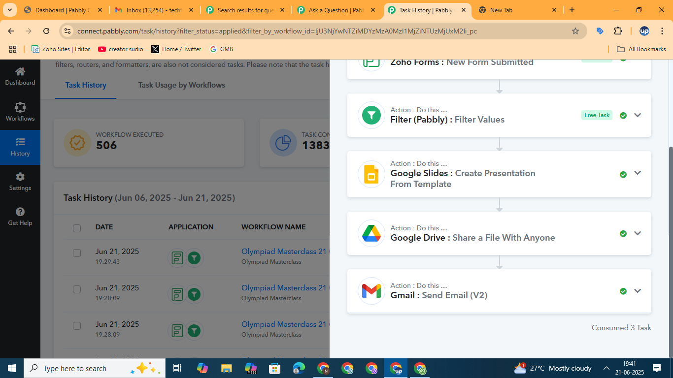

Task id: IjU3NjYwNTZiMDYzNjA0Mzc1MjZmNTUzMDUxMzIi_pc
Task history id: IjU3NjUwNTY5MDYzMTA0MzI1MjZhNTUzNzUxM2E1MTY2NTQzODBmMzIi_pc

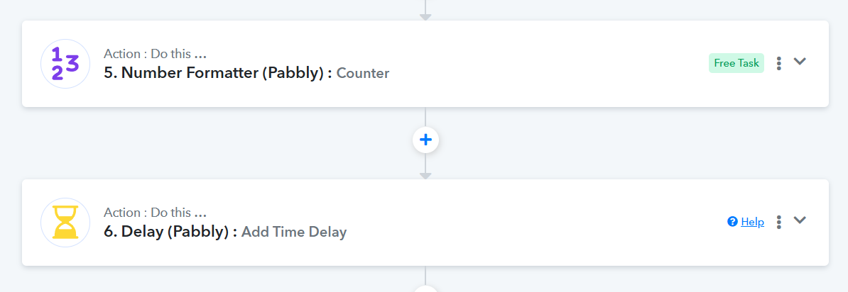

The issue appears to be related to multiple Gmail action events executing within a very short span of time. We have added a Counter and a Delay step to your workflow. Please monitor the workflow for some time to see if this resolves the issue.
