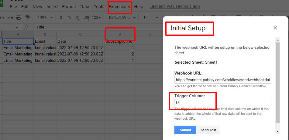

Hi, I have data on G Sheets A and Pubbly connect add some data form this Sheet A to other Sheet B.
I have Pabbly extension with send on event activated.
The problem is that Pabbly send data from Sheet A to Sheet B, but only frist column not all the line. Is I send manually with "Send Custom Data" works ok
¿Any solution?
PabblyMember4
Hi @host
Could you please make sure that when you added extension, then in the initial setup >> Trigger Column you have to add the last column of the sheet which has data in it? Else it will not pull up the data from the sheet.
Kindly check and let us know.
Further, do watch this tutorial which explains in brief about how to setup Google Sheets trigger -
