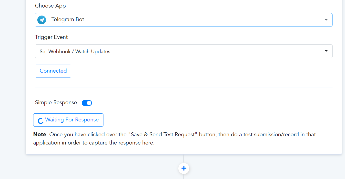

I have issue with submit data from Telegram to PabblyC. I followed the tutorial, pasted particular token given by BotFather from Telegram, but process is stucked (from yesterday) on "Waiting For Response" below 'Simple Response' area, thus I can not do a test submission on 'Response Received' fields. I did same path for two new workflows on PabblyC, with two different tokens and still the same situation. Do I do something inncorect, or there is an issue with 'Save & Send Test Request' button in app? Would be great for some tips and advices :) Thank you very much! Martyna

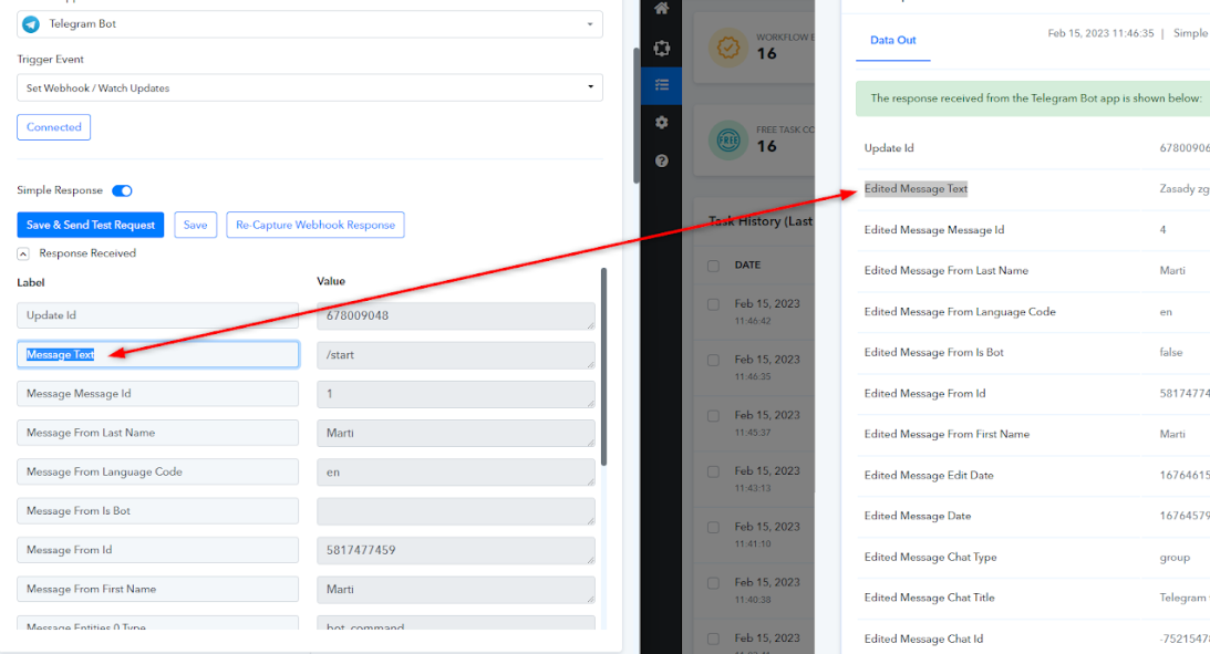

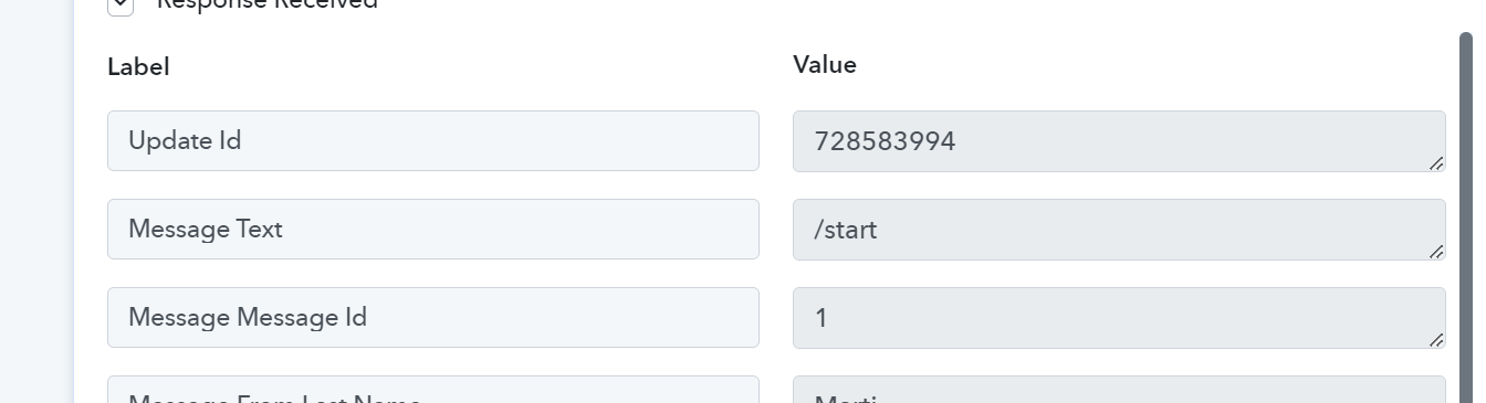

Hey @Supreme
Unfortunately it does not work :( I did everything correctly - bot is added and an admin on new group I've created on Telegram. But instead of receive particular message from the group, I got '/start', which is not text from the group but from the new created bot. What do i do wrong here?

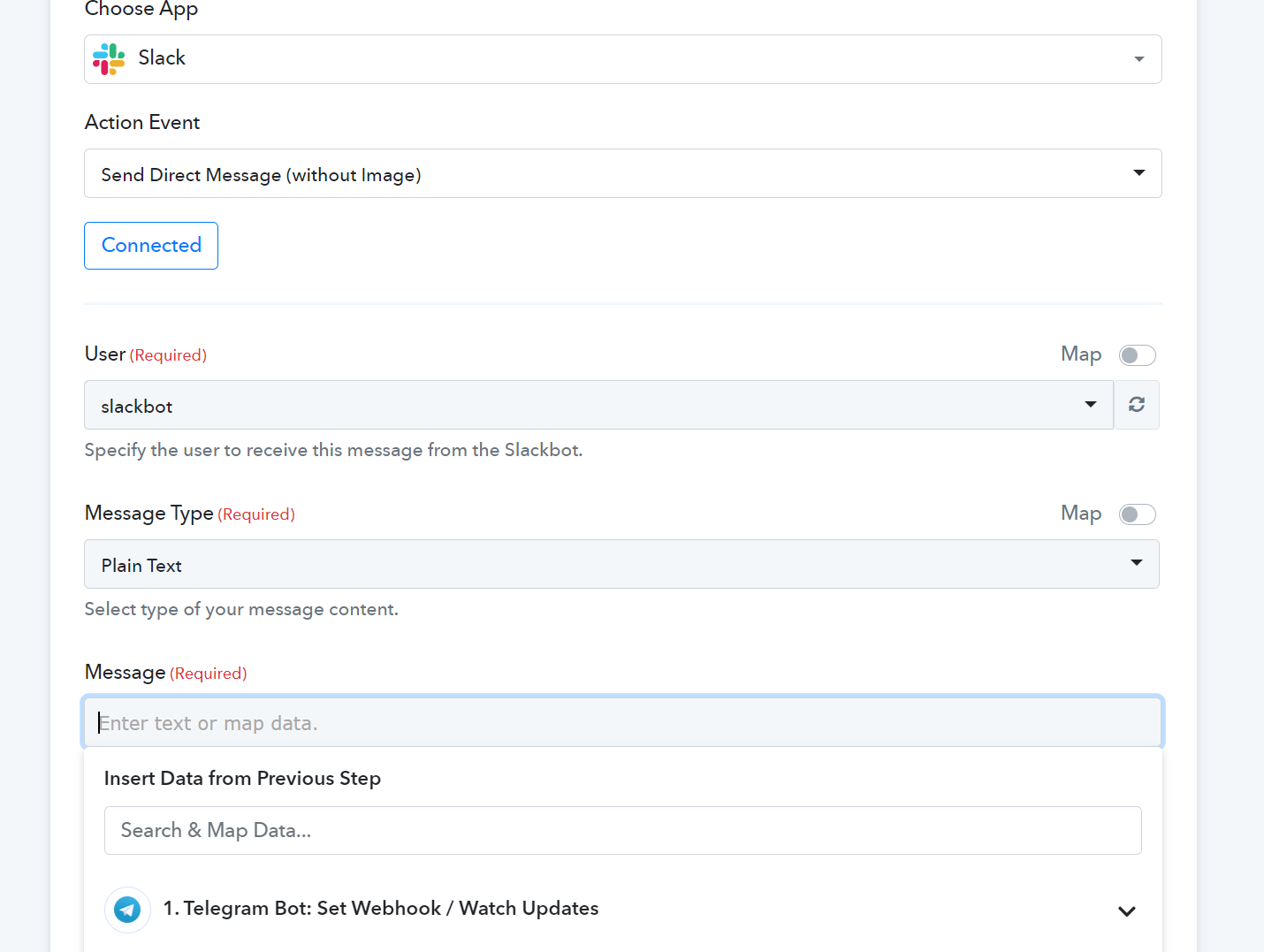

Can you help me with another case please? I need to merge Telegram to Slack. I found pretty old video tutorial, but now app is updated and I am lost. What type of user and message type should I chose here? I've tried here many combination from drop down, but now results. Any tips please? :) Many thanks!
Unfortu
Hey @Martyna
You can use the Plain Text message type to pass the message according to the received text from Telegram.
As we can see from your workflow, your workflow processes the text message from Telegram to Slack.

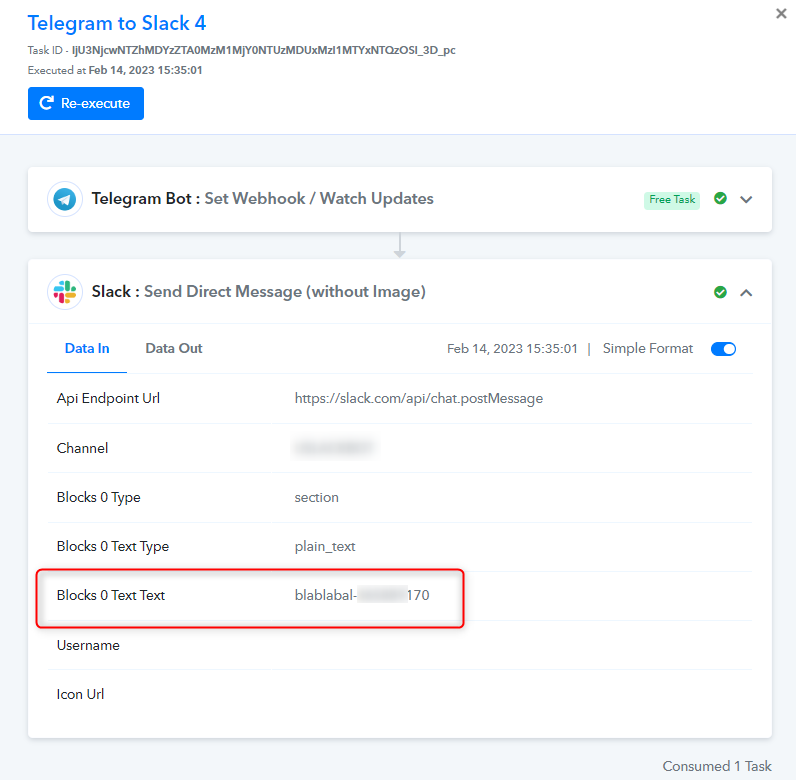

Hi @Supreme
I do much appreciate for your help and patience :) I do so many tests I can create new connection with closed eyes now :D I see that connection is active and Telegram and Slack are connected by PabblyC. The point is I still do not receive any messages from Telegram on my Slack channel, I did not even see my new created Slack channel for test on drop down "use existing connection". What do I do wrong? Help me solve this out please.
My slack is only for my personal use, but I do not think here is an issue with no receiving messages from Telegram. What do you think?

Okay, problem solved! :) PabblyC is awesome!!!!! <3

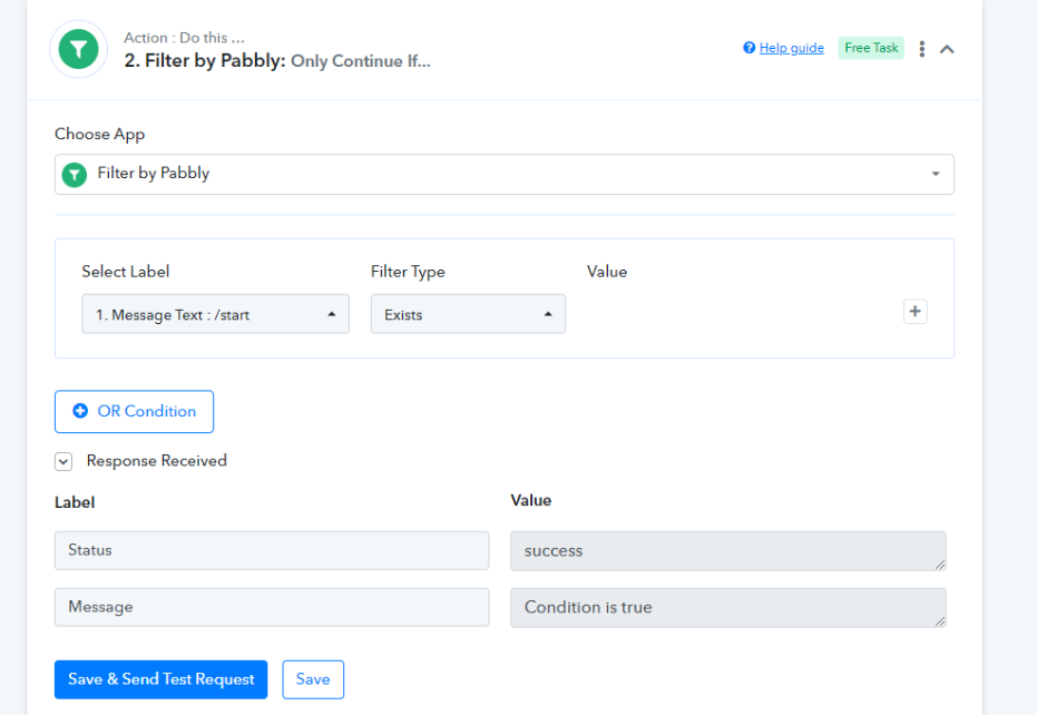

Also, it appears that you are also getting the message from Telegram when they got edited.
So, we have added the Filter action step to only process the data for a new one.
