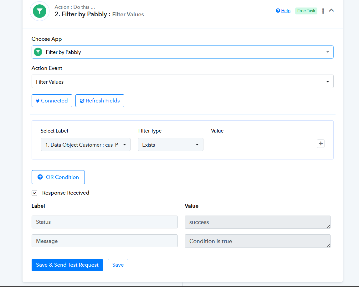

Hey @JamesMsasi
It seems that during a particular execution, there was an instance without a customer ID, which was essential for the "Stripe: Retrieve a Customer by ID" action step. Consequently, this action didn't execute as the necessary customer ID was missing.
To rectify this automation issue, a solution could be implementing a Filter action step. This step would only proceed when the customer ID is obtained from the trigger response. This ensures that the action requiring the customer ID will run only when the ID is present, making the automation more reliable and efficient.
