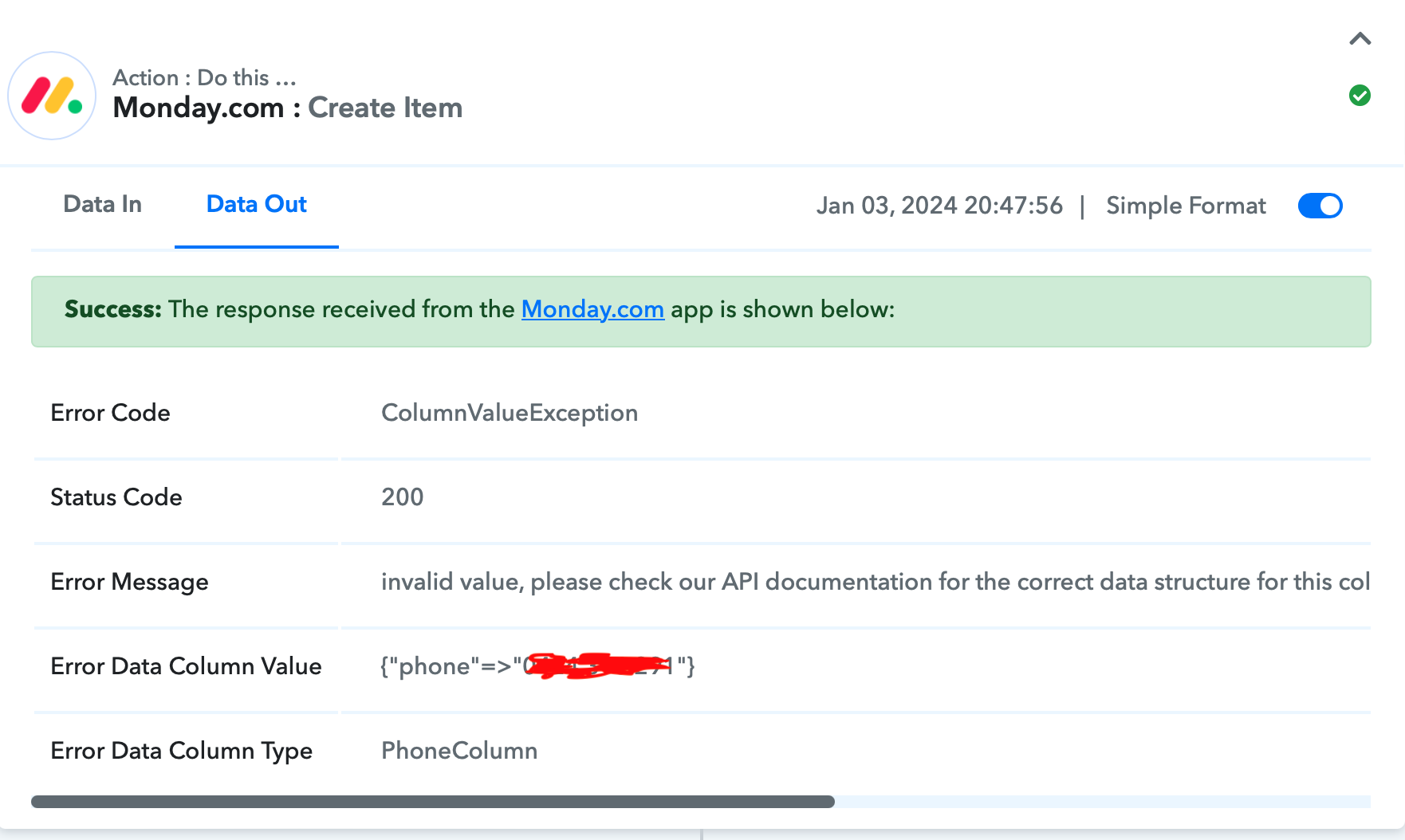

The task status is marked as success.
However - when going from Cognito forms to Monday.com - there looks to be a value issue with the phone number and was rejected by Monday.com.
Not sure why Pabbly then marked this as success.
Any ideas?
Hi @BGE,
HTTP Status Code 200 signifies that the request was successful, but the response does not contain any content. As this code is returned for the successful execution of an endpoint, it wasn't marked as an unsuccessful task.
