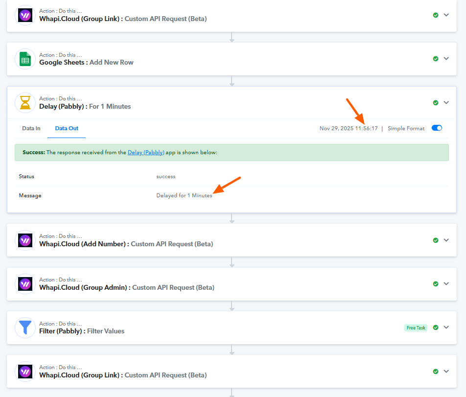

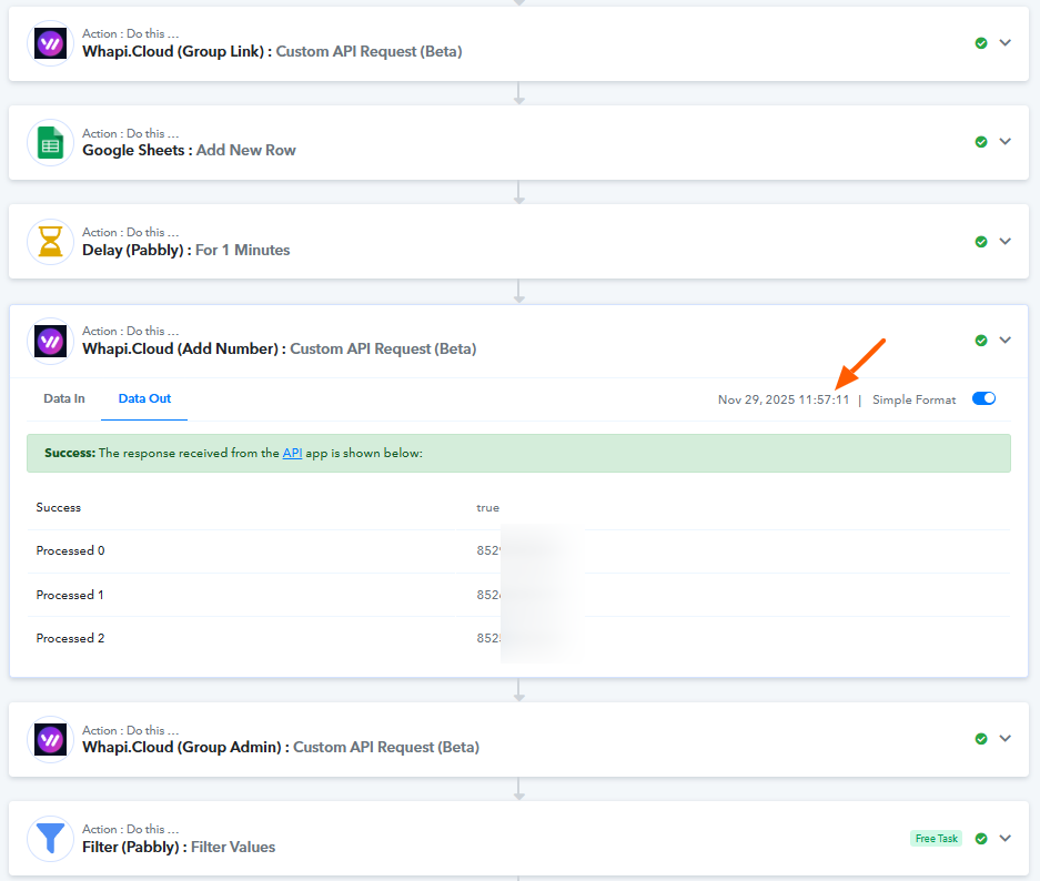

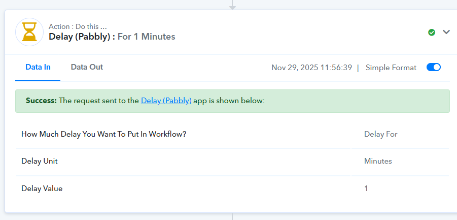

I setup Delay for 1 Minutes but the autoflow was no delay, keep auto run per second.
Please advise!
Hello @gpro,
The delay seems to be working fine, refer to the attached images.
If it is still persisting, could you please share a screencast instead, you can better understand exactly where it didn't worked.

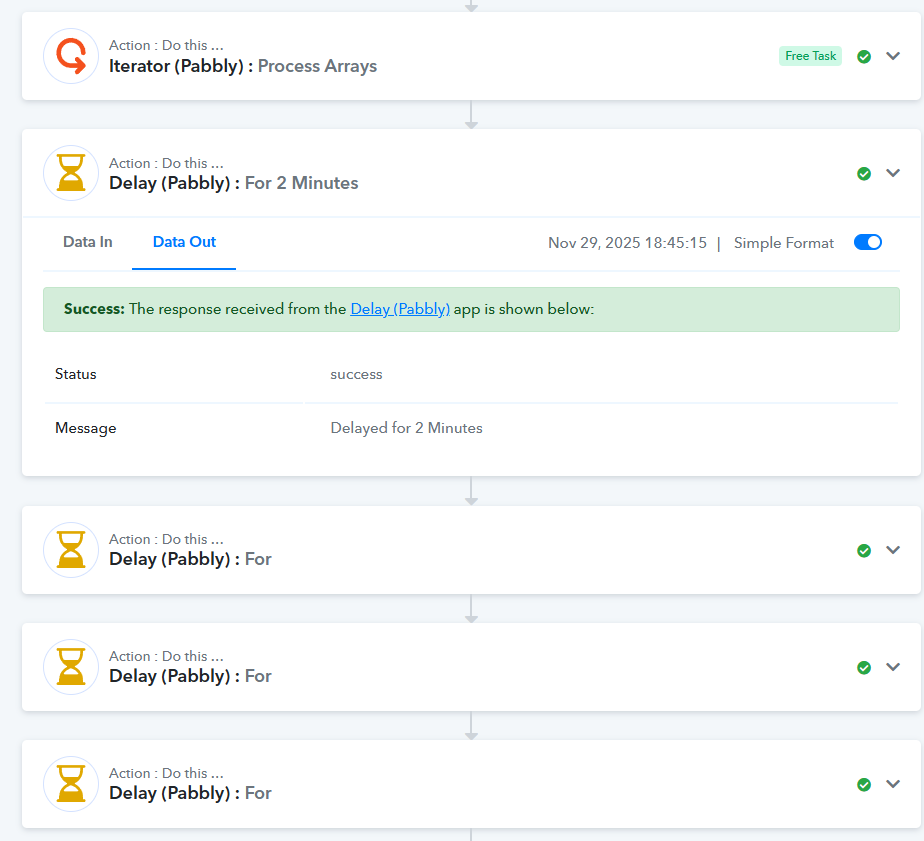

Hello @gpro,
Could you please try adding a two-minute delay just after the iterator, instead of adding a minute delay at the end? Let us know if it works fine then.

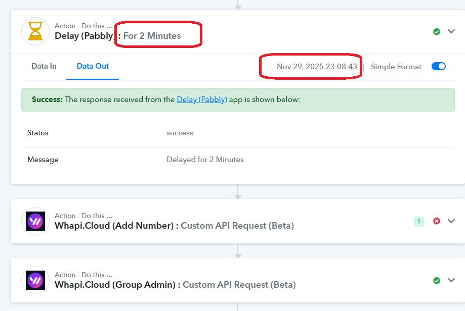

I tried another position for "Delay 2 minutes", you can find the screenshot shows the time didn't delay.
Workflow: https://connect.pabbly.com/workflow/mapping/IjU3NjcwNTZkMDYzNjA0M2M1MjZlNTUzNDUxMzUi_pc
Task History ID -
IjU3NjUwNTZhMDYzZTA0MzI1MjZlNTUzNDUxMzE1MTYyNTQzNTBmMzIi_pc​
Based on your Task History, we can see that you have added the delay before the Google Sheets action step, and it is being executed after a delay of 2 minutes.
To ensure that the ‘Whapi.Cloud’ action step is executed after a delay of 2 minutes each time, you need to add a Delay step immediately after the Iterator step.
Please allow us some time to look into the issue related to the Delay being executed repeatedly when added after the Iterator step. We will get back to you with an update soon.

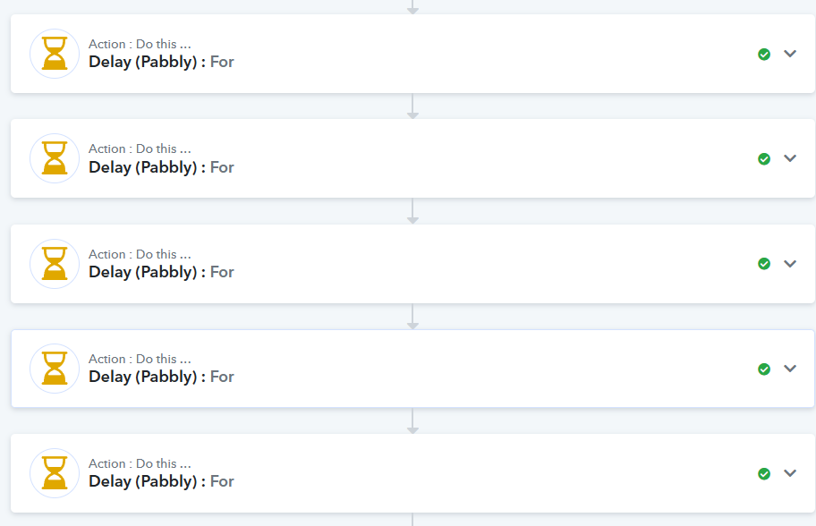

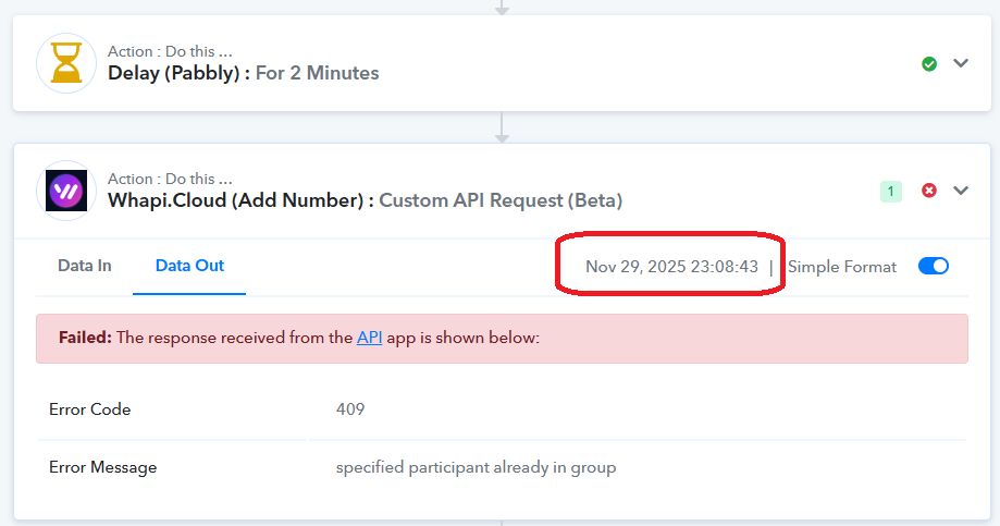

I tried add Delay step after the Iterator, but why it will loop the Delay Step like the screenshots:
Task History ID - IjU3NjUwNTZhMDYzZTA0MzI1MjZlNTUzNDUxMzE1MTYyNTQzNTBmMzIi_pc
gpro
I added Delay at the last step, it can work before.
Just don't know why it doesn't work in this week.
I think the Delay function has problem recently.

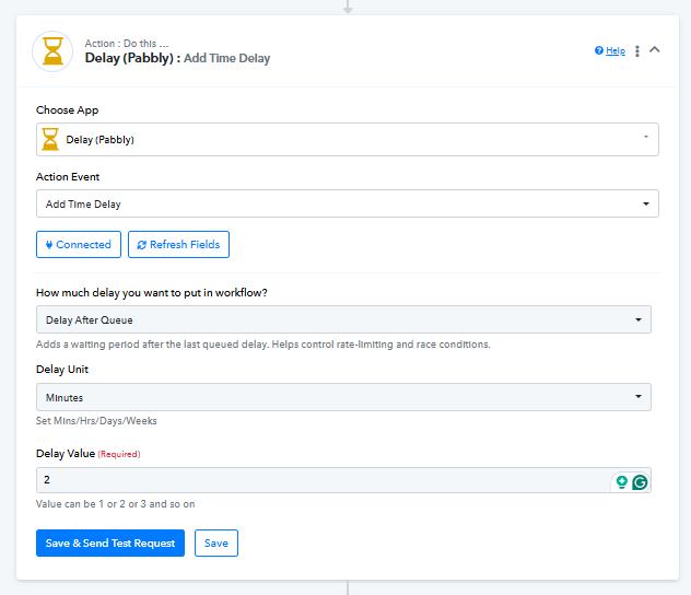

Hello @gpro,
Please add the delay as per the attached image after the Iteartor, and let us know if it helps in resolving the issue.
gpro
I give up use Delay function since it caused loop the last workflow.
Changed to JS is properly run now.
