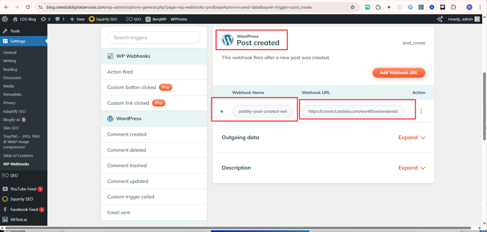

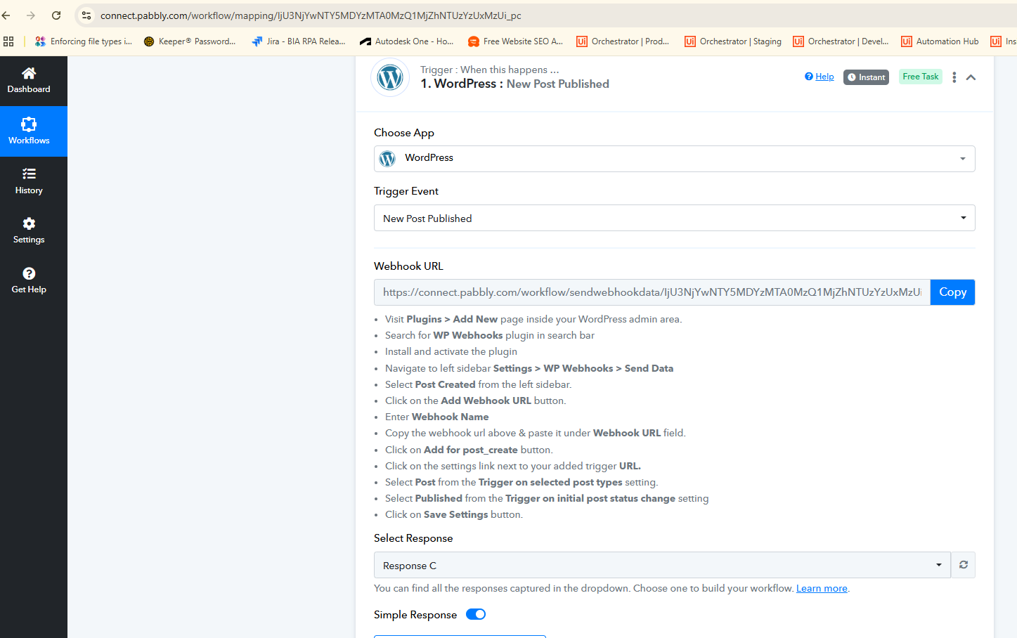

Hello. I followed this Youtube post to the letter but when a new post is published to my blog, the automation doesn't kick off. I have included a screenshot of the first bit below. However, when I manually go through to test the automation, it will work. I need this to work "automatically" when a new blog is published on a site.

I'm creating the blog on Wordpress. You can see the wordpress connection screenshot that I shared earlier in this thread. The blog is located at https://blog.celestialdigitalservices.com. I've made all the connections and test connections when creating the workflow and it works fine. If I manually initiate it, it works fine. However, it is my understanding that it is SUPPOSED to run automatically after it has been setup and it doesn't. What workflow url are you referring to? I don't think you'd have access to my actual workflow but here is the link - https://connect.pabbly.com/workflow/mapping/IjU3NjYwNTY5MDYzZTA0M2M1MjZmNTUzNjUxMzci_pc

I guess I'm not really understanding what the ask is here. When I built the workflow, you can ONLY advance AFTER you have received a response from the blog. This is how you are able to then map the fields that you want to capture. As I stated before, if I manually go through the workflow and click on the "Recapture Webhook Response" button, everything works as expected. It just does NOT do this automatically even though it is supposed to. The webhook site url is https://blog.celestialdigitalservices.com/wp-admin/options-general.php?page=wp-webhooks-pro&wpwhprovrs=send-data&wpwh-trigger=post_create.
