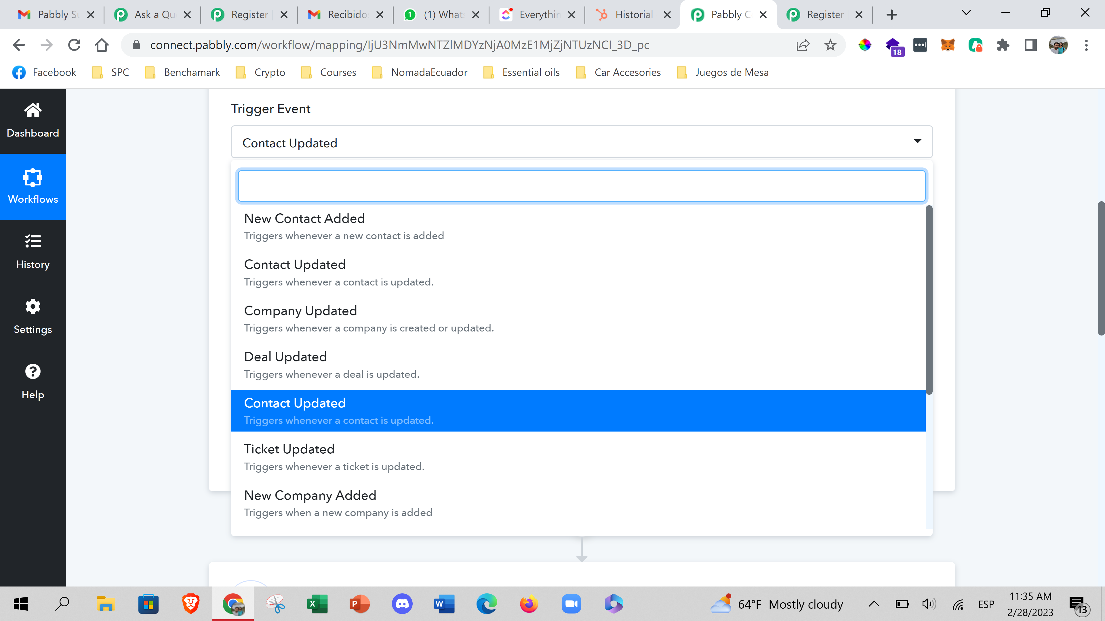

I have create a workflow that everytime a contact is updated in hubspot it triggers an SMS web service. I see that pabbly have two update contact triggers, one that asks me for an API KEY an other that doesn´t. I am using the last one.

I tried by the other hand to use the other "Contact Updated" method but it asks me for an API Key... and as hubspot deprecated the generic API Keys I tried to create a private app but it didn´t work.
If you can explain to me how the "Contact Updated" trigger works in terms of capacity limit or if only updating certain fields will trigger the event? and which of the triggers I have to use, because when I import contacts to hubspot they don´t trigger the event in Pabbly

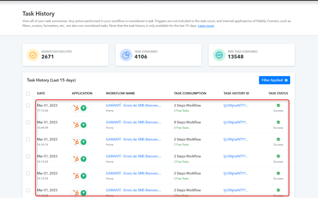

Hey @Operaciones
We can see from your tasks history you have successfully updated the contact in Hubspot. Please check the below screenshot:-

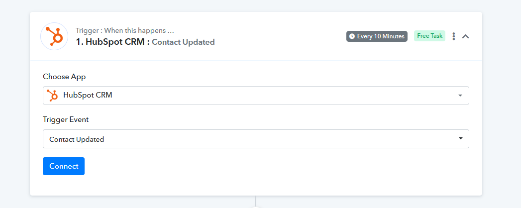

Ok, so help me understand how Pabbly works please...., I just updated 50 registers in Hubspot and after 5-10 minutes Pabbly took 100 registers (the 50 I update + another 50 that I updated earlier) and did what it was supposed to do. It was supposed to update those registers earlier but it didn´t, and they are being updated now when I update this small segments of 50.
Since the polling time of the Hubspot: Update Contact has 10 mins to fetch new data and because of that, your previously updated contacts were also fetched after that time.

Hey @Operaciones
Since the Hubspot CRM trigger event is a pooling-based trigger event that can only fetch 100 records at a time, we recommend you use Webhook By Pabbly trigger event which you can configure in your HubSpot account.
