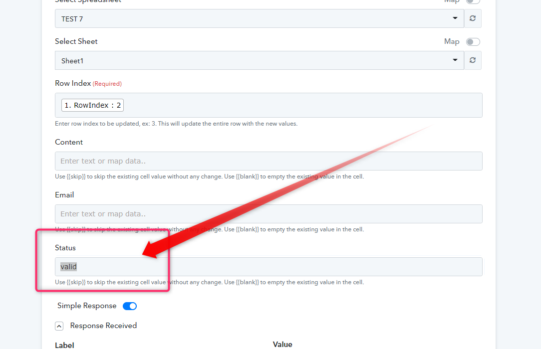

Hey @brandlever1
It seems like you have manually typed the "valid" keyword in the status field of your Google Sheets and hence that's why it wasn't dynamic at all.
You need to map the status of the email id on the status field. Although we have set that up for you. Please give it a try and let us know if you get stuck at any step.

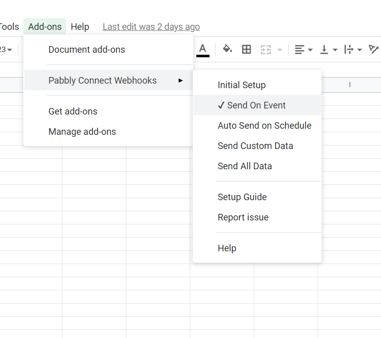

Further, could you please confirm that you have marked the Pabbly add-ons on your Google Spreadsheet and the data is coming from another application, or you are just manually feeding the Sheet?
brandlever1 — Reply ·
hello thank you for the help!
Hi yes, I have already connected my google sheet with pabbly ad-ons. No, the data (emails) are manually inputted.

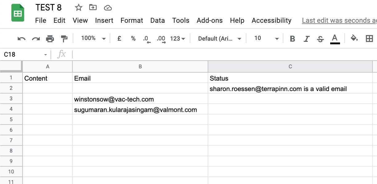

I made a new workflow on pabbly connect (TEST 8) and followed your advice but I am still encountering the same problems:
1. The emails I input are being sent to mailifier for verification but i am not getting feedback
2. It updates on the same cell (C2), and the update is not dynamic ("[email hidden] is a valid email" even when inputting a different email). What I wanted is for B2 email to have an update shown on C2, B3 email to have an update shown on C3 and so on.... and for the update to be based on the feedback from mailifier.

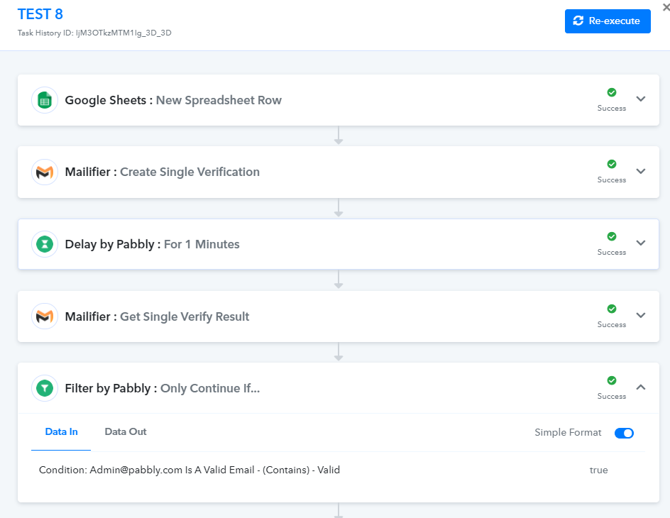

Hey @brandlever1
It seems like the Mailifier API action step takes a bit of a minute to send a response to the email. So we have added a 1-minute delay before the "Get Single Verify Result" to load the complete response from their end.
Though we have tried it by re-executing roughly and it is working. Please try again at your end by passing the emails in Google Sheets.
