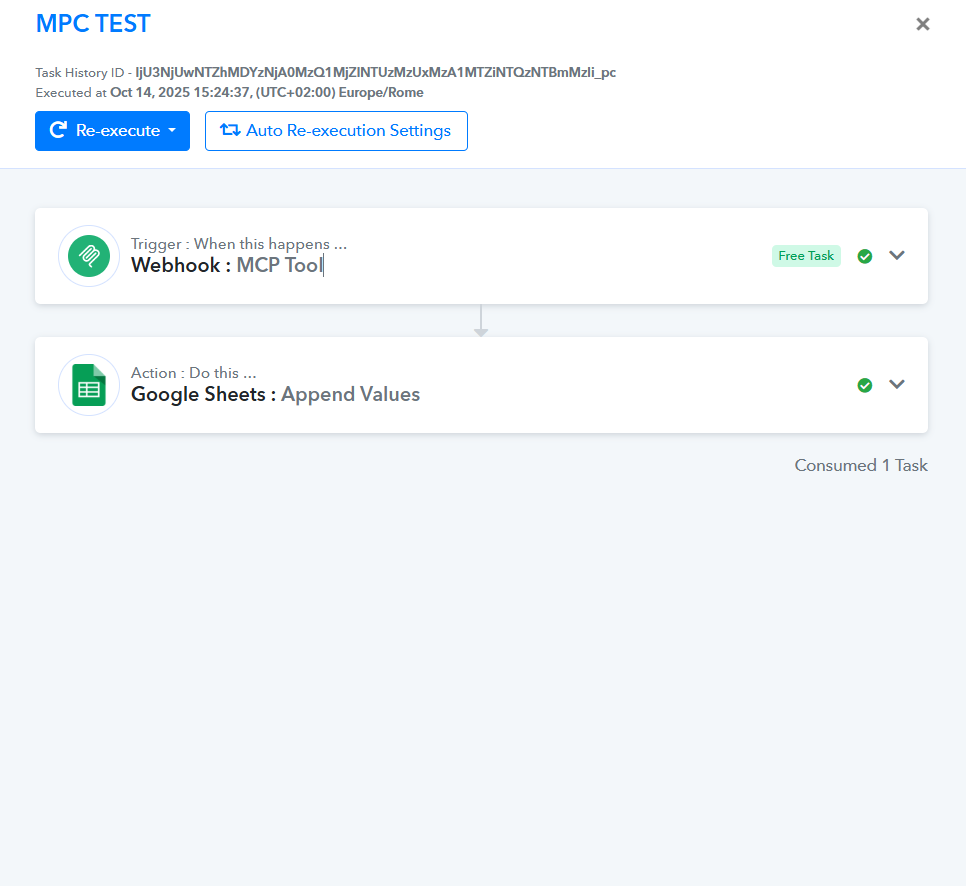

- When i exectute MCP command from openai agent, the Google operators runs fine and i can even see this happening in the Task History panel (see image) - I also get a success response from my agent.
BUT
- When i use the MCP to control a "Data forward" operator or "api call" operator i always get 500, even tho the data pass through, this never shows in the Task History panel.
Looks like the google operators are well configured and responding. - While the other operators gets the data but the MCP doesnt really trigger the workflow the same way it does with google operators.
