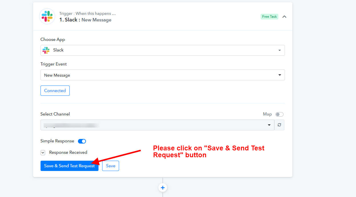

Hey @axx
We have made some changes and created a new trigger event of " New Message "on Slacks' and made the old one legacy.
So. please try the new trigger event at your end and I hope this might help you.
axx
I modified the trigger but all my tasks were consumed the last time when this bug was still in place. I'm unable to test whether the trigger is working
Hey @axx
We have already reset your task in your account, please check that out and now you can try the trigger at your end.
