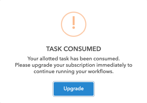

I see this as soon as I log in to my account
I had deactivated the integration before replying to this thread yesterday. Looks like it was reactivated (for testing?) and now that integration consumed all 10,000 tasks on my account!
Please take a look at this. And if you're going to be testing, please deactivate the integration after testing so that it does not consume all tasks.

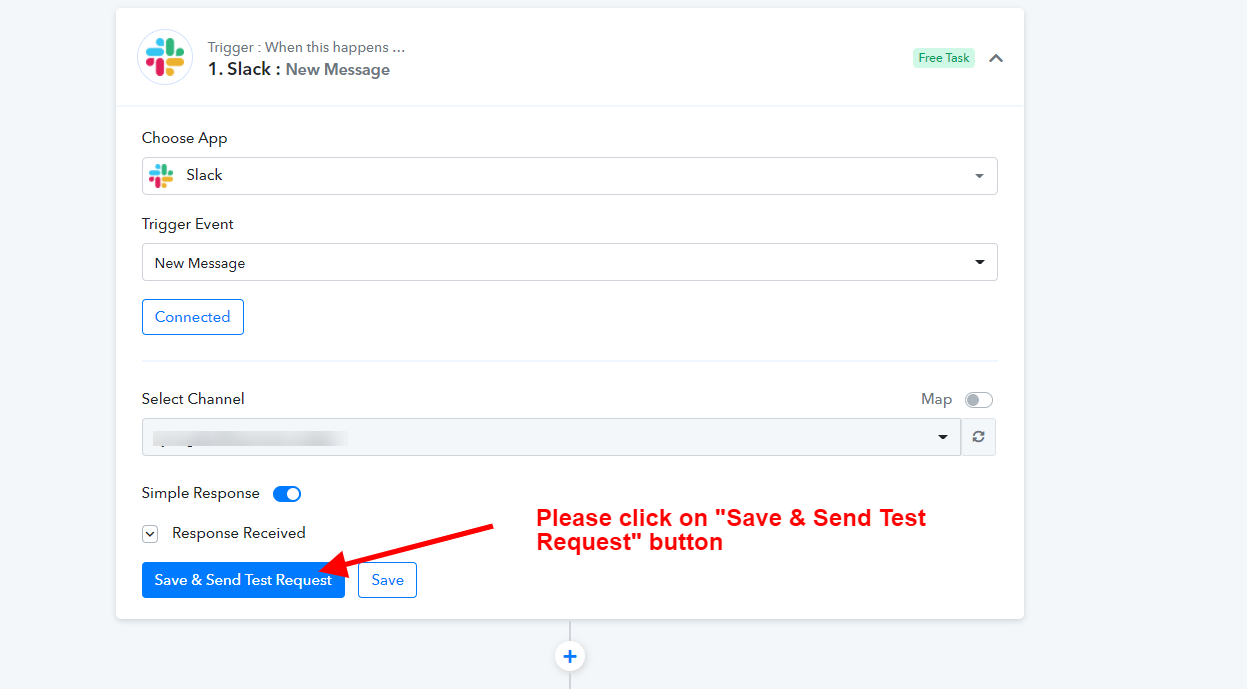

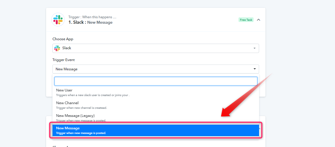

Hey @axx
We have made some changes and created a new trigger event of " New Message "on Slacks' and made the old one legacy.
So. please try the new trigger event at your end and I hope this might help you.

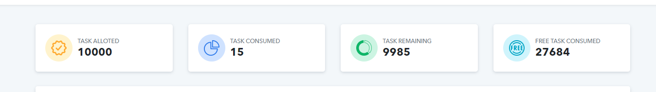

I modified the trigger but all my tasks were consumed the last time when this bug was still in place. I'm unable to test whether the trigger is working
Hey @axx
We have already reset your task in your account, please check that out and now you can try the trigger at your end.
