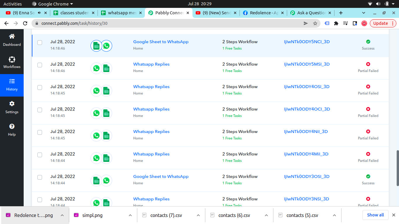

So I have 2 workflows:
1) Google Sheets to WhatsApp API (to send messages from google sheet to customers)
2) WhatsApp API Replies (to see their replies)
I executed the 1st worflow and got a LOT of partially failed tasks.
Can you help me with this?
Do I need to manually re-execute each task? IDK if that would work either!
Attaching the error message screenshots below.

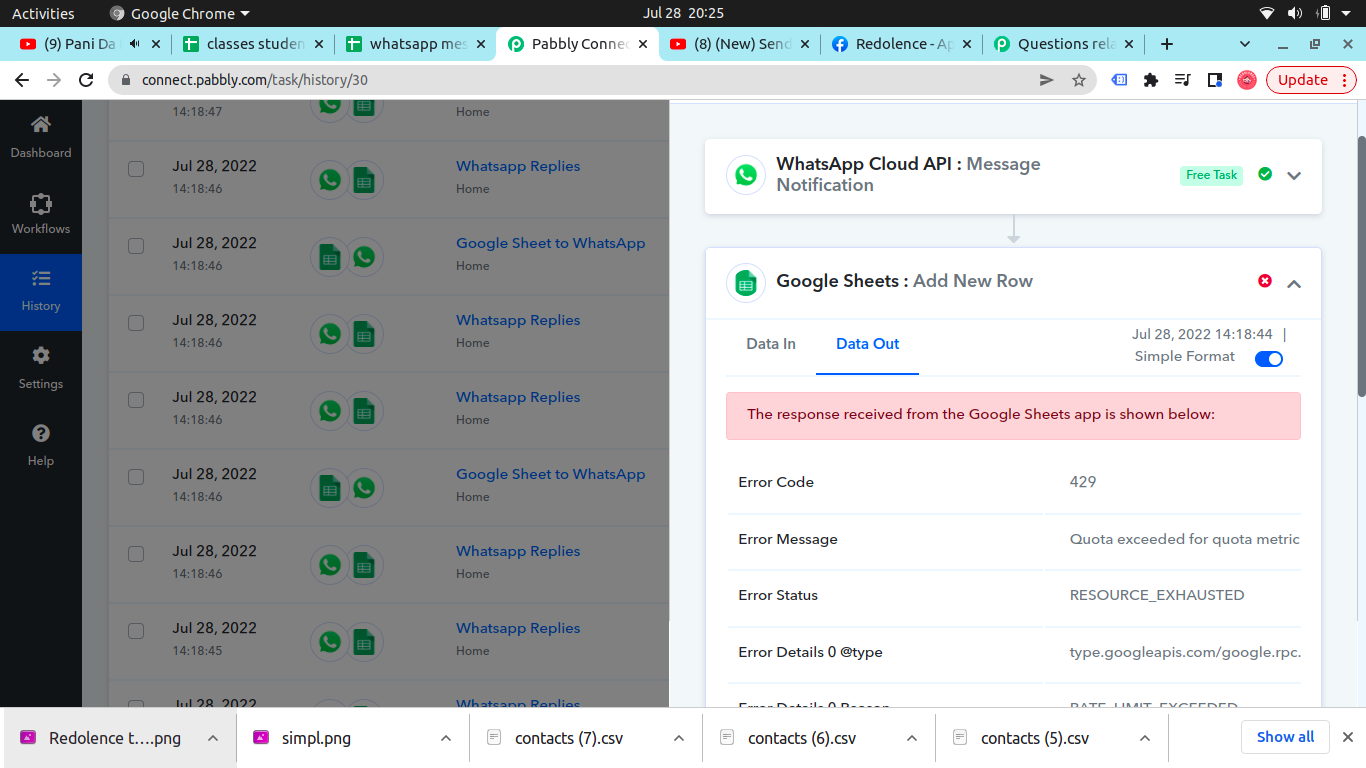

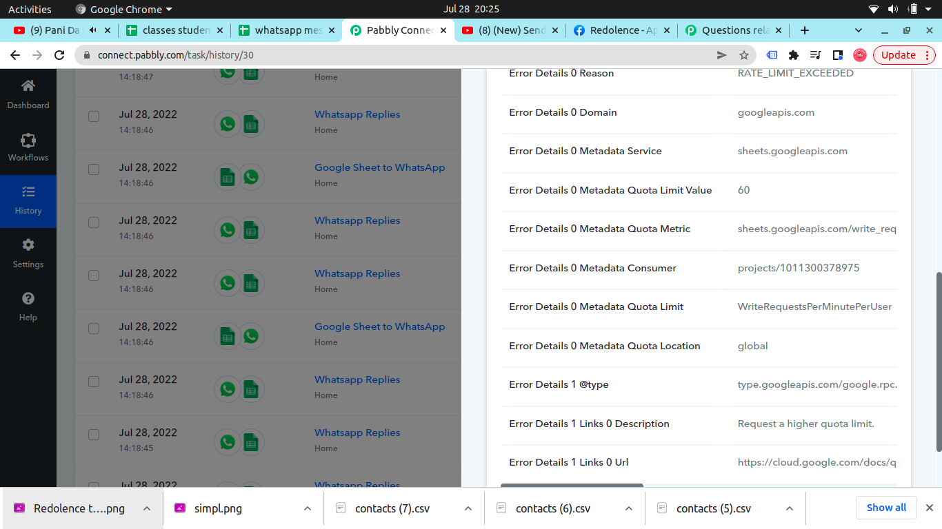

As we can see from your shown error, you have exhausted your rate limit to pass the request to write data per minute by "Google Sheets: Add New Rows".
Google API documentation for the error which you have got.
cloud.google.com
Errors | Cloud APIs | Google Cloud
cloud.google.com cloud.google.com
Moreover, you are also running the tasks in bulk and because of that, the error has occurred by the Google API. So, we should suggest you to use a delay action step to delay the task to run after 1 min after every update of value, in that way you wouldn't be exhausting your rate limit.
(Add this action step before the "Add New Row" action step)
Perhaps you should control the trigger response from your Cloud API trigger.
