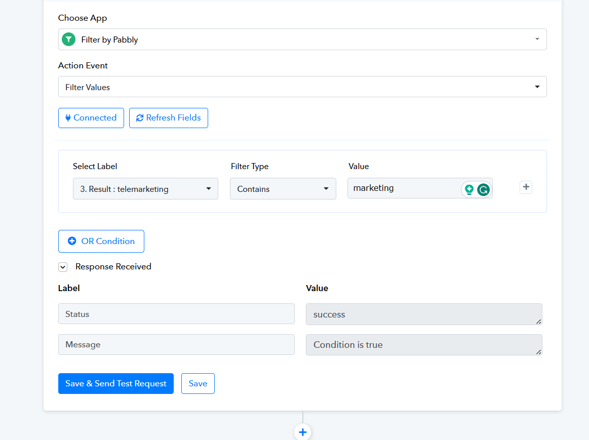

My filter is marked as contains and looks for the word "marketing". We just had something come through for "telemarketing" since that contains my filter, but I only want to look specifically for the word "marketing". I tried adding extra spaces before and after so it is " marketing " but that didn't seem to work.
What else can be done?
For context, we are evaluating a pargaph of text and I want it to pass if the word "marketing" exists in there, but not as part of a larger word. Thanks!

The text I want to filter would be a paragraph so for example "A telemarketing company called me". I only want it to pass if just the word "marketing" is in the paragraph, not when "marketing" is part of a larger word etc. So I want to filter for the word "marketing" and I would want "A telemarketing company called me" to fail but "I like marketing" to pass.
How would I do this?

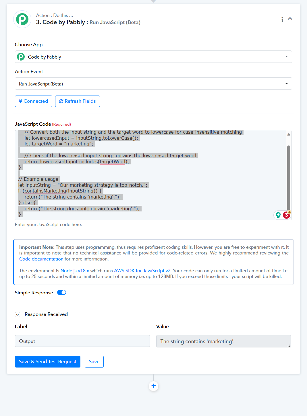

Regarding your concern, you can make use of the Code by Pabbly action step and identify the specific word from the given string.
function containsMarketing(inputString) { // Convert both the input string and the target word to lowercase for case-insensitive matching let lowercasedInput = inputString.toLowerCase(); let targetWord = "marketing"; // Check if the lowercased input string contains the lowercased target word return lowercasedInput.includes(targetWord); } // Example usage let inputString = "Our marketing strategy is top-notch."; if (containsMarketing(inputString)) { return("The string contains 'marketing'."); } else { return("The string does not contain 'marketing'."); }

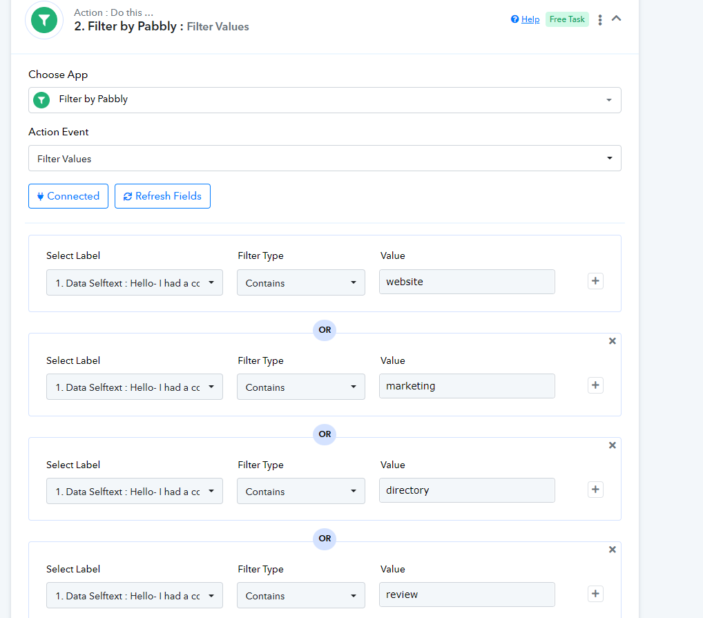

1. The filter I'm using is checking for multiple words - See attached image. B/c of this, I think I would need to get rid of this step and then add in a router step and each route would have a filter checking for each of my words, then I would run the content through the javascript you shared.
So my question is this: Is this the best / most efficient way to accomplish this?

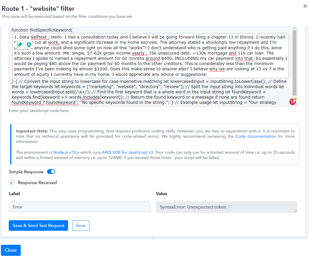

Question 2. I ran a paraph of text through the javascript you provided and it came back with an error b/c the text I input had quotes and other punctuation and so the javascript didn't like that since various things hadn't been properly escaped. I can have our dev take a look at this part of the issue, but I figured I would ask if there was a quick and easy way to fix this before sending it over to them.

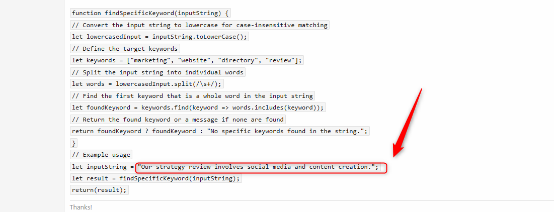

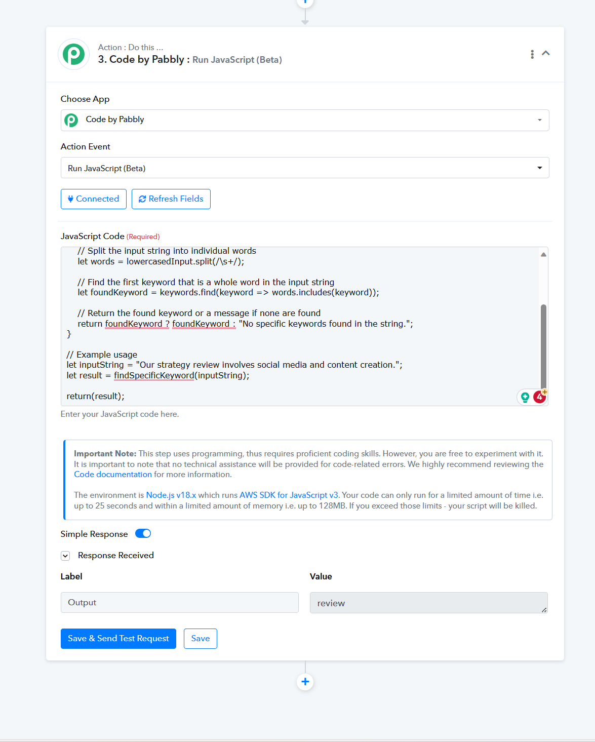

Thanks, I put in this code and it is not working, still running into the same syntax error issues - see image below.
You need to pass the content in the "let inputString" key of the code-

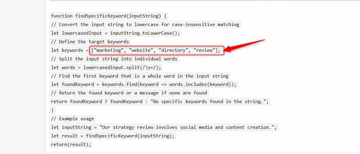

Ok thank you so much, this has been so helpful and I'm almost there. The only thing is the code you provided seems to only work for single words and not phrases and my apologies if I did not mention that before. Is it possible to have the same functionality we have been talking about but also have it work for "marketing person" as the phrase so it would only match if specifically "marketing person" was in the text, but not match if it was "telemarketing person" ?
You can add all the keywords you wanted to search in the given content -
