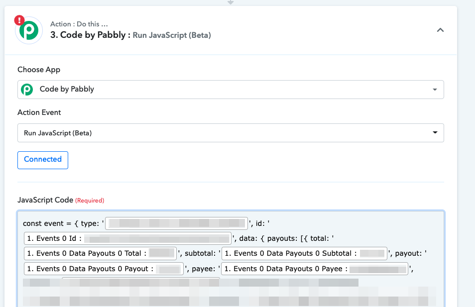

I have a workflow in which i'm capturing a request via a webhook and I'm looking to process that request using a Code by Pabbly action.
Is it possible to pass the raw post data to the Code step?
As a workaround I can manually recreate the post data using the fields from the webhook step, as seen in the screenshot.
But this is not feasible when dealing with an object with hundreds of fields.
Any suggestions?

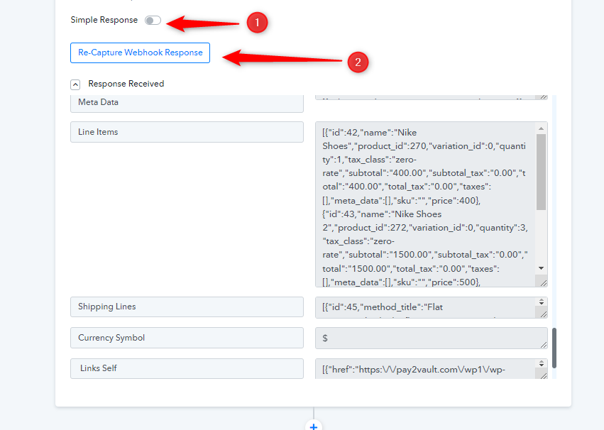

Regarding your concern, you can try capturing the webhook response in advance format by toggling the Simple Button and then recapturing the
date in that way your data will be in the JSON array format.
Sample -
This worked as expected. Thank you for your help!
