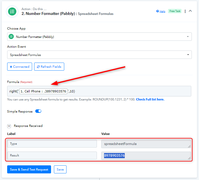

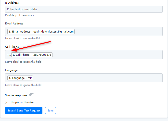

Hey @Nadica
You can use "Number Formatter" for this. You need to select "Spreadsheet Formulas" action step. Then it will respond with the 10 digit number. After that, you can add the country code in Vbout field before he phone number. Kindly refer to the image below for the further steps.

Hi, thank you for your answer. I don't think this will work for me because I have different phone numbers with different country codes. I ended up using concatenate ('+', right(phonenumber,len(phonenumber)-1) so I got what I needed in the end.
Thanks again!
