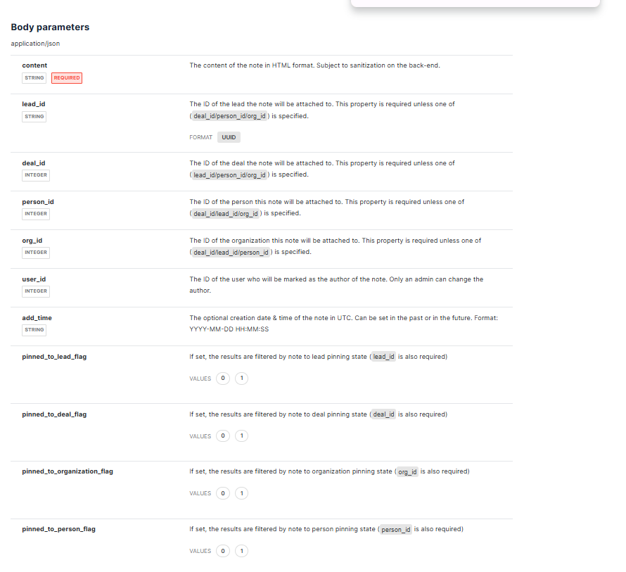

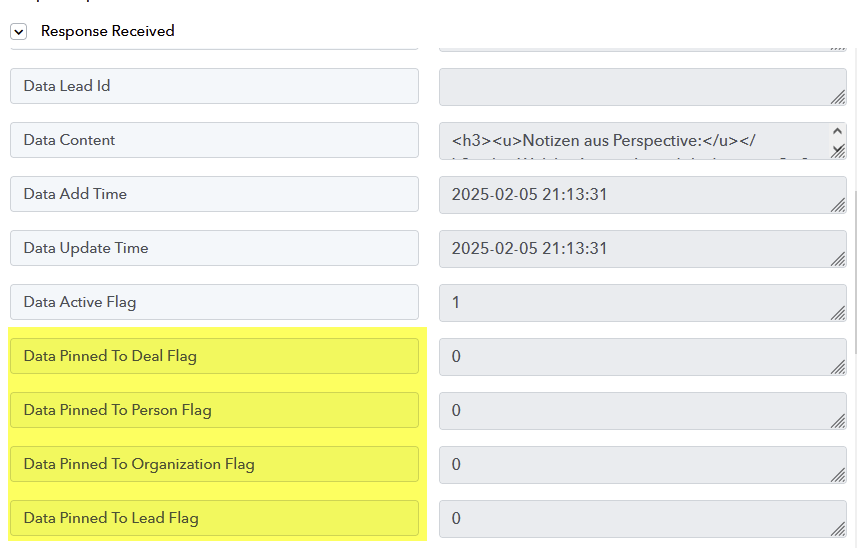

I can make the Note, thats working, BUT in zapier i can see the feature to pin this note to the deal, to a person, organization etc.
And these fields i get back also as answer from api (see screenshot below) but i can not select them in advance, so i have no chance to also get the note to customer except creating a new step to create the same note for person, but thats another extra step :/
Can you tell me if i am doing anything wrong or how can i fullfill the needs without wasting steps / tasks?

For the example above, as you can see there is - as example - the feedback from the Pipedrive API that lets me pin this note that i am about to connect to a deal also in one step to the respective contact , organization or even lead.
This is the functionality that i use already in Zapier for example to get this note also into customer itself.
I will check this more out if i miss any point here, but thats what i mean that is not fully accessible even it is there from the api.
