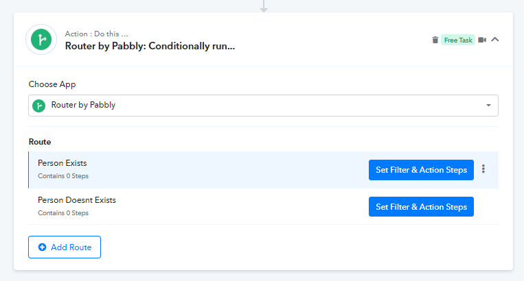

Hey @bkoessler
As we can see from the Pipedrive action steps to Find or Create a Person, if there is a person exists it shows the Id in different Res and if the person is now available the action event passes in different Res which is why the person Id got lost in some execution.
So, we would recommend you use the Router action step if the person exists and if the person doesn't exist you can set the individual route.

Hey @bkoessler
As per your use case, you would be needed to a separate route where you ought to pass the Res Id when a person exists and one where the Res Id doesn't exist.
