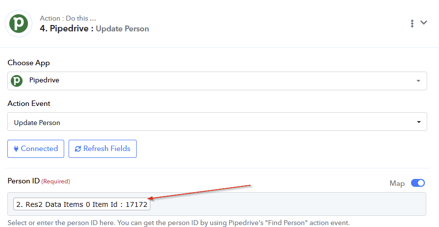

Hi there,
again to this workflow: IjU3NjYwNTZlMDYzMjA0MzY1MjY4NTUzZDUxMzUi_pc
i linked the Person from find / create step to update and to link deal to person, but it wont take it:
this is what i mapped and it runs on error.
Also, is the delay a paying step? Thought it is a free task.
Thanks for your help.
BR
Christian
In the 'Find or Create a Person' action step, you get two different labels associated with the Person ID—i.e., the label when a person is found is different from the one when a person is created. This breaks the mapping during automation.
Instead of using the 'Find or Create a Person' action step, we recommend adding 'Find Person' as the second step in your workflow. Afterward, add a Router to your workflow with two routes:
  • Route 1: Use this route to update the person using the 'Update Person' action event if the person already exists in your Pipedrive account. Then, add the remaining steps to create a deal and add a note to that deal.
  • Route 2: Use this route to add a person through the 'Create a Person' action step and add the rest of the steps.

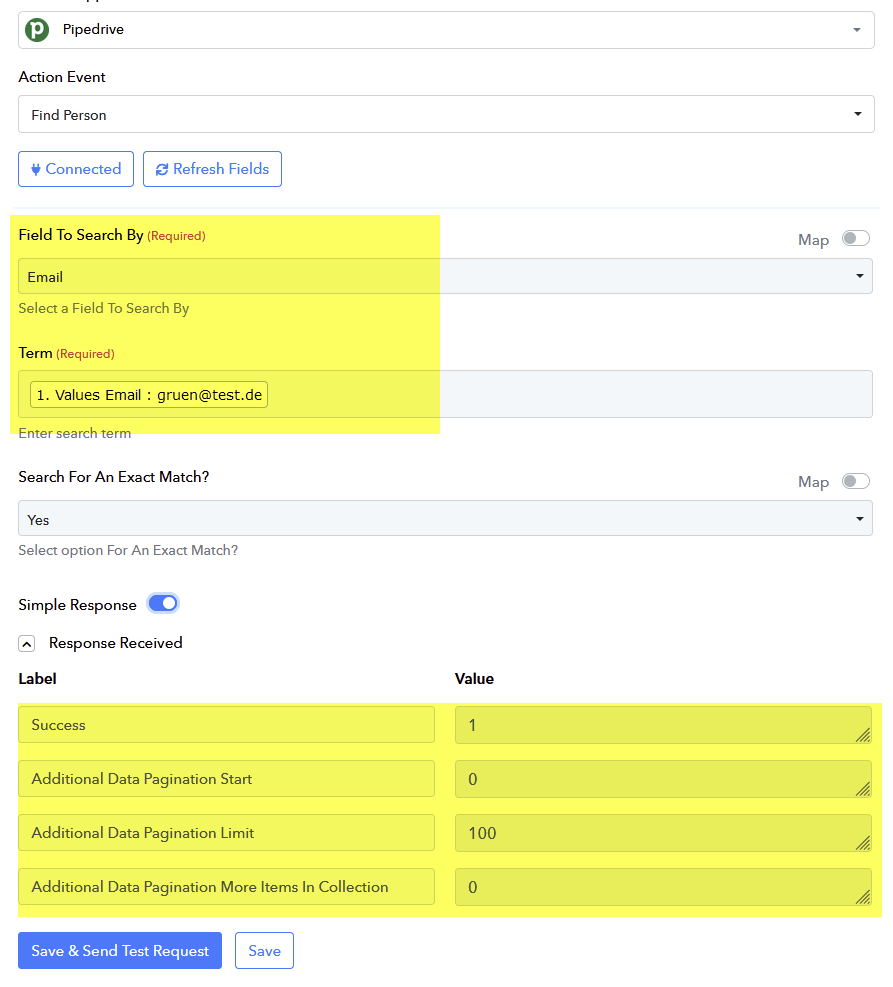

thank you for your feedback, will build it this way, but doing these steps i encounter the next issue. Which may be also data based but in this case i am not sure how to handle this as this might always be coming.
When i contact that is in Pipedrive but not active yet (might got deleted but is in temp state from the application for some time) the system tells us the contact was found but not handles us any data:
So in this case i could trace that the mentioned account is deleted but still in system, but the step reports it as success.
Do you have an advise how i can use the information to realize the contact is not active anymore in system and would be recreated accordingly?

Hello @Finspro,
Regarding the issue you're encountering, the Pipedrive API is structured to handle scenarios like this. When you search for a person and whether they don't exist or are in a temporary or deleted state, the API will return a response indicating that the person doesn't exist.

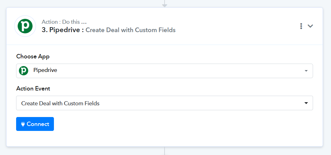

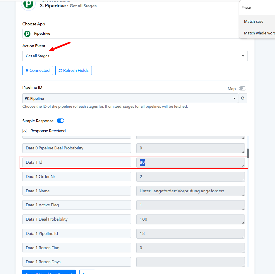

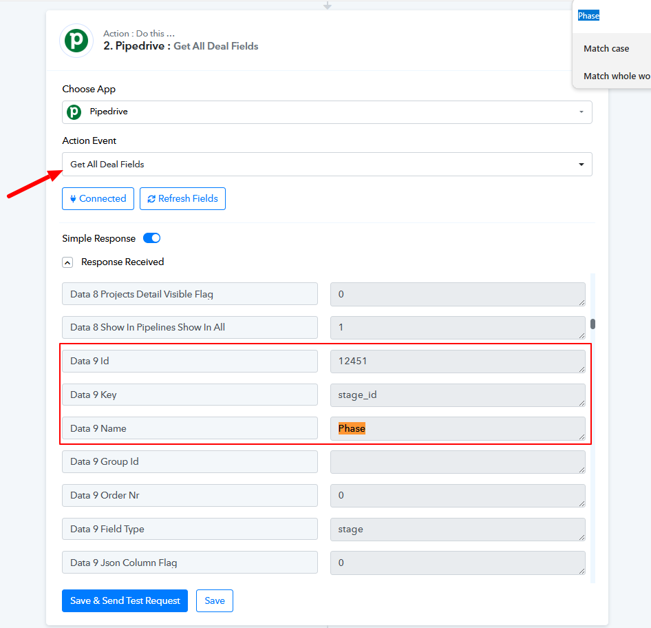

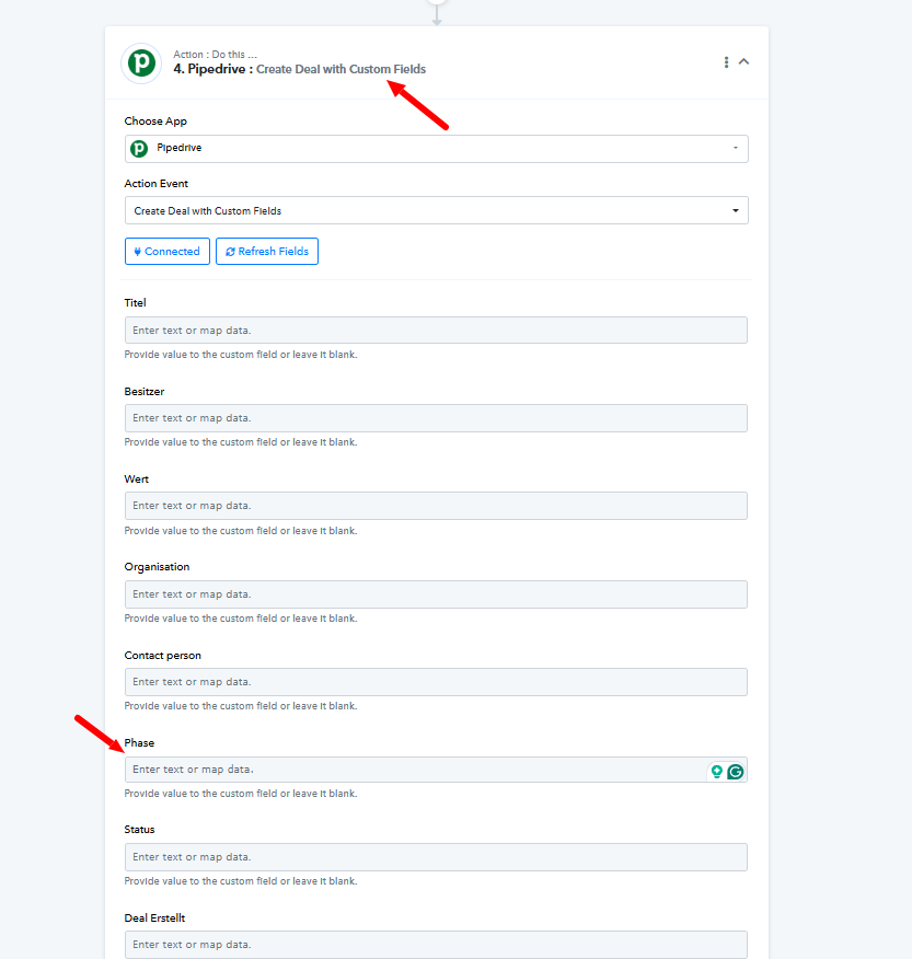

Hello @Finspro,
The parameter to enter the Pipeline ID is not provided by the API itself, which is why it cannot be included in the required action.
Upon reviewing the "Get All Deal Fields" action, we have observed that the Stage ID is associated with the "Phase" field. Therefore, you can add the Stage ID under the "Phase" field. You can retrieve the required Stage ID using the "Get All Stages" action.
Please refer to the attached images for further details. Let us know if you need any additional clarification.

Hello @Finspro,
If you only enter the Stage ID, it will still be added to Pipedrive, as the stage is interlinked with the pipeline in Pipedrive. Please try using the action without the Pipeline ID and let us know if it works fine for you.
